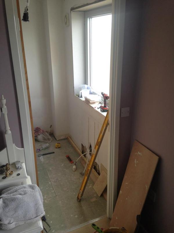

After ripping out the old "suite" & removing the stud wall dividing the shower and basin area...
The master bedroom was a mess (it's the next room to be sorted)...

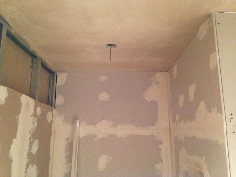

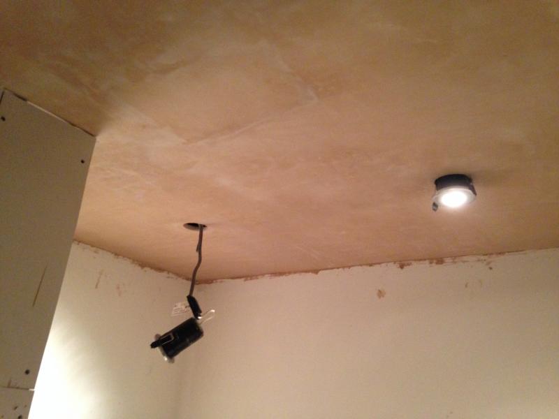

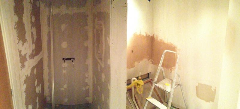

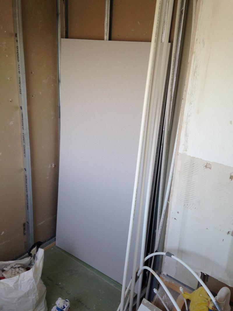

Re-Boarded the walls & plastered the ceiling...

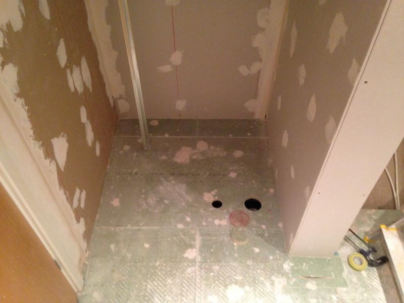

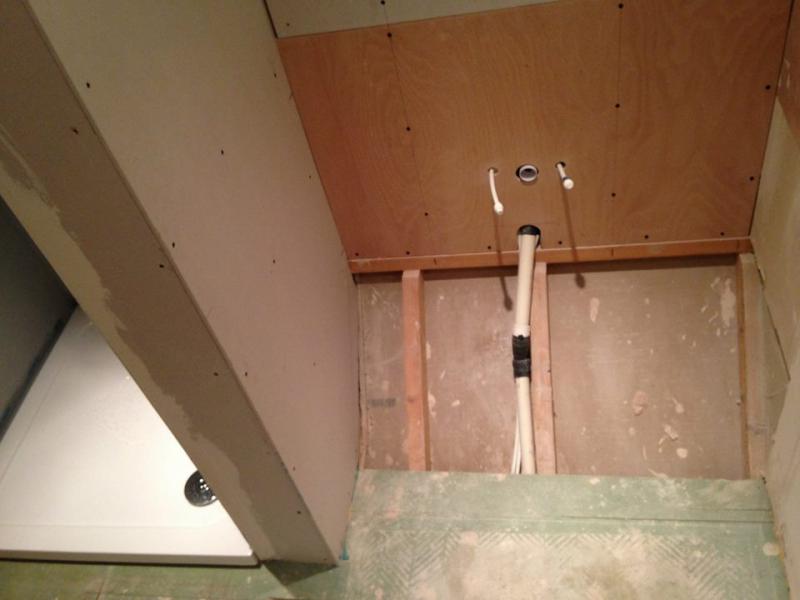

Re-routed plumbing for the shower:

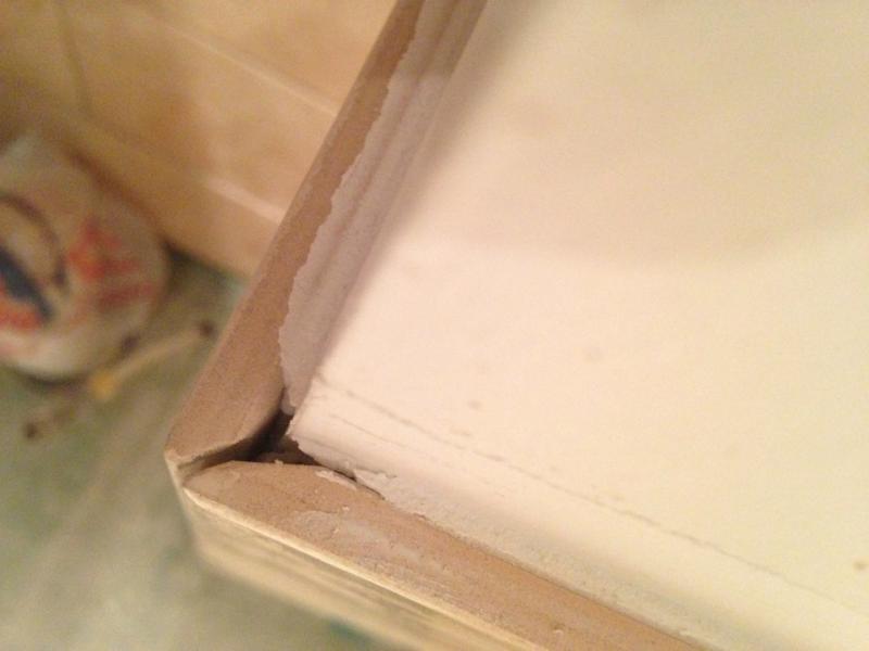

Fitted the shower tray (re-inforced the flooring by installing new joists under tray area & bedded tray - using a 5:1 mortar mix - on top of ply board).

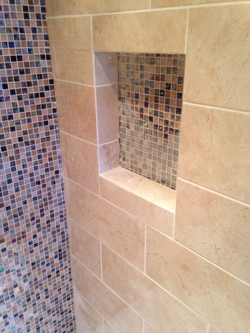

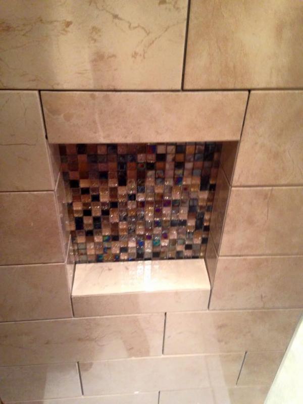

Added a small shelf into the stud wall to avoid having to use a metal hanging "thing" to hold shampoo's etc...

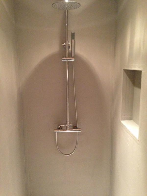

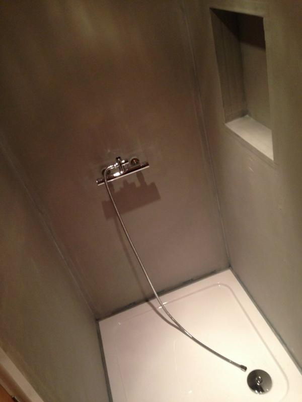

Quick test fit of the shower:

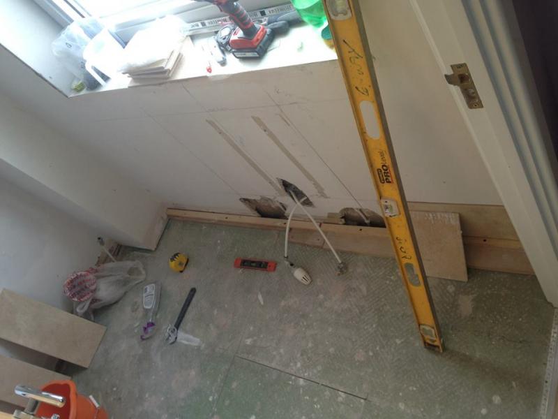

Re-routed the plumbing for the basin and boarded with ply as I'm going to use a floating sink unit that hangs from the wall so ply is far stronger for holding it solid...

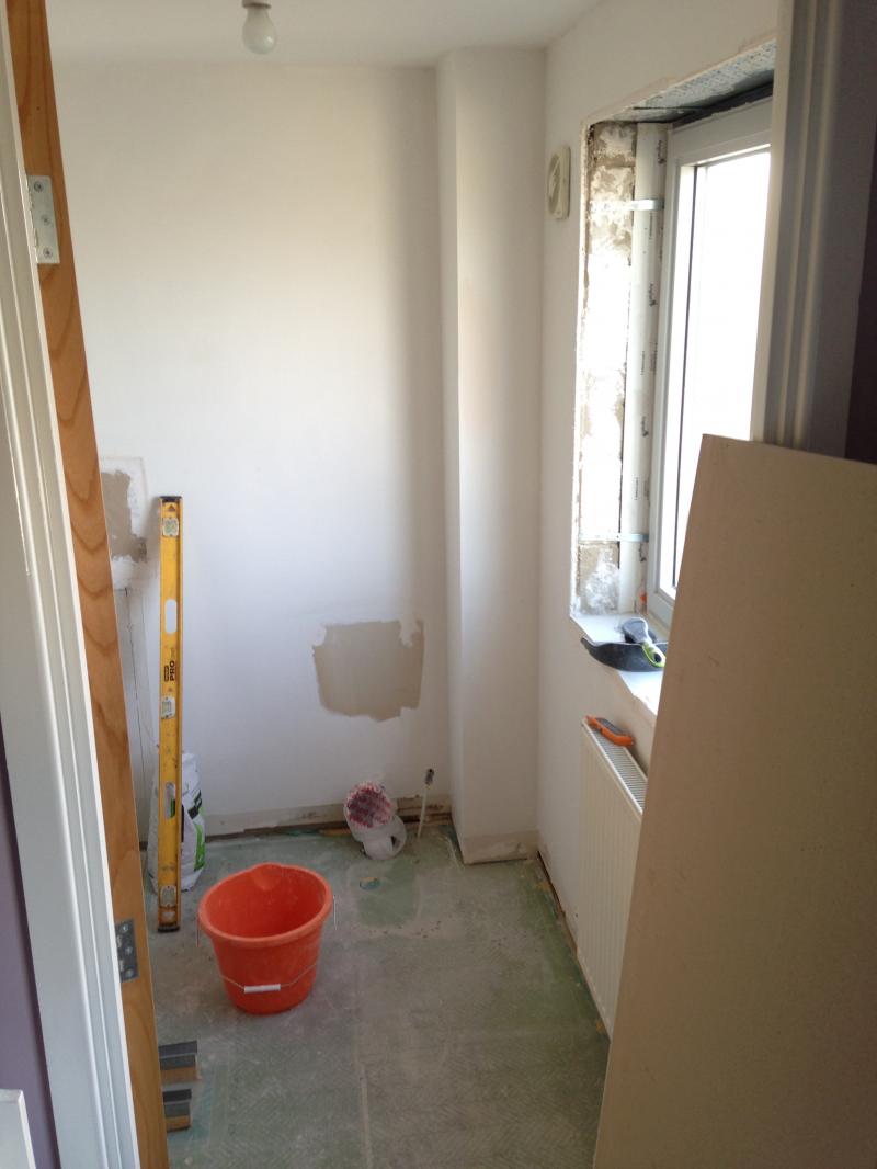

Getting the room prepared for tiling; had to remove the radiator and free the heating pipes as I'm replacing this with a heated towel rail...

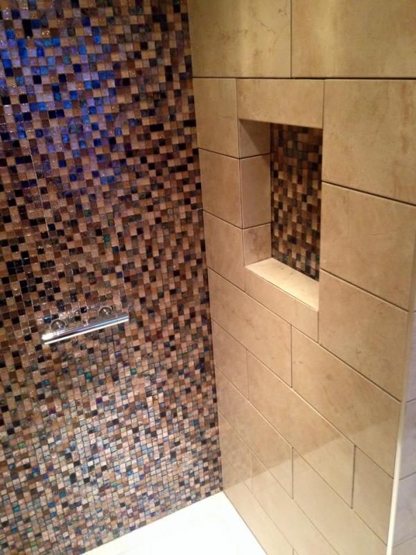

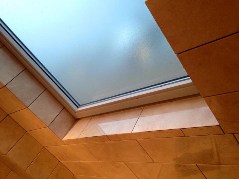

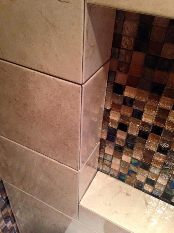

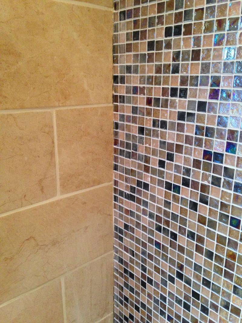

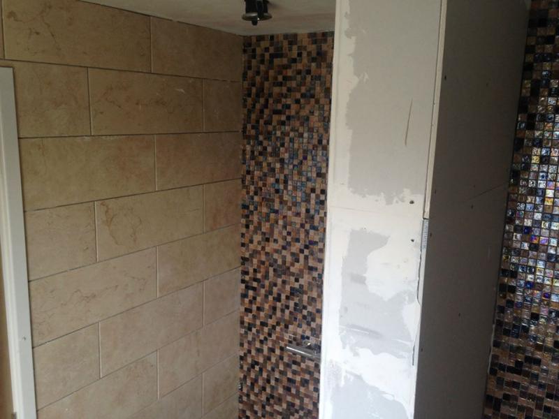

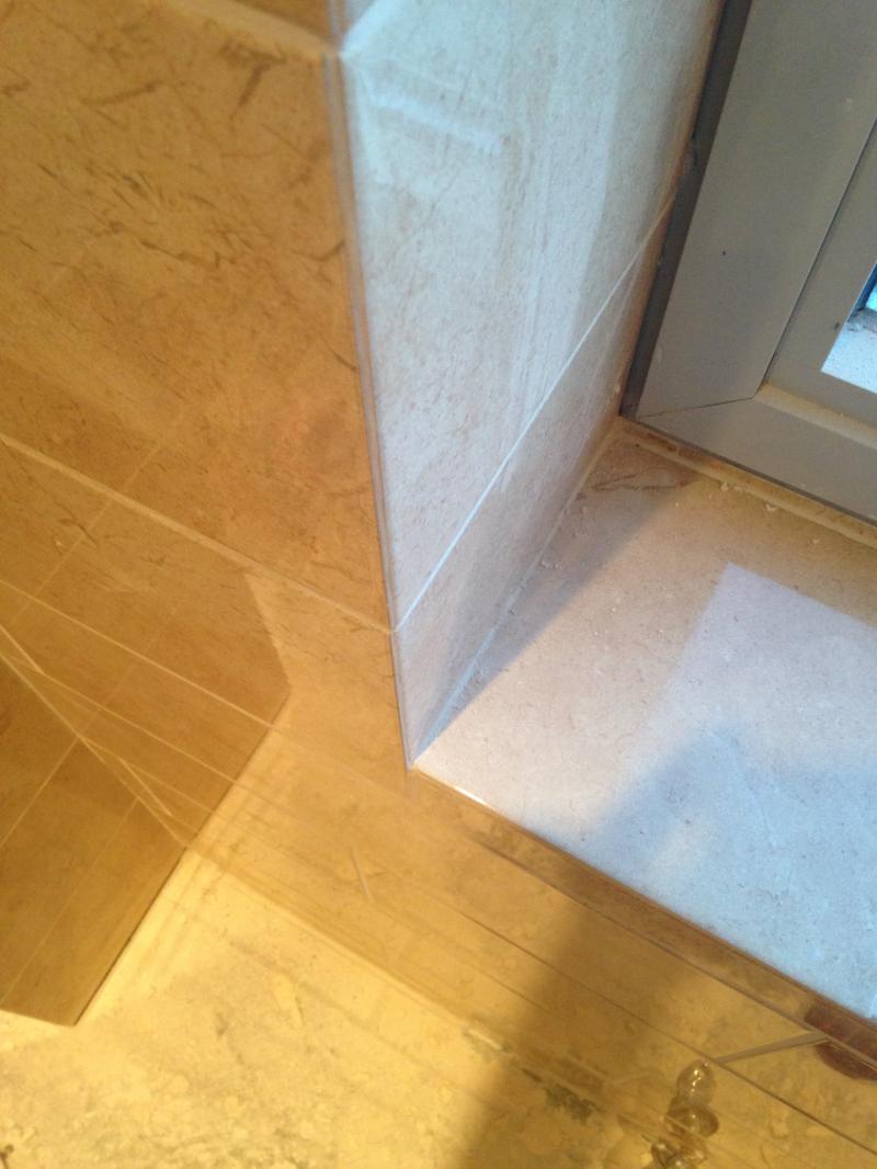

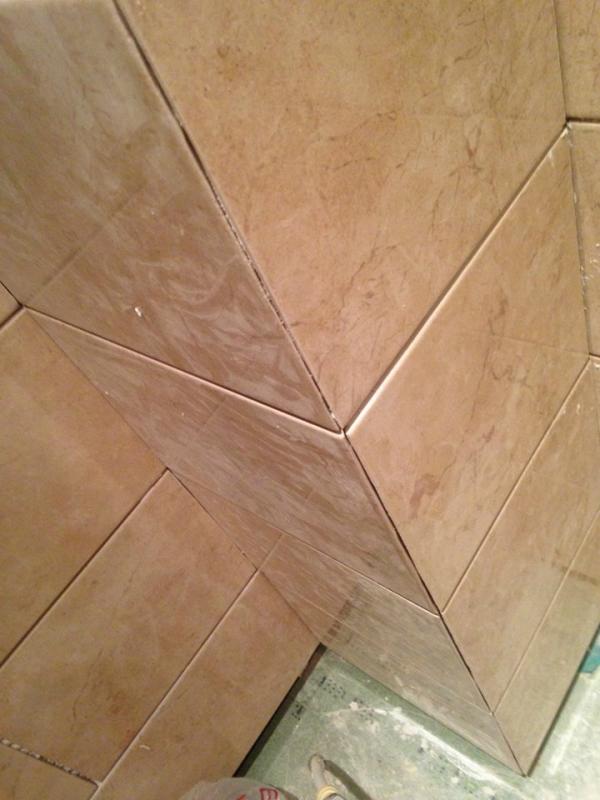

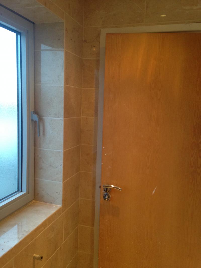

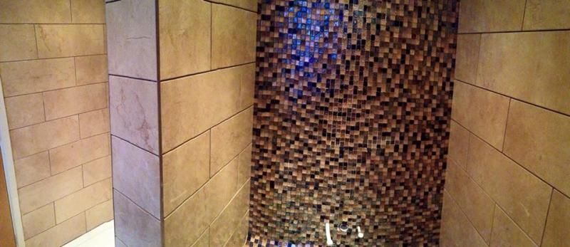

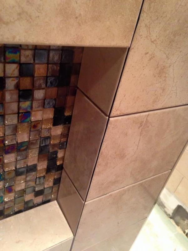

Decided to mitre cut my way round the 90degree angles avoiding tile trims:

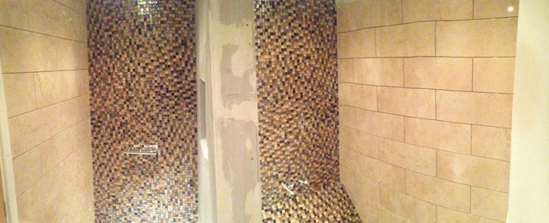

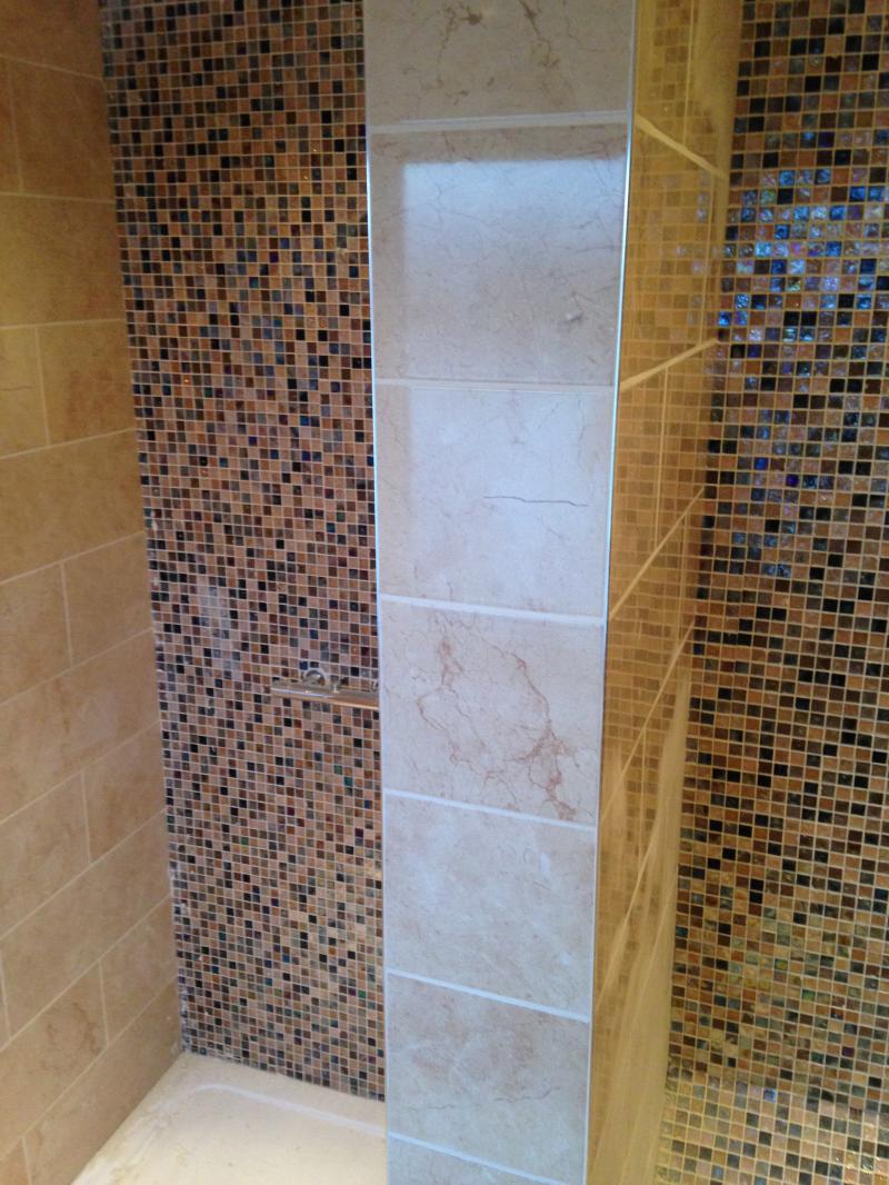

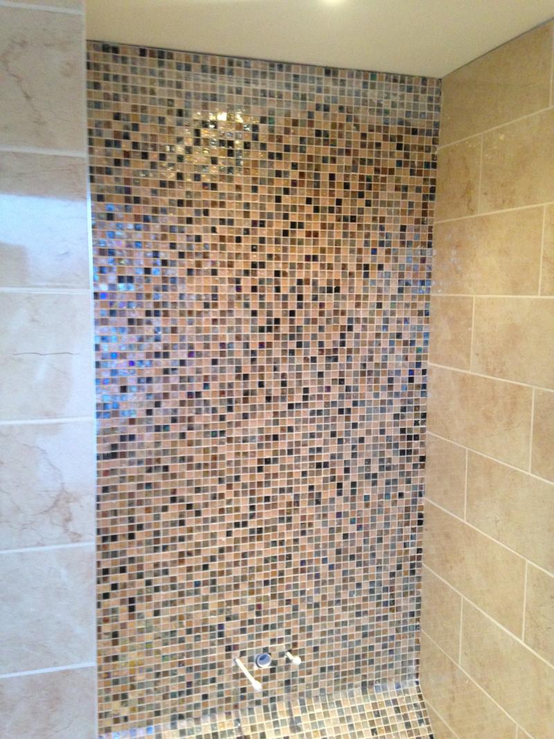

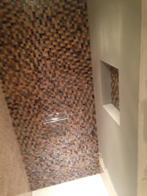

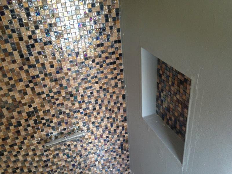

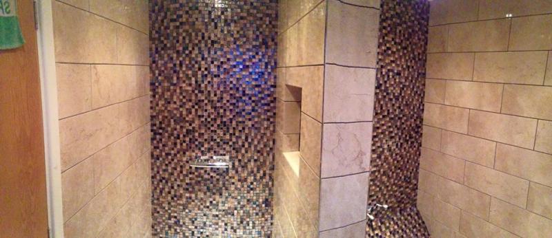

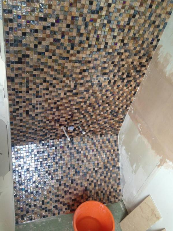

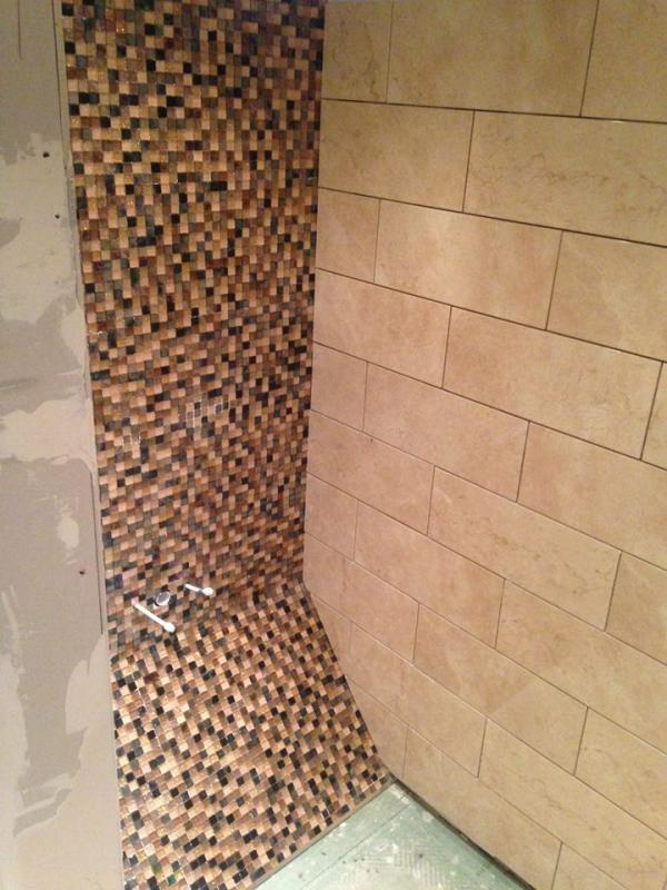

Fitted mosaics to the back of shower wall, shower shelf wall & behind the basin....

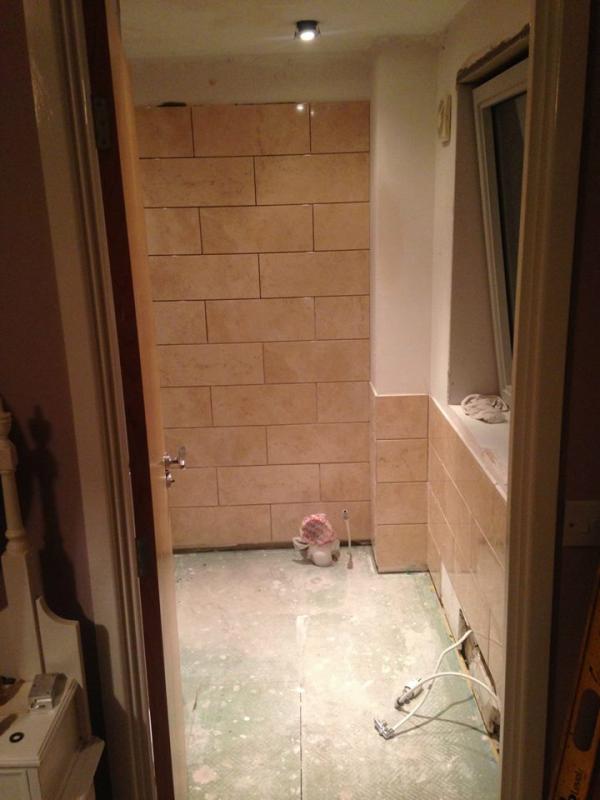

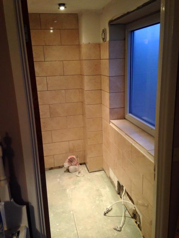

Started tiling the other walls...
Need to finish the tiling.... will update next week.
