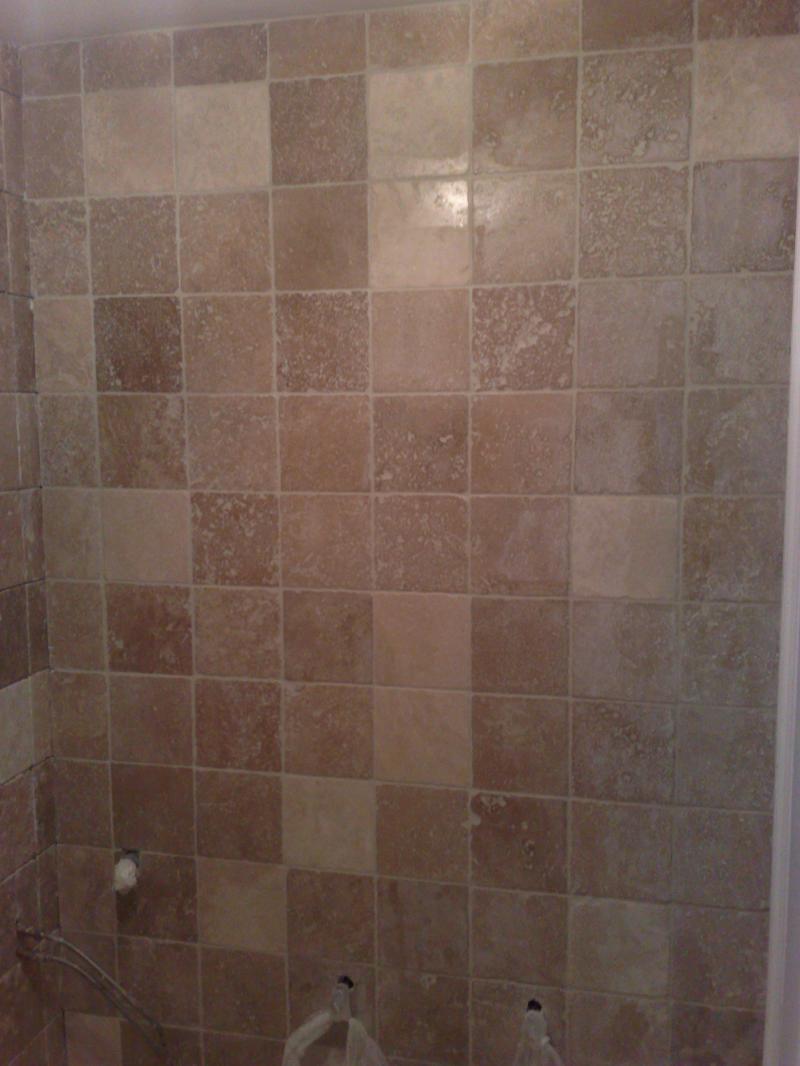

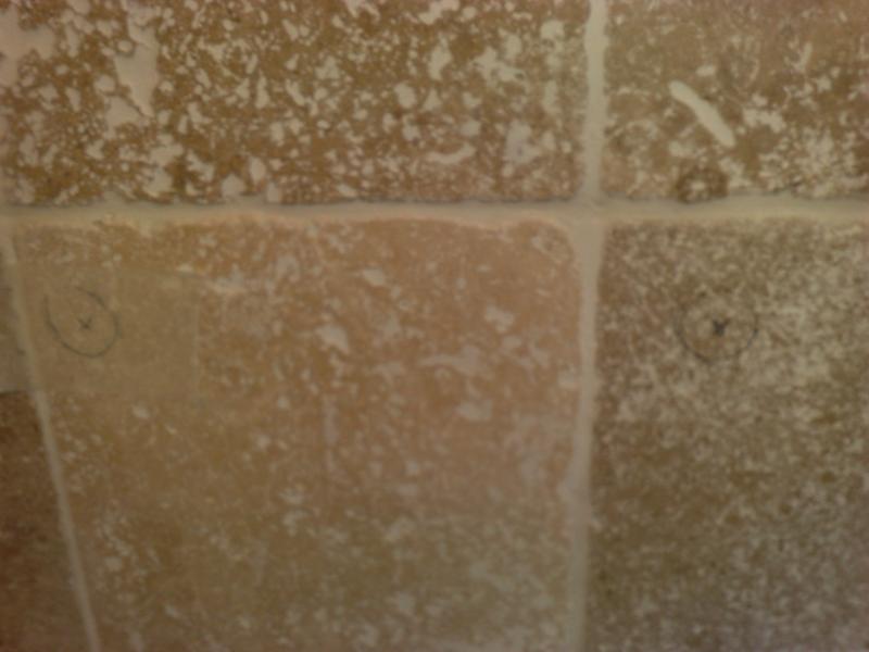

Well, I now officially hate grouting natural stone tiles. :mad:
One wall done, took nearly two hours to do one small wall!!! wtf?
Anyway, comparing the two, grouted and ungrouted:-
Think I do prefer it grouted actually. :LOL:
Just 3 more to do so it's going to take longer again than expected. I'm off for a take away now and a couple of shandies.
:cool:

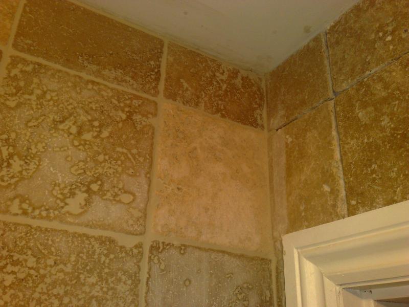

Today I managed to get another wall and a half done, but, I had to go to the shop to get some more grout. I purchased my goods, went home, used the first bag of grout and all went well, using my new grout float, then I opened the second larger bag, it being a 10kg over the smaller 3.5kg (cheaper way of buying the required amount) I started to mix it and hey presto, I noticed it's green tinge. It's limestone, NOT IVORY!!! AAAARRRRGGGGGHHHHHHH!
What a waste of my day!
Going to take it back tomorrow and see if they'll swap it, so instead of being fully grouted today, I have a wall and a bit to do yet. can't start my floor!!
Just not what I need.
Monday: Grout changed, walls finished! Starting on the floor tomorrow!
Final stretch??

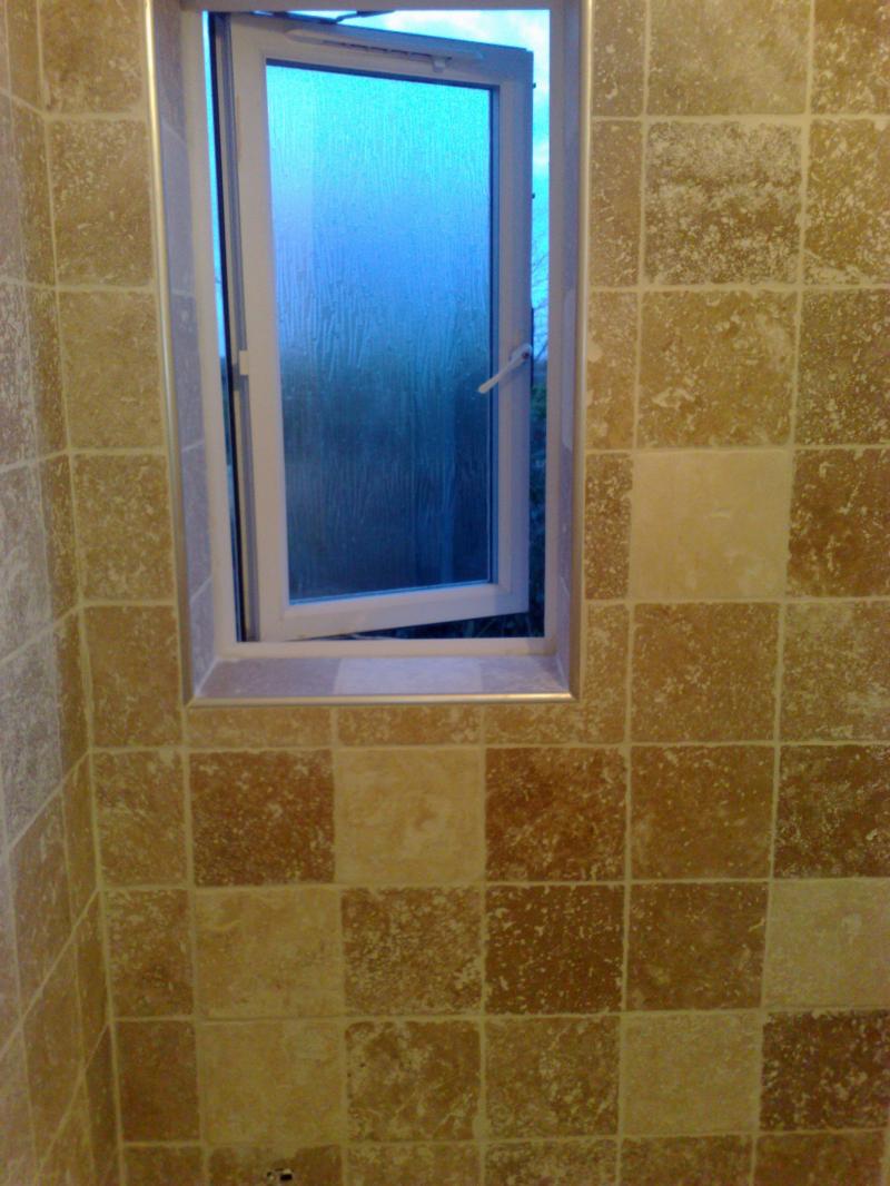

Walls done! Just need to be sealed but going to do this once the floor tiles are all down and grouted, ready to seal at the same time.
As you can see i've just laid the floor tiles out where the shower area is to get some idea about what tiles need cutting.
The room isn't square so I can't do anything about the tiles not matching up on one wall. I'm doing my best though.
Hoping to get shower area tiled tomorrow and underfloor heating in place.
Never enough hours in the day!!

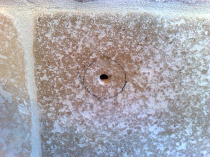

I had to chain drilled and and then filed a cirlce for a shower control talk about patience. Also learnt how to throw half tiles down the garden quite well that day!!!! :evil:

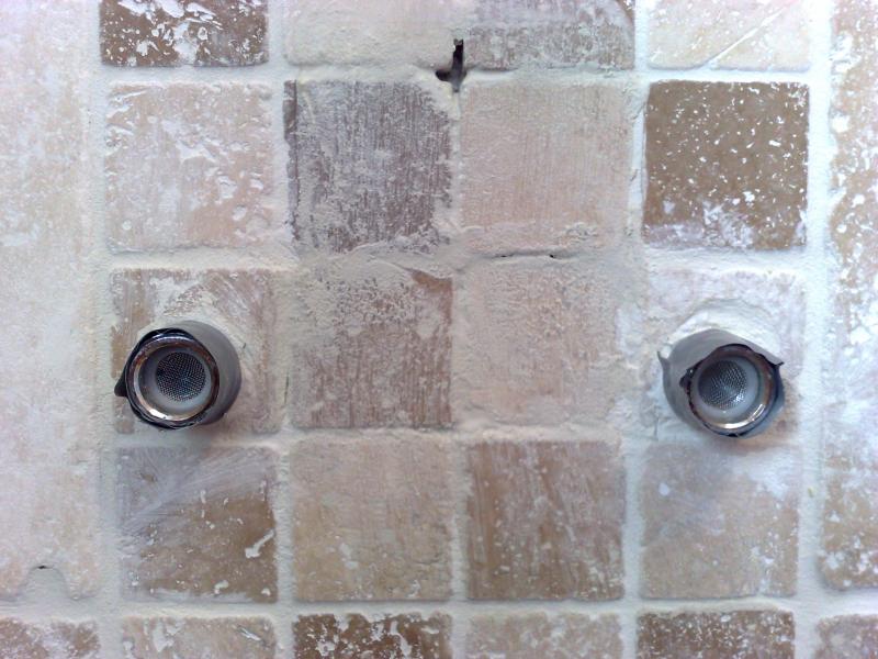

Bit late now - also curious how you are going to isloate your shower fitting, as your isolation valves are [or were] facing the small wet room rather than the other bathroom.

Isolating the shower fitting is a doddle. I turn off the main house stop cock. Open the downstairs taps and hey presto, I can take the shower fitting off. As the isolating valves were going to be enclosed in the stud wall anyway, I wasn't too bothered about access and isolation, as our main bathroom is on the other side of that wall and I intend doing a similar project in there too, when I can be bothered. I can adjust, re-jig the pipework once I start that side.
I'll take some close up pics of the shower fitting pipes once I tidy that area up. Haven't quite got that done yet but I have small chrome covers to cover any mistakes. :evil:

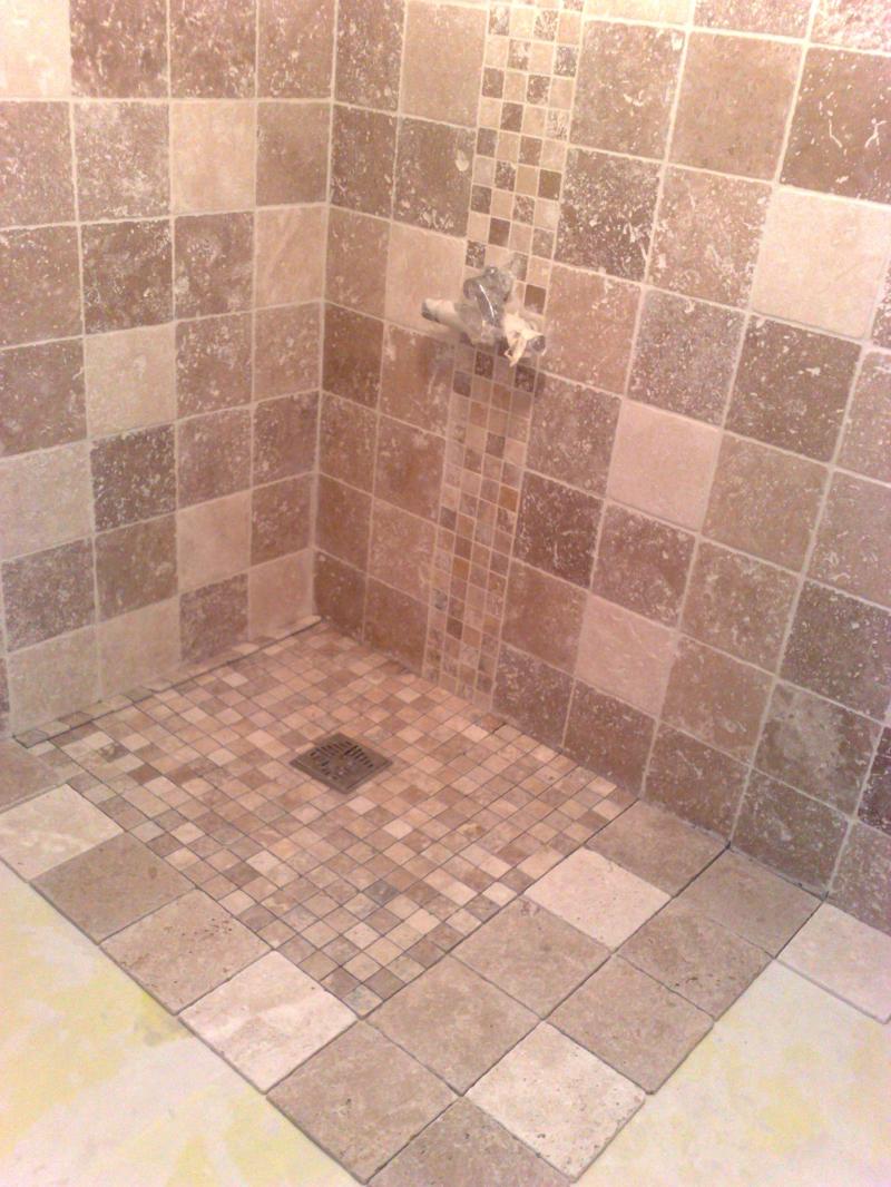

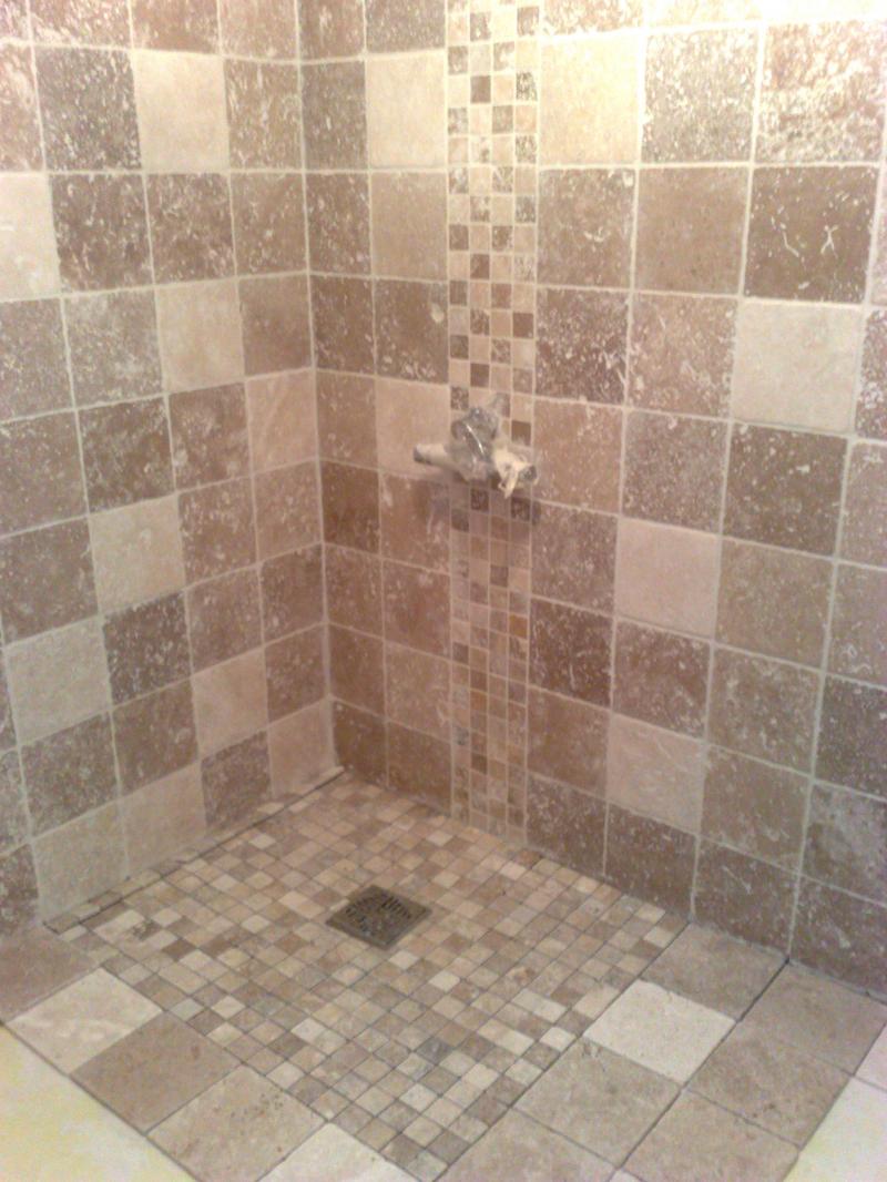

Friday morning. I've managed to get the underfloor heating down all of the floor tiles down so far this week. Today I plan to get the floor grouted, the shower mixer fitted neatly and grout finished off around the window surround. Also plan on giving the whole room another coat of impregnator and then attempting drilling some of these tiles, hoping to fit the towel rail and possibly even the sink and shower head. Doubt i'll get that much done but i'll try.
Pics will follow. I'll do a short video too I think as you cant see the whole room from one picture as it's too small.
Well today was a long and busy day!!
Here's a before pic of the shower pipes poking their little noses out of the wall.

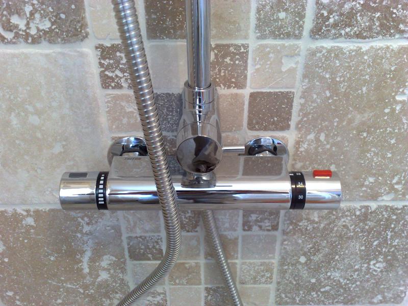

and finished:-
And the holes marked for the towel rail:-
Do you realise how easy it was to drill all of the holes today??

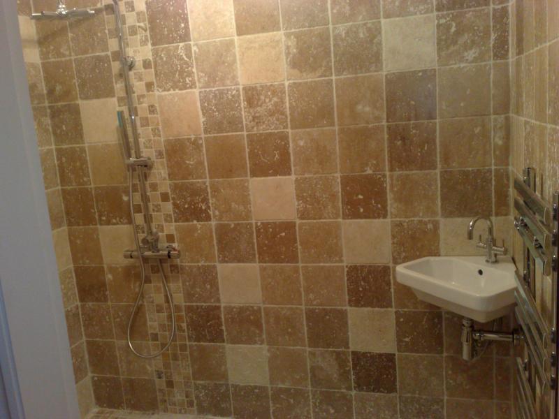

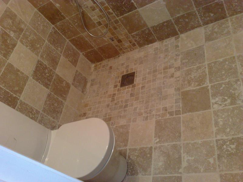

And a couple of virtually finished pics. The sink leaks at the drain (don't they all??) :mad:

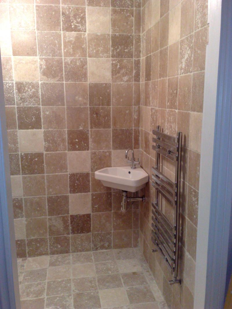

The sink and towel rail:-

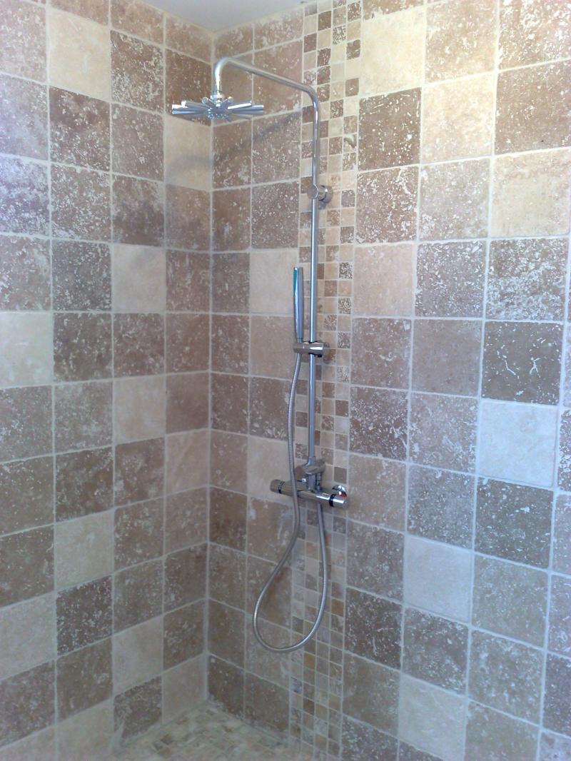

and shower:-

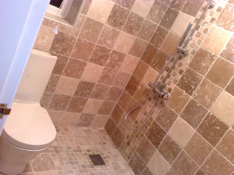

Ok, so nearly finished. The sink needs a bit of attention along with the water pipes connecting up to the towel rail.
The soft closing toilet seat has arrived with the wrong fittings! :(
The toilet is still to plumb in. The floor still needs cleaning and sealing a couple of times.
There is still the corner mirror cabinet to fit above the sink but that's about it.

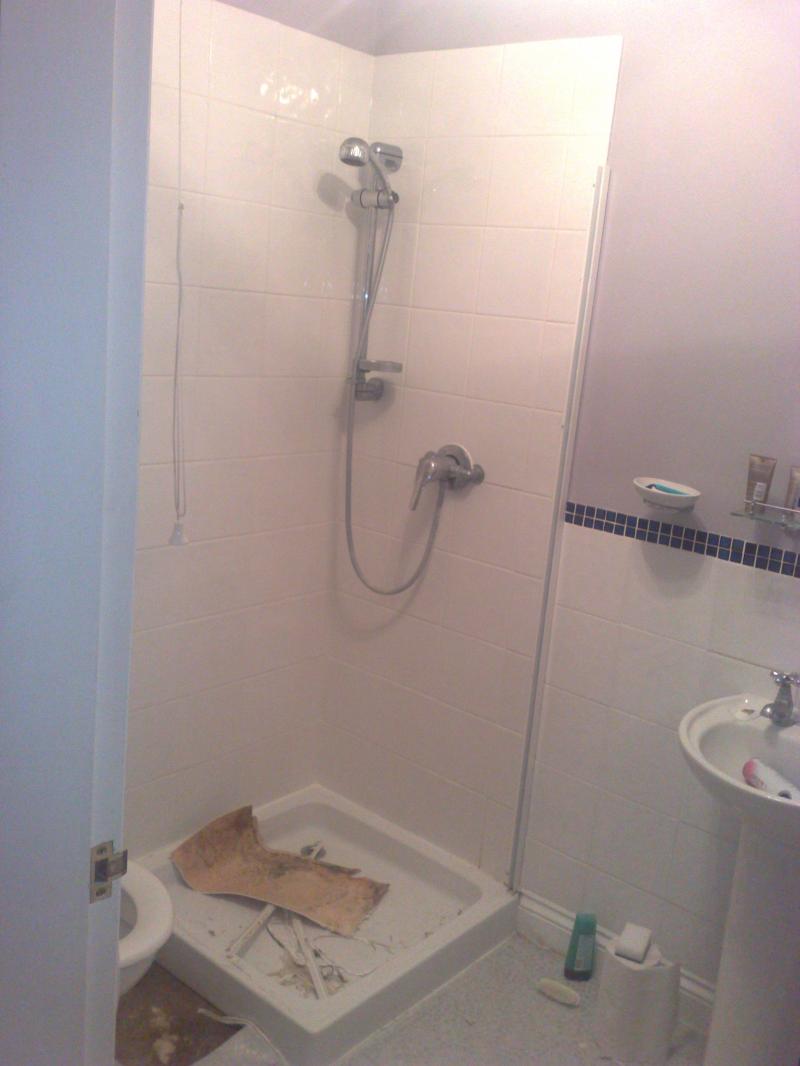

It's come a long way since this:-
