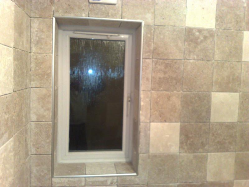

Ok, so the walls are now all tiled save for a tiny strip behind the door. I have the window recess to do but I need the mitre and a new hacksaw blade for cutting it neatly. (yeh right) I suppose I could always just chew the edging strip off at 45 degrees??

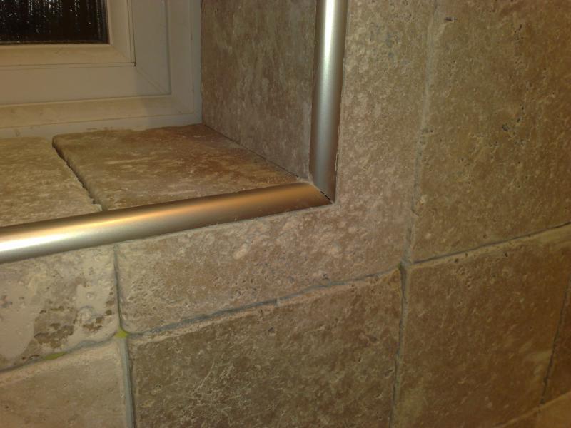

Got the edging strip in place. £12+ per piece, and guess what, I cut it wrong the first time (don't know what I was thinking, and yes, it's now too short in two places!! Anyway, just going to live with it as it's only the en-suite, had it been main bathroom, i'd have had to buy more.!!

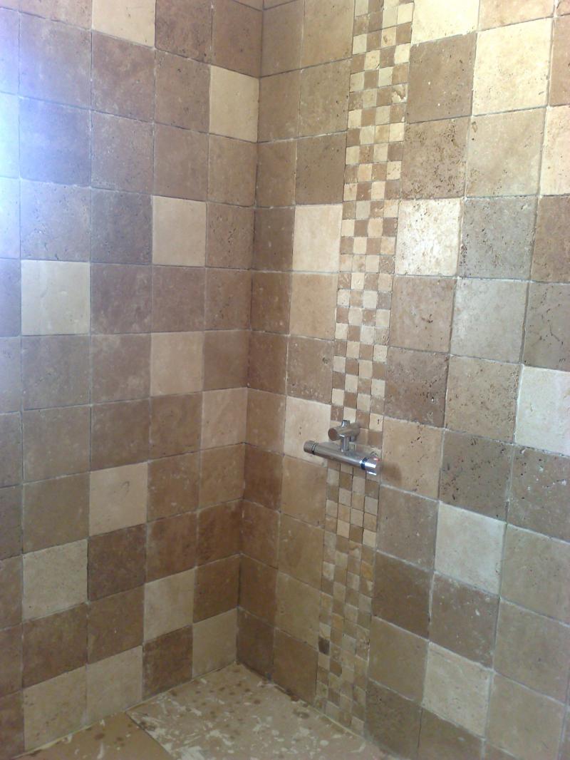

I plan on cleaning the tiles tomorrow morning before work, couple of hours should do it, then on saturday, get to do the first of two or three seal coats. I'll take photos of the grouting process, just going to use a rubber squeegee and coat the whole tile, filling the gaps fully to help waterproof them, then seal again, probably twice. No doubt another fortune spent on sealer.

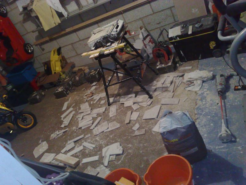

Actually, I should post a pic of my garage!! Now that would be funny after the last two days!
Oh, what the hell:-
and no, it's not an explosion in a tile factory! :D

Lovely colour co-ordination on the window edge. Is there drying time between each sealant coat? Just think how much children learn from watching someone with a strong work ethic!

I'm using HG Impregnator for the sealant, although technically it isn't a sealant. After applying one coat, you can wait about 2 hours and apply another. Then within about 4 hours after that it should be dry. It smells very strong for some time afterwards (a petroleum type smell) but I can live with it.
I can then grout over the tiles but i'll wait until tomorrow. Then I plan on giving one more coat of Impregnator.

Another window pic:-

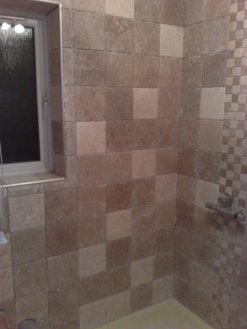

Just sealed the tiles and feel a bit high!! That Impregnator stuff is Bl**dy strong stuff!! Hic!
It doesn't really change the colour of the tiles much.
How much sealant do you think you'll use for what sq m?

About to start some grouting tonight. I just can't sit around watching TV all night.
Gives me an excuse to have a well earned beer after I finish each wall. Pity I wasn't doing an octagonal room!!!!
Results and pics to follow! Just hope they turn out too blurred, LOL
