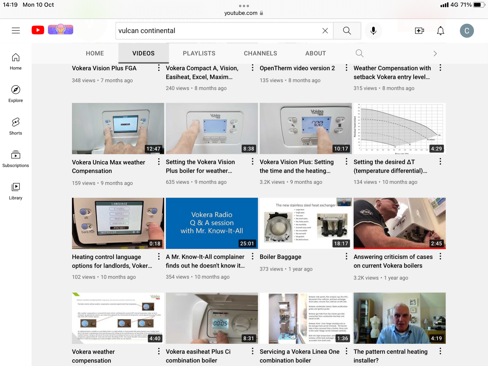

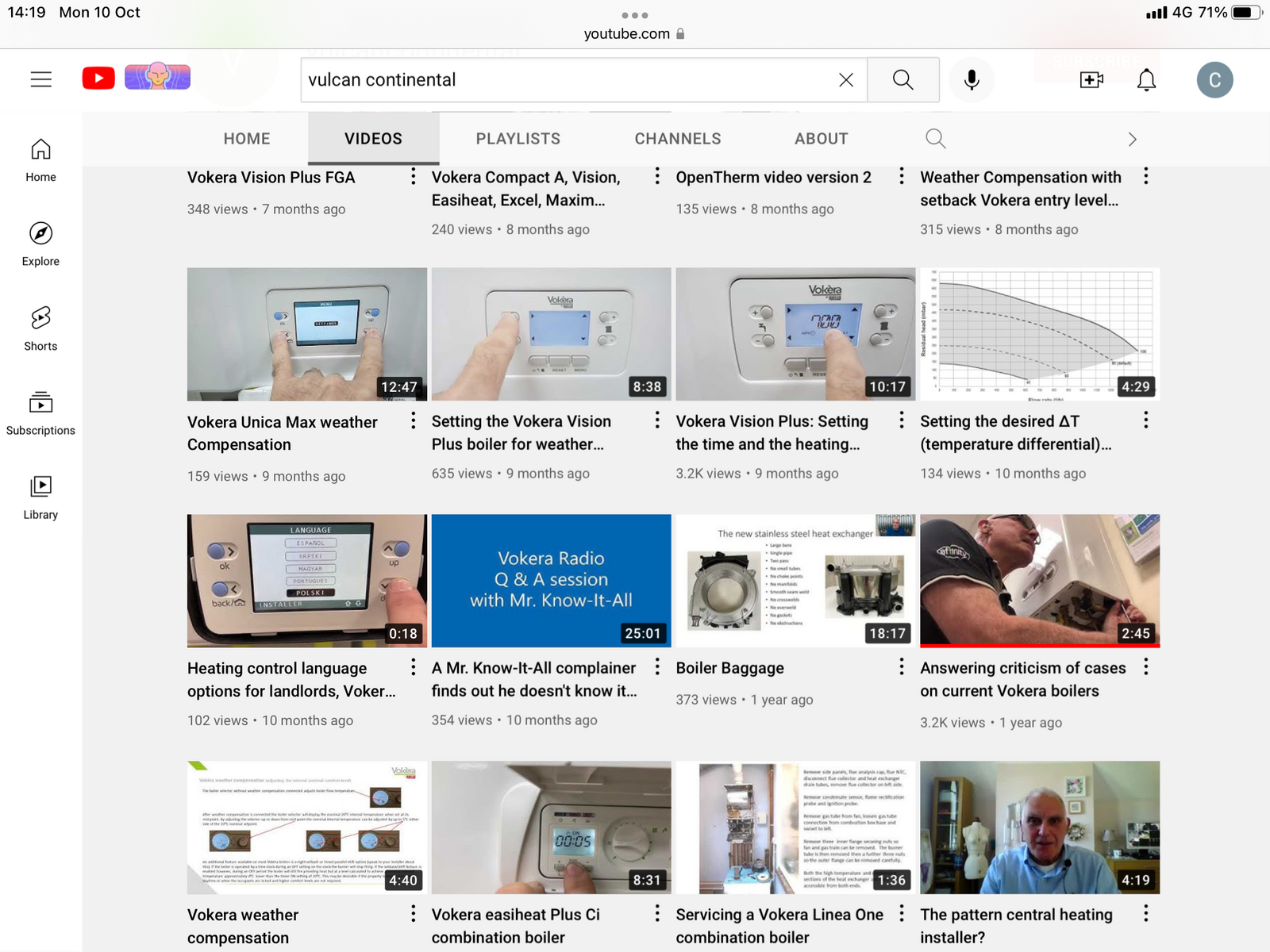

@vulcancontinental ... looking to find these vids you mention - I can only find one under your name titled -
Answering criticism of cases on current Vokera boilers​
Is that you in the vid? I'm interested to see the implementation.

I do the videos in my own time but in our training rooms. They’re not of a quality good enough for the company so I post them in my account, vulcancontinental. A search for that or the name Vokera in the title will list them.

Thanks for that, cant seem to find any re OT control etc though with your name or vokera , must be the way I am searching.
When you have searched for VC, then click the name, then videos on the tab, should end up with something like this:
