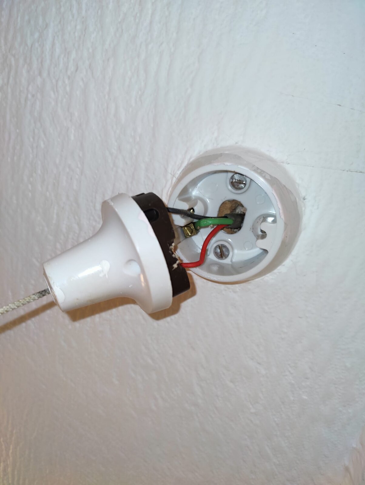

removing a bathroom light pull switch
Pictures not very clear as to what wires go where...
But, yes - Sunray is correct - all three switches appear to be wired as 2-ways.
Yes all 3 are wired as 2 way
Assuming the red and black are one T&E and it is a spare switch position and it goes up into the same space (Loft?) as the existing pull switch wiring then we have a solution but identifying the cables in the loft may not be so easy...
In fact attempting to identify the cables in the loft by tracing them is probably the next step and who knows OP may even discover what the centre switch is supposed to be for.

What's the wiring look like in the bathroom pull switch?
Simple stuff then.
Once you have discovered if that middle switch is available for use.
Is it live? Do you have any voltage test equipment?
I have no idea what the middle one is wired to. Will probably have to call the sparky round for this one.
