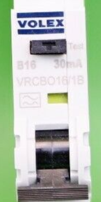

Hi Guys.
I’ve got a 12 way Volex 17th Edition split consumer unit that currently has 4 MCB no RCD (for electrical heating) and 5 MCB with RCD protection for lights, immersion, Oven / Hob, Final Ring, & radial socket.
There’s a guy on ebay selling New Old stock Volex RCBOS’ of the right type (RCBO function AC & pulsing DC, MCB function – Type B: https://bit.ly/2PRx1m6 ) & ratings, so I was considering replacing the current set of MCB’ with RCBO’s.
I have a Fluke 1653B multifunction tester so would perform continuity, IR and trip time / current testing before and after the replacement, and will source a torque screwdriver to ensure everything is done up correctly.
Is there anything else I should be considering ? Aside from updating the labeling when done.
M.
I think the type AC doesn't have the dc pulsing function.
Blup
That brand are type A rcd for DC.
Often ppl don’t like Rcd for heating, as you can get false trips.
I think they are.
it's hard to make out from the photos on ebay, but when i zoom in, they do look like type A to me:
I'll bear in mind the possibility for nuisance tripping on heating circuits and keep hold of the exsting MCB's just in case. At the moment, i have cheapo convection heaters fitted but intend to replace them with some nicer electric - wet style heaters in due course. Guess that explains why the spark who fitted my consumer unit way back when split those circuits off from the RCD.
That said, I have come across some manufacturers of radiator elements who specify the use RCBO's.
