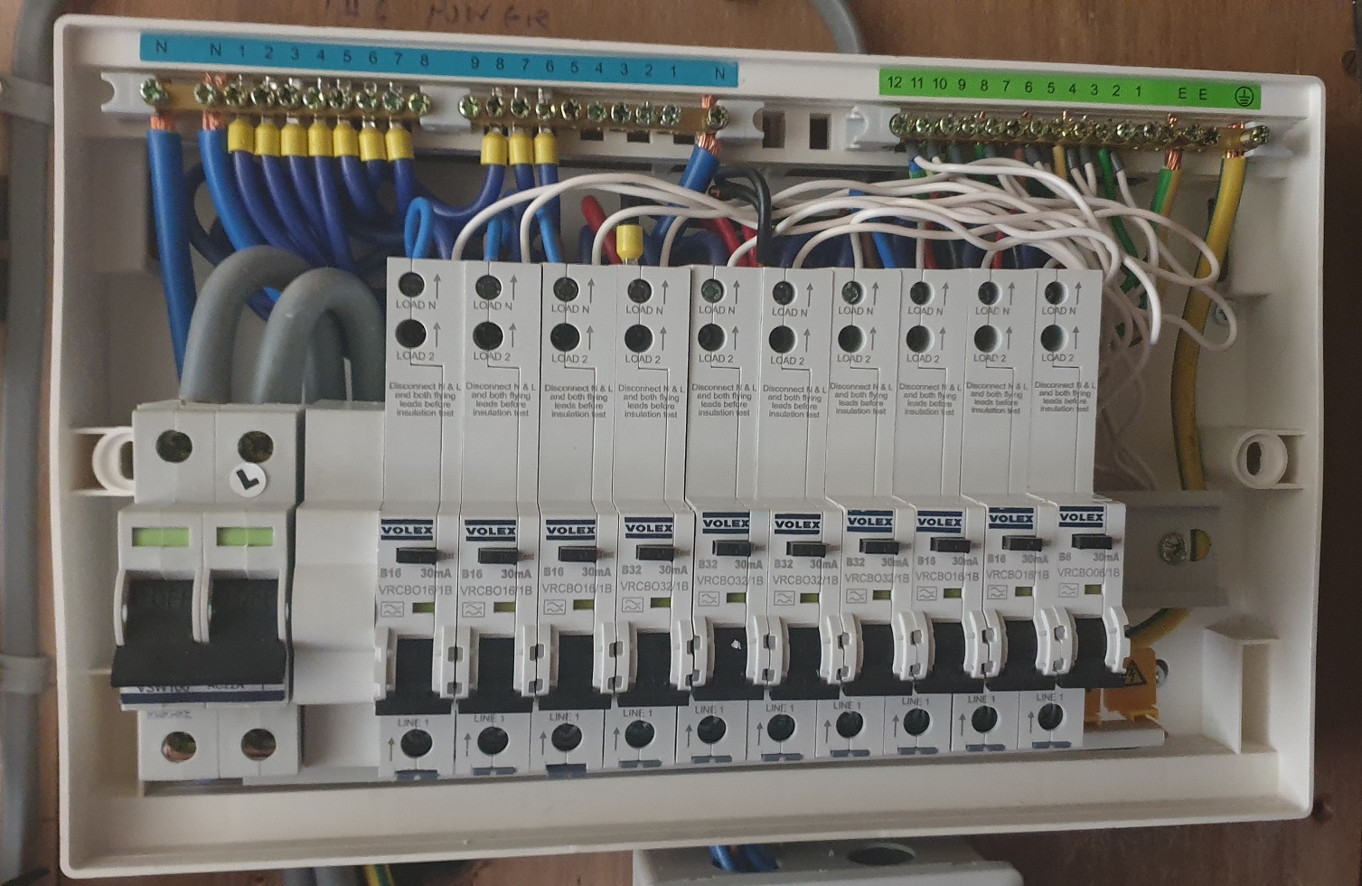

Replace MCB with RCBO's

Well, it took me most of an afternoon and into the early evening, but i got it done. Surprisingly hardwork getting it all to fit. Not helped by the CU being quite shallow in depth, and there not being a lot of space behind the RCBO's once fitted - hence having to run the functional earths over the top. Not ideal, but it works. I know theres some debate about using bootlate crimps, but i love them - makes terminating multi core wires so much easier. Aesthetically, i like the yellow on blue too.
Whilst i was doing it i thought i might as well put in another couple of 32A's whilst i can get hold of them - gives me the option of running in a second cooker line and a kitchen ring when i replace the kitchen. Taking out the double width RCD means i could always potentially add more later too - though tbh its getting so busy in there that at that point i think it will be new CU time
Have you noticed the CU getting warmer? I was looking into RCBOs but one of the concerns I noted was that the parasitic current draw is much higher - up to 5W per RCBO.
when i took the cover off yesterday to do some more testing / tidying up i did notice some of the 32A RCBO's felt warm. Don't really have any sense of what the MCB's were like so i can't say if this is warmer or not. When i get a moment I'll take the lid off again and grab a thermal image - got one of those thermal camera add ons for my phone a while back. Can't say that my electrical monitoring system has picked up an increase in the base load of my flat - certainly nothing in the region of 50W (5W per RCBO). If anything, my base load seems to have dropped - but that's probably because i didn't plug something back in...
Interestingly though, this spec sheet from Wylex says the current draw is comparable to the MCBs.
Although the RCBOs are switching both poles so could have twice the draw in real service?
