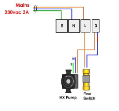

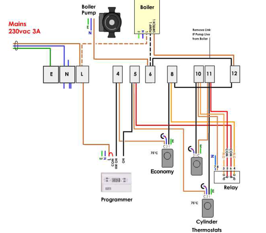

This was the way we did much the same with a simple thermal store. Didn't have the predictive bit - which is pure marketing hype for gullible pillocks.
Add this:
And hey presto - hot water.
You make me larf again. How crude. A simple latching relay and another cylinder thermostat to operate in summer? The programmer. Is 'ON' for space heating? It is confusing around the time switching.
You have no using the heating pump as a shunt to get more energy into the cylinder.
No predictive logic to minimise the boiler switching in.
You do not hold off the heating to a fast reheat for hot water.
No LED to see the temperatures of the sensors.
No individual control of the heating and hot water.
The hot water pump is not variable speed so will pump at maximum speed hot water into the bottom of the cylinder destroying stratification.
You do not show the heating side, or heating pump or an expensive and troublesome 3-way valve.
The user has to know the settings on the thermostats.
So you will have:
1. An expensive mechanical blending valve.
2. An expensive mechanical/electric flow switch.
3. THREE expensive rod type thermostats.
4. THREE expensive thermostat pockets in the cylinder.
5. A relay.
6. A wiring box.
7. An ugly round cylinder while the Systemate has a neat highly insulated box with controls behind a door.
All that is very expensive to what the Systemate has
