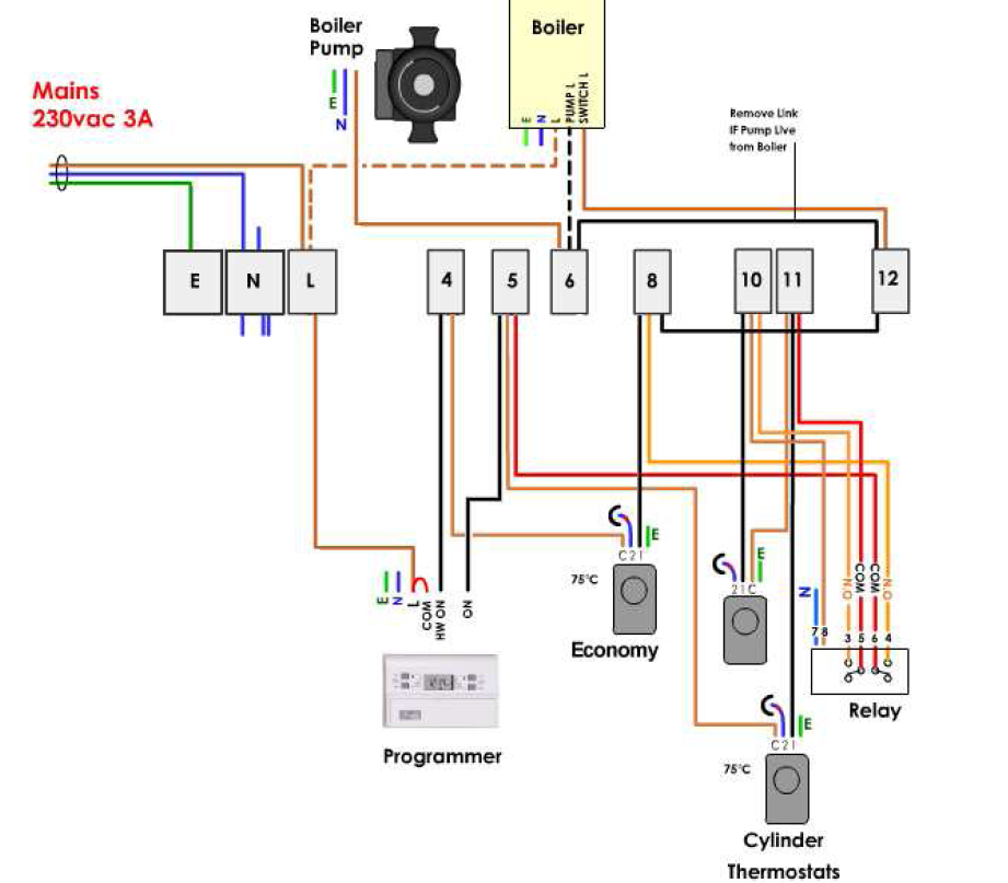

This was the way we did much the same with a simple thermal store. Didn't have the predictive bit - which is pure marketing hype for gullible pillocks.
Add this:
And hey presto - hot water.
