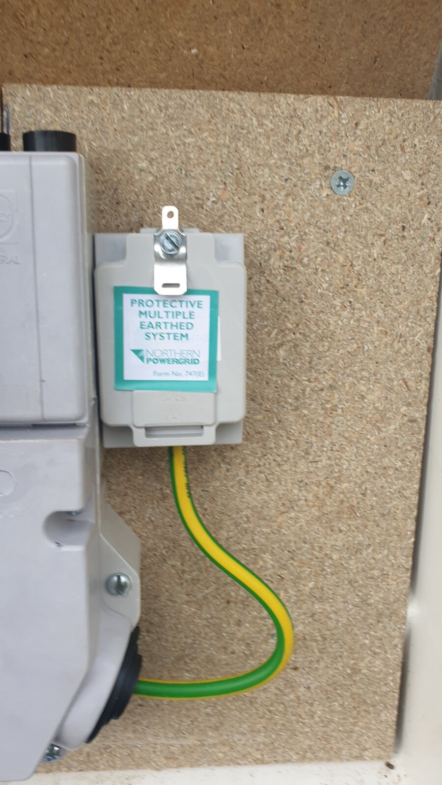

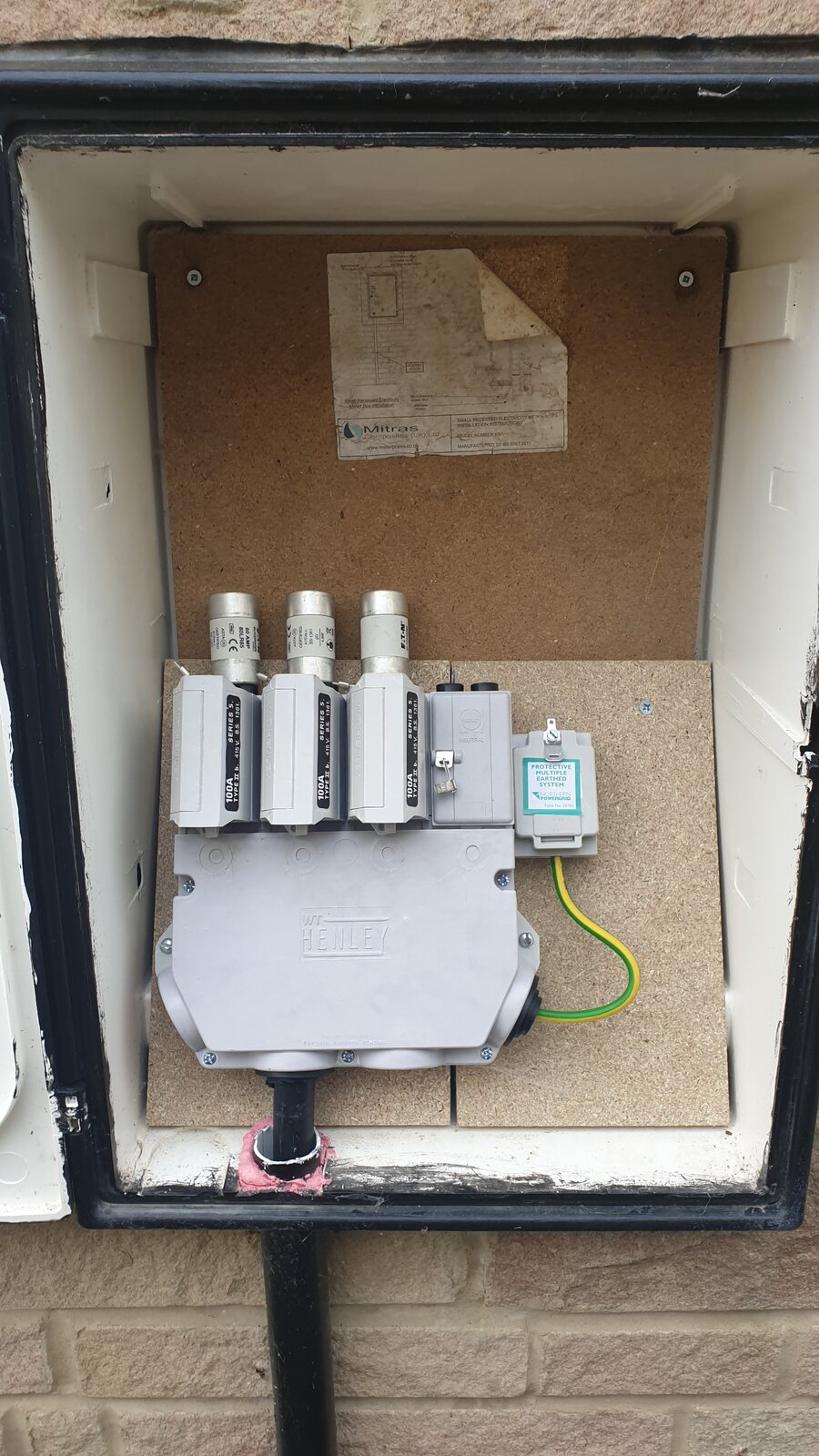

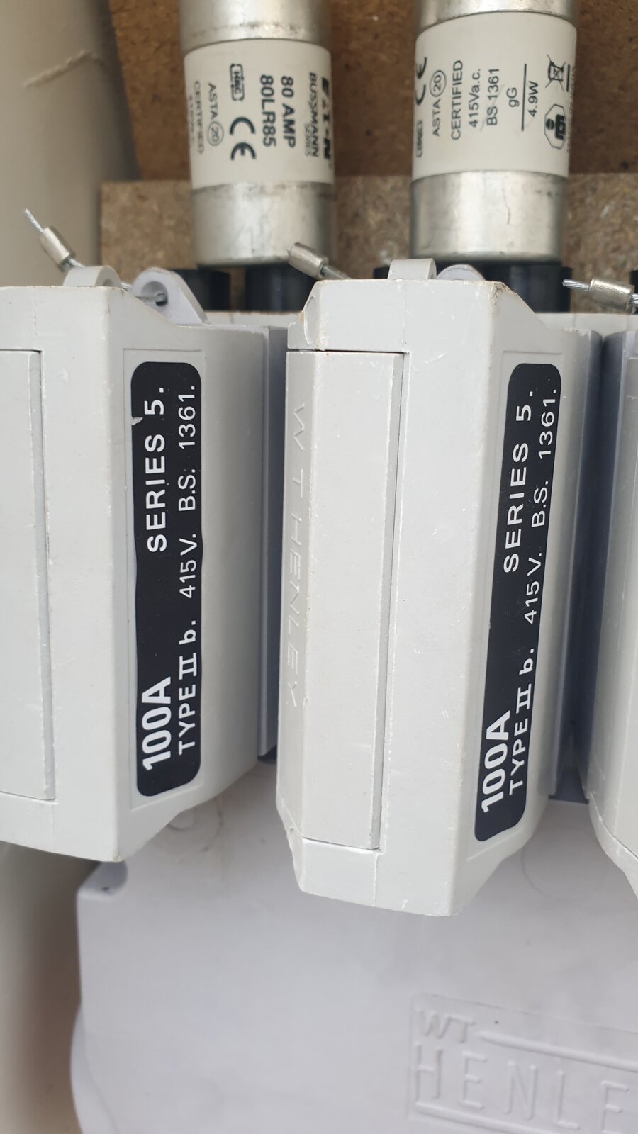

As I have stated I only have a basic knowledge of electrics and I did only start to look into this yesterday morning. I have taken a photo of the incoming supply which may help?

the incoming supply
Surprising that they actually installed a 3 phase cutout in a small SP meter box.
Hopefully it will be small meter.
