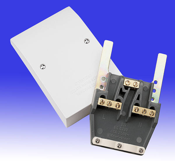

You make it sound as if what you have described is an "unthinkable" practice. However, the existence and wide availability of "45A Dual Cooker Outlet Plates" surely serves as a reminder that it is common (and, presumably 'considered acceptable' by many) practice to supply, say, an oven and hob from the same supply, with common OPD (probably rated 'too high' to adequately protect the flexes of the appliances from overload, should it happen).

Perhaps it is a 45A oven that someone has connected with the small flex.
If not, then there is also the matter of the internal wiring which will be manufactured with the smallest possible conductors for the intended load.

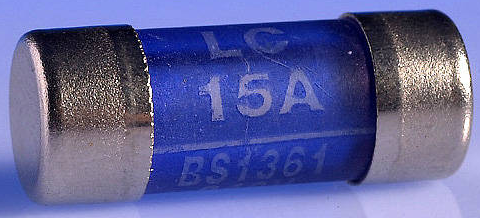

What would be good is a fused connection unit which could take a 15 amp fuse upload_2022-1-1_13-7-17.png this would allow us to use ovens designed for 16 amp supplies in the UK, but over 13 amp the fuse box jumps in size, with my mothers house the people refitting the kitchen took a 10 mm² SWA around outside of house and put a small consumer unit in the kitchen for just the kitchen. This was because the house needed a re-wire, with rubber covered cables, and no earth to lights, but it did allow 32 amp RCBO to hob and 16 amp RCBO to oven, but that was a lot of extra work and the upload_2022-1-1_13-15-3.jpeg unit at door was not very ascetically pleasing. However it was a good safety feature as the isolators for oven and hob were placed behind the hob so you needed to reach over hob to isolate it.

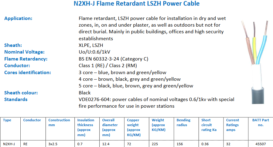

We would not wire a oven to a 100 amp supply, but there seems to be no limit published, 20/25 amp is normally OK for 2.5 mm² depending on cable type and route, I looked up and found.
So it seems 2.5 mm will take 32 amp, with LSHZ cables, you can get twin and earth as LSHZ, but normally it is thermal plastic so not suitable. But it would seem 32 amp in the main is the upper limit.

What would be good is a fused connection unit which could take a 15 amp fuse this would allow us to use ovens designed for 16 amp supplies in the UK
Well, yes, so 16A would be better.

So, back to square one: why do we need 15/16A?
If you are concerned, you can use the cable you have found.
Plus if such a thing as a 16A fuse were needed, would they not have been introduced by now?
