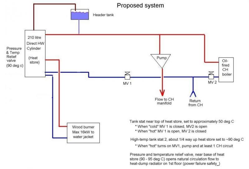

I seem to have stirred up a bit of a hornet's nest here! Many responses ask for more detail, so here is some.
Firstly the system design. Here is the original schematic diagram which was how I designed it and, in fact, is pretty much how it got built. (Sorry about the size, I'm still using how to learn this forum software, but I think it enlarges if you click on it.)
To recap a little: the heat store is a bog standard 210 litre direct HW cylinder with 2x tappings 180 degrees apart at top and bottom (ie 4 holes in sides and one at top used as a vent here). The flow from (top of cylinder) and return to (bottom) are on one side, and the flow/return to CH system are likewise on the other. All pipework is 28mm.
You'll see from the diagram that there is no direct connection between CH system and stove, but rather that the stove heats the store by gravity convection (over a height of 2 floors), and the the CH system draws hot water from the store when it is available. The actual water and header tank are common, but I'd say it was next to impossible for the CH pump to induce any flow through the stove.

I hope you'll all note that there are currently no valves or pumps in the circuit between wood-burner and heat store. Circulation here is purely by gravity convection.
My theory that reverse convection is happening is based on the following evidence:
+ The return pipe from store to stove is significantly hotter than the flow from stove to store. This based both on the evidence of my hand when touching the pipes, and from the dual-channel digital thermometer I have attached to them.
+ If I blaze up the heat store in this state then the return pipe gets even hotter, the flow colder, and before long I get bumping noises from the boilers at the bottom of the stove.

And I'm saying it cannot happen.
Therefore you are reading it wrong or there's a simple explanation.
Place the thermostats one near the boiler and one near the store, I'm willing to bet the one near the store is hottest.
If, however as you say the flow is going up the return, then the flow is locked, maybe air.
When you first light the stove it stands to reason, that heat transfer to the primary return from the hot store, will make it hotter than the flow, until the flow catches up, it's how the DHW works, cold mains goes in one side and comes out hot.

I dont think your diagram is likely to be what you have fitted. Surely the water in the rads, oil boiler and wood stove is not all the same is it?

Back to the problem, over 50 years as an engineer, I'm telling you it cannot happen under normal conditions.
To get reverse circulation the flow has to be locked or there's a driving force on the flow, which is stopping circulation.
The problem, points to a fault in the appliance, store, or pipework.
To get around the problem without solving it, and inverted loop/bye pass in the return with a pump, as per one of the earlier drawings.
What is the make model of the store, and what was the reason for no expansion pipe on the primary flow.
What part of Devon are you.
Silly question, Does the return go cold when the stove is out.
I can envisage a situation where the reverse direction flow could start.
This can be particulary the case if the pipework has not been done by a professional who is experienced with the best way to get a gravity system to work.
The "head" on a gravity system at the "start" will be hardly more than a few millemeters and the direction it starts in can be easily disturbed.
I would take the stove return down to floor level, or below, but I expect it only goes down as far as the return!
