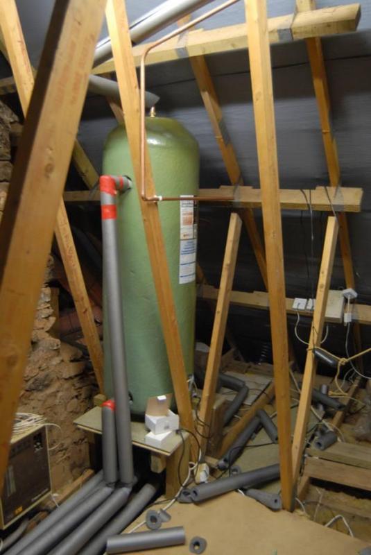

What is the make model of the store, and what was the reason for no expansion pipe on the primary flow.
Bog standard 210 litre direct hot water cylinder off the shelf. Cost about £240. So-called "heat stores" tend to be £1000 upwards - silly money! It came with 25mm foam lagging, so I've since wrapped loft insulation round it to raise this to about 250mm thickness. You are looking at the side from which the CH pipes come in and out, those from the stove are 180 deg around the other side out of sight. You can also see the expansion (lagged) and fill (not yet lagged) pipes going off to the header tank above and to the right out of shot.
The diagram isn't perfect: there is an expansion pipe from the top of the heat store to above the header tank, and also another expansion pipe from near the pump to ditto. There are also two separate fill pipes, and lever valves dotted around in strategic places to isolate bits of the system.

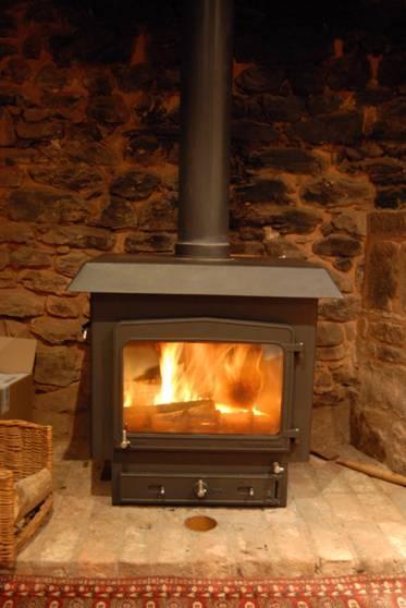

The store is shown above, here is the stove. It's a "Fireview" 20kW model from Woodwarm, Cullompton, Devon. It is fully boilered: sides, back and roof, plumbed in series as the manufacturers recommend from side/back boilers into roof. Sorry, I don't currently have a photo of the plumbing round the back.
I take your, and others', point that an anti-syphon loop should dip down below the back. You can't see the piping here because it is neatly hidden behind the chimney, but it doesn't do this - going instead straight into the side/back boilers at their base. However you can see that it is a solid hearth (with rock below) so it could only dip down about 5 inches. (BTW it was plumbed in by a qualified plumber well used to dealing with solid fuel devices and mixed CH systems.)
I can imagine that this might contribute to the problem, but in normal usage it is OK.
What is the distance between the flow and return pipes on the stove?
I take it you mean vertically. Roughly the height of the fire-box of the stove itself, ie about 500mm.
The difference in height at the heat store end is as you see in the photo, probably about 1m between flow and return tappings.
Otherwise all pipe runs are pretty much parallel and either vertical or slightly sloping upwards where they have to be horizontal. The overall rise from stove to heat store is about 5 metres.
The pipes are lagged individually in the roof space and in their runs inside the walls, and then covered by a layer of loft insulation. There will be some heat transfer between flow and return, but it will be negligible over a short period of time.
If the stove connections to the cylinder are the same heights as the CH connections, it gives quite some potential to drive the reverse flow, though with 500mm spacing on the stove there's possibly not quite enough there to stop it.

How :eek: There must be at least 1000mm between the flow and return, which must give you at least 10c differential in favour of the flow.
True, although most of the time the temperature differential in the heat store is quite large - typically > 20 deg C - and it's not a problem.

I think it's probably boiling and air-locking (or steam-locking) the flow pipe and this is stopping the gravity circulation (NO CIRCULATION). The steam pressure is then displacing the water in the stove downwards and up the return pipe.
The manufacturer's website say the stoves have top and saddle boilers; we don't know how these are piped up, so that may be affecting the gravity circulation. I'd like to know whether the return connects to the bottom of both side boilers and the flow to the top boiler.
