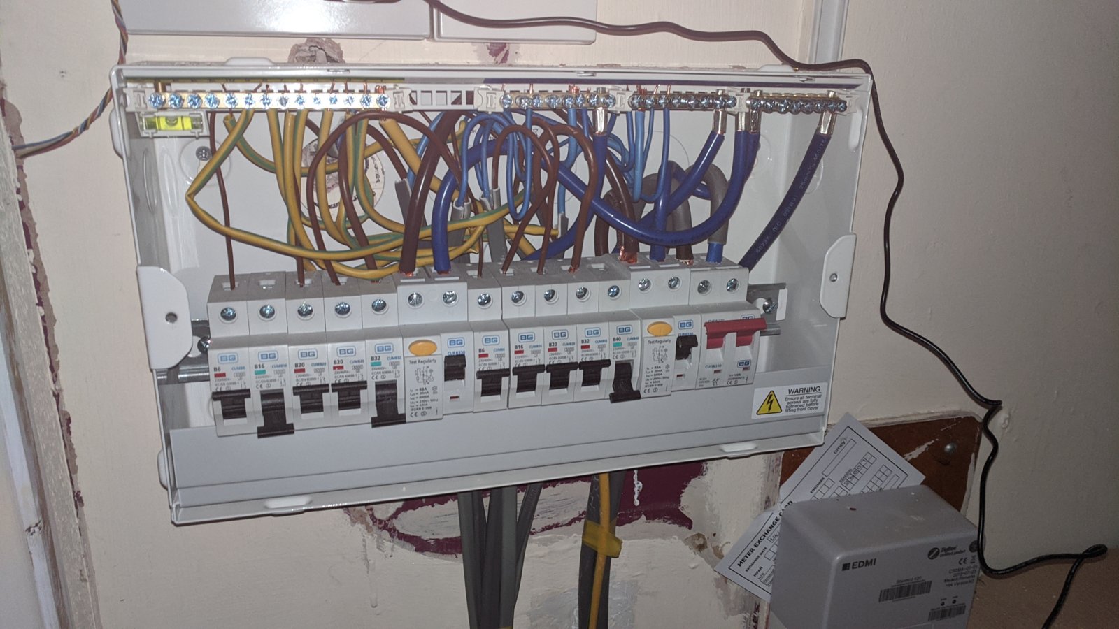

I'd still like a photo of the inside of the board, if you're confident enough it's just two screws to undo. Power off if you're really worried. It will give us all a true measure of how good this chap is.
Ask the electrician to tell you which regulation requires the sockets to be put at 450mm.
I have also been an electrician over 20 years and have never carried out work to such an appalling standard.
I haven’t done a rewire for years now but when I did, we would always walk round with the clients and agree the position of every accessory before we started, and have a chat about what damage we would have to do, but in all my years I’ve never yet had to wreck a coving as has unfortunately been done in this instance.

This is the inside of the fusebox
