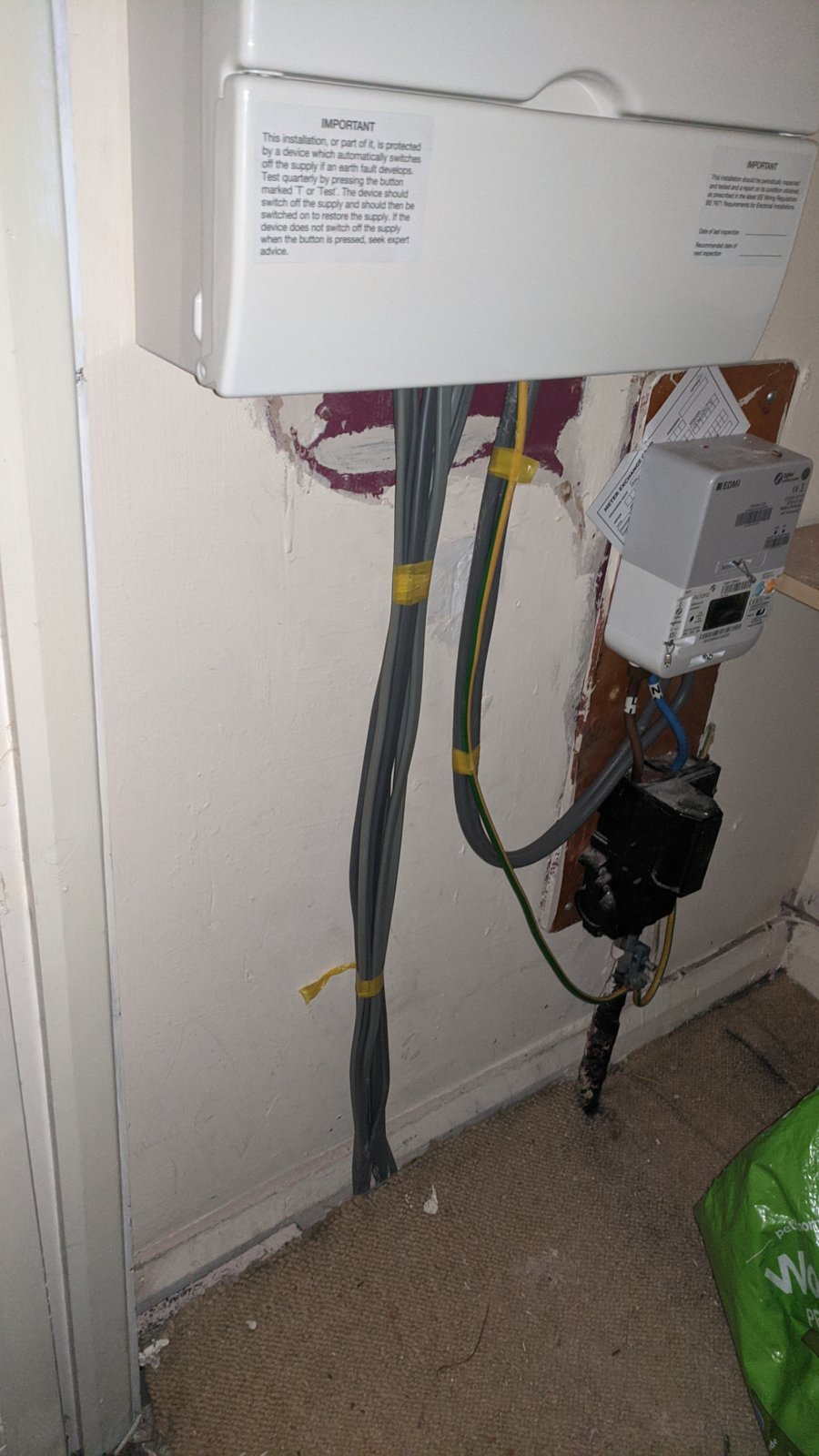

This is the inside of the fusebox
I think this picture confirms that your electrician is 'not the best'.
While it may be functional, this sloppy, untidy display reflects the damage done to your walls.
To be fair to your electrician, you did say you would repair the damage, and if all your walls were solid brick you would have lots of chases to fill.
But I do think some of the holes were unnecessary, and he could have patched the holes with bits of plasterboard as a gesture of goodwill.
All in all his work is a bit rough to say the least, obviously inexperienced or doesn't care.

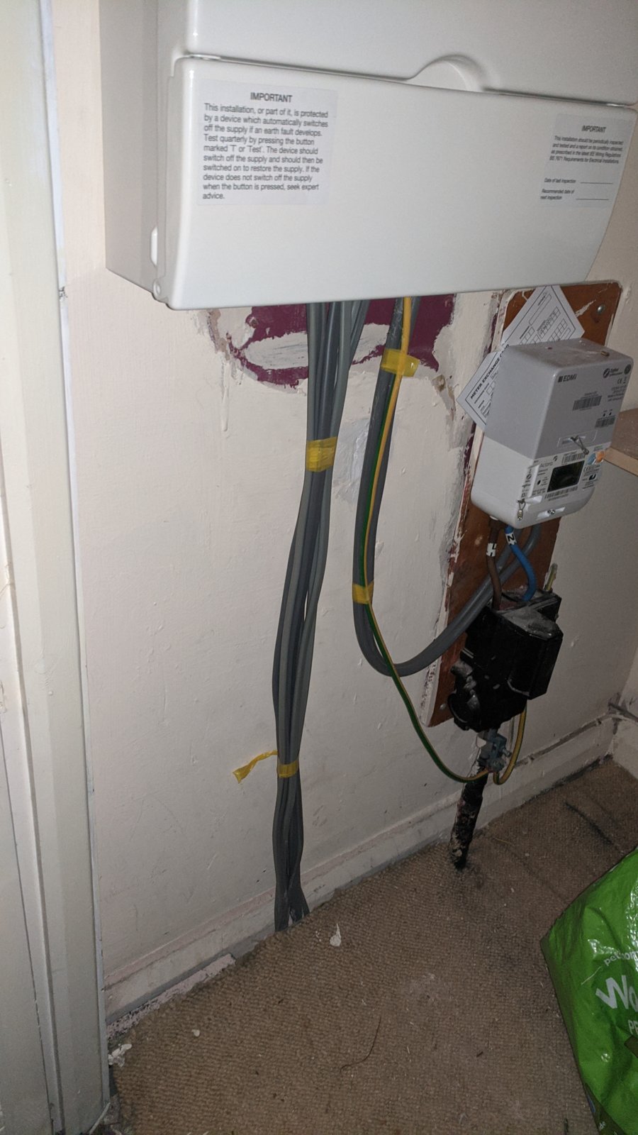

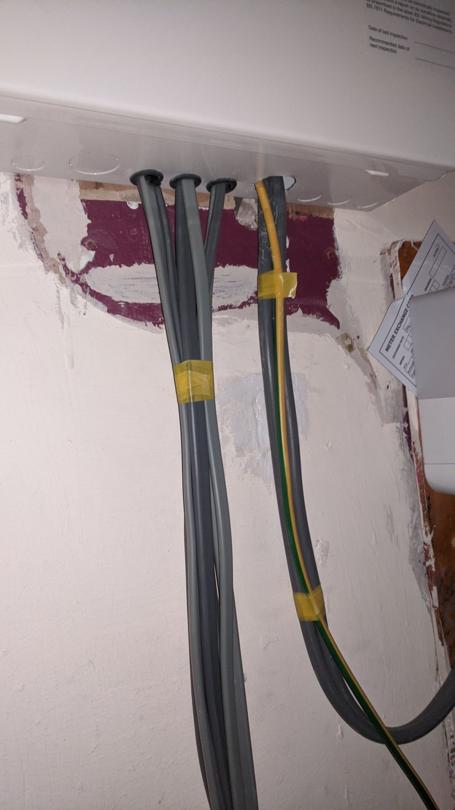

Here are the wires going in. He said he could have them go like that or come in at the back through the kitchen but the latter would be a lot messier. So we opted for the former.

That’s appalling and potentially very dangerous. the main feed tails into the CU do not have a grommet.
he has just brought the tails through a rough bare metal hole. in time it is likely that the rough metal will saw through the meter tails and wham bam melted consumer unit/fire/arc eye if you are looking at it.
Do not accept this. Report him to his CPS (if he is even a member)
also bad, for a new installation to have the cables coming from the bottom open like that. Did you agree to that?, anyone with a bit of sense would have them boxed in - maybe even a large bit of plastic trunking.
as they are, the cables must be supported. Clipped or cleated. The weight of the cables will try and pull themselves out of the CU.

I was expecting to comment the CU was appalling...
The 10&16mm² links seem a bit strange but I don't know the BG units so this may be what they supply.
Apart from the lack of grommit mentioned elsewhere the other thing is a bit much copper showing in a couple of places.
Overall it's a bit scruffy [and to steal W2's term lazy]. But that's actually not too bad by todays standards.

He said we could have the cable come in at the back but he would cause a lot of damage to the other side of the wall (which is about 1" thick anyway) or he could have them come up through the floor like that for me to box in at a later day.
