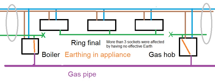

Sometimes a "good" Earth continuity test can be masking a serious double fault in the CPC
If there is any doubt about the measured R of the CPC then a wander lead should be used to verify that each and every socket has an effective Earth
