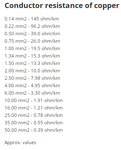

However, we have unearthed something a little odd. Goodness knows where all the sources (including BS 7671) get their figures from. but if a given manufacture were to publish figures indicating conductor resistances for a range of cable sizes which were not (exactly) inversely proportional to their alleged CSAs, that would surely indicate that some of their conductors did not have the intended CSAs.
Somewhat 'worse' than that, there are always going to be small manufacturing tolerances (in CSA), but one would expect/presume that the figures (for resistance) they published would relate to the nominal/'target'/typical/average/whatever CSA - so IF their resistance figures were not inversely proportional to CSA, that would seem to imply that they had 'deliberately' manufactured conductors with 'incorrect' (target/typical/whatever) CSAs.
The deviations from 'expected' we've been discussing are clearly not large enough to be of much practical consequence, but it would be interesting to know why they exist. As SUNRAY has pointed out, they cannot all be explained solely on the basis of rounding.
Kind Regards, John
It seems impossible to find a definitive value of a particular wire to start from.
Sites vary significantly in their figures.
This one comes up first on my search but as you can see very few of the values on the same site match.
Strangely, though, the 2.5:1.5 is spot on - but even the 1:10 isn't and both are higher than usual.
https://www.macartney.com/what-we-o...l-information/conductor-resistance-of-copper/

It seems impossible to find a definitive value of a particular wire to start from. Sites vary significantly in their figures. This one comes up first on my search but as you can see very few of the values on the same site match.
Indeed. It's very odd.
Indeed. As I've said, I'm not so concerned about the absolute differences in figures in different sources (which could be due to all sorts of reasons), but one would expect the ratios of resistance to correspond with the ratio of CSAs to be the same for everything from a single source
As you say, the 2.5:1.5 resistance ratio from their figures is 'spot on', but that's not the case with any of the other pairs I've tried - and, at least in most cases, the discrepancies cannot be explained by rounding alone. For example, with the 1:10 (mm²) comparison you mention, the ratio of resistances is appreciably above 10 at both extremes of the possible rounding errors.

Yes, but the number of significant figures in the figures they are quoting indicates the degree of precision ('accuracy') they are working for and, as I've just written, the discrepancy of 'resistance ratios' (in comparison with 'CSA ratios') we are seeing cannot be explained by the rounding alone.
Actually, if you look at the published max and min allowed diameter for cable CSA you might be surprised how close some of it is consistently manufactured to with the last few microns of permitted sizes. Makes a bit of a mockery of allowing a manufacturing tolerance so relatively wide open. Of course the manufacturers aim to get away with the least amount of conductor allowable.
Yes, but as I've also written, even give the existence of manufacturing tolerances (od CSA), no matter how wide, one would expect the quoted resistance figures to relate to the nominal/intended/typical/average/whatever CSA - so, again, should correspond with the raio of those CSA figures.

Let's see if I can work this out using the physics:
The resistivity (rho(Cu)) of pure copper is 1.68x10^-8 Ωm at 20C. The temperature coefficient is 4.04×10^-3/K, so corrected to 25C, rho=1.714x10^-8 Ωm ( a little higher as you would expect. BTW, Ωm is correct, it is not Ω/m)
The resistance of a conductor is given by R=rho*l/A, where l is the length in meters and A is the cross sectional area in m²
2.5mm² is 2.5x10^-6 m²
So the resistance per km at 25C of 2.5mm² copper is R = 1.714x10^-8 * 1000 / 2.5x10^-6 = 6.856Ω, This assumes pure Cu and DC but I would not expect significant reactive effects at 50Hz.
I wonder where the other values come from? Or am I missing something?
