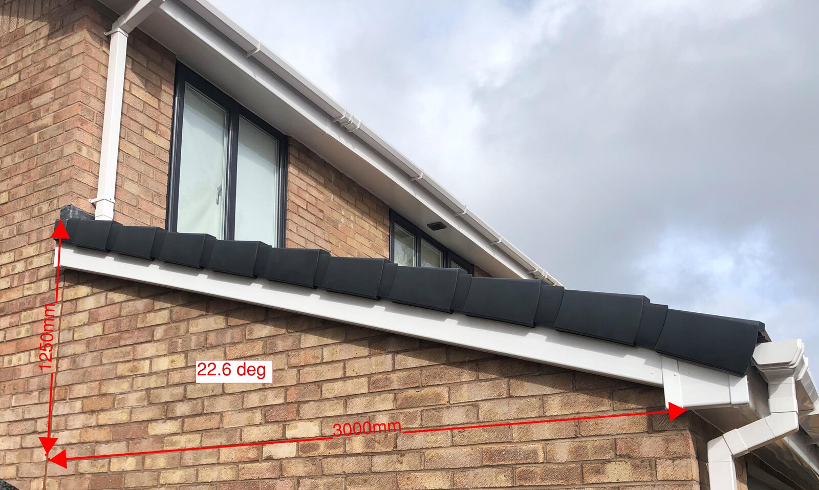

If you where planning on changing the windows then it would have been wise to add a few course of brick to gain some pitch.
what tile is that?
I think I got the pitch wrong. Seems it's OK at 22.6 deg. I spoke to roof tile supplier and they confirmed those tiles are 17.5 dwg minimum. Can anyone confirm it's 22.6? thank you (still doesn't fix my leak)

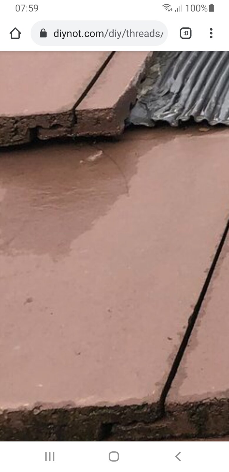

What is this?

Correct.
I get your roof at about 16.3 degrees.
In your image, you have the rise measurement completely wrong in relation to the going or horizontal.
What bit have I got wrong?

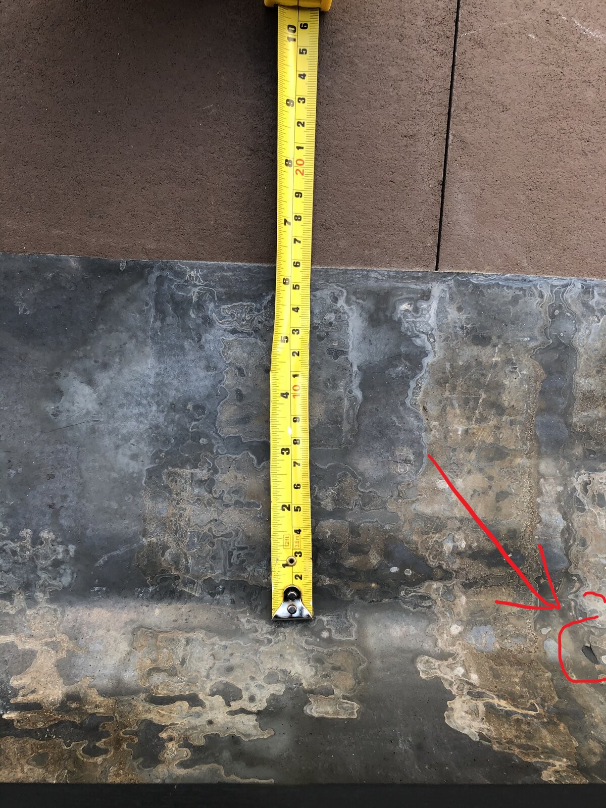

builder has come round. He lifted about a dozen tiles and it was dry under there. I could see the stain on the felt where it has leaked. He was a bit puzzled but replaced a couple of tiles a tightening them all up. It hasn’t poured down since yesterday so I’ve no way to checking, I’m not too hopeful.
If I had to guess from the picture I would have said 15 but not less.
Looking at the measurements the rise is indeed wrong
Your vertical line needed to stop short of the fascia by about 1 course of bricks based on your horizontal (3m). For some reason you carried it on past that and up to the top of the tiles - therefore you should have extended the horizontal line so that it would meet a diagonal drawn say skimming the tops of your dry verge caps.
