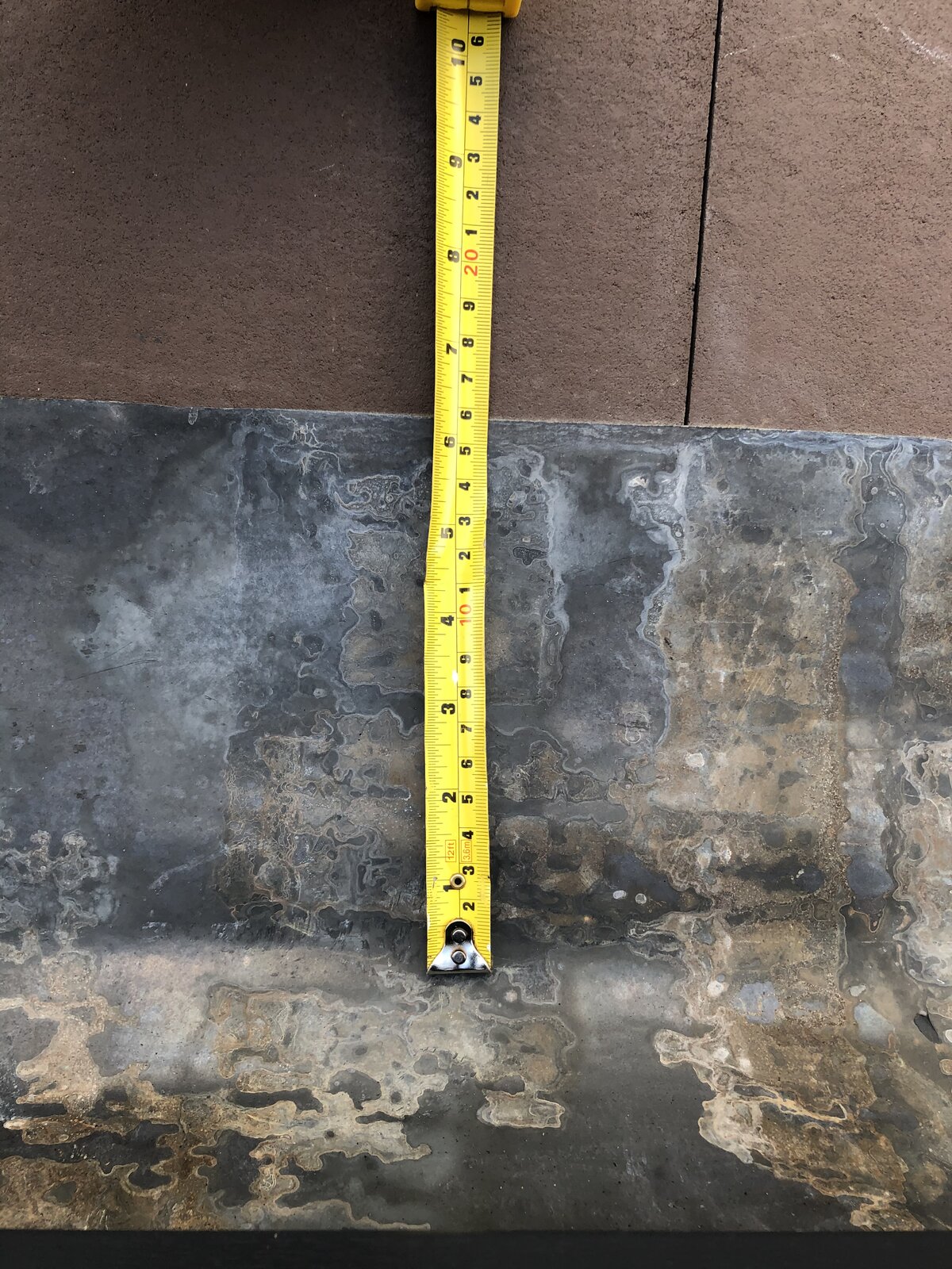

Roof leaking below Velux

thanks both. I downloaded the velux pitch app and that gives 17.7 deg so taking away it’s a phone the roof is still on the border line. There was some rain last night and the roof looks ok for now, I’m still not convinced. Even though the felt is the second line of defence I noticed it’s still punctured with nails because the horz battons is nailed to it so I guess it could get in through there but unlikely I guess.
Its hard to imagine how the water is getting past both tiles and felt?
unless it a cavity tray thing!
It sits 160mm on the tile all the way along.
That only shows how much flashing is down the roof slope. It does not show cover on the head of tiles. Also it does not show side over lap on each flashing section. It is also worth checking under the cill. And the seal around the window frame .

It's been good since March but today it started leaking again after the heavy rain overnight :(
I've already paid the builder the outstanding amount. I've had a local roofer out this morning, someone who fitting my facia and guttering prior to the extension a number of years ago so I trust him. Straight away he said the pitch is too shallow and there isn't enough headlap. He said without raising the whole roof to meet the minimum pitch he could try and re-felt around the problem area (he said he would do the 2 veluxs) and if that didn't work he would pack up all the battons to get an extra row of tiles in to increase the headlap. He said it was a tidy build and the tiles/felt etc were all very neat but the wrong pitch.
