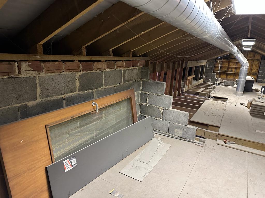

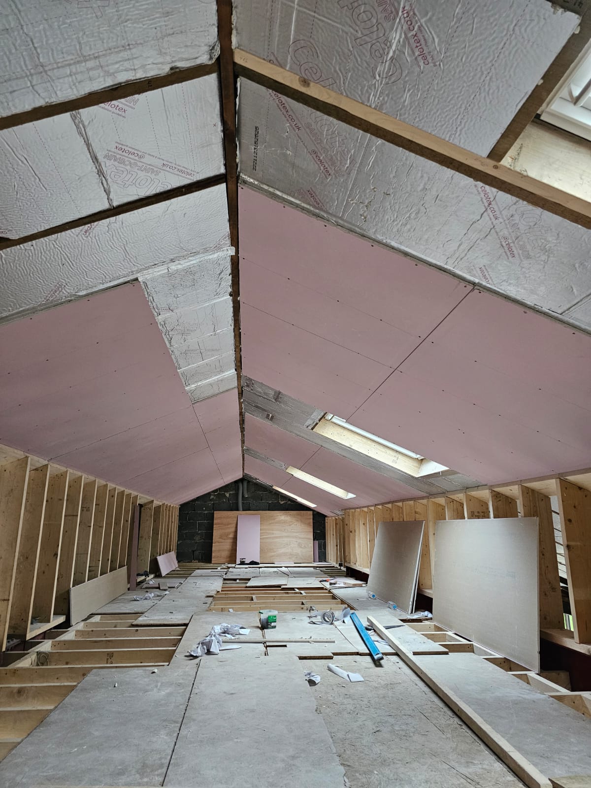

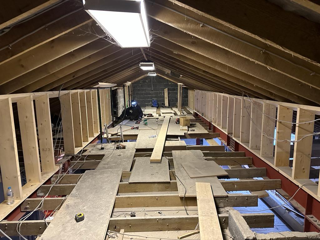

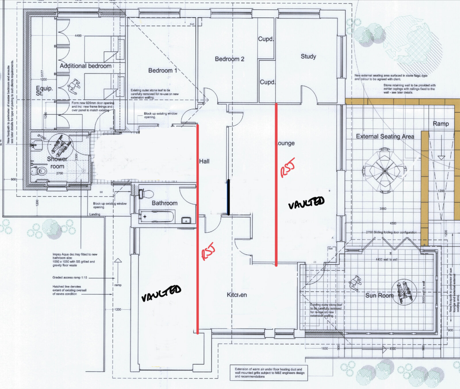

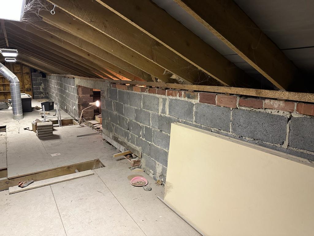

See attached image from the loft view when work was underway. Hopefully that makes the structure clearer. Pictures are when work was being carried out. Basically, there used to be walls running from the ground floor up to the loft that acted as ’purlins’ to break the rafter span. We decided we wanted an open plan approach so had the rsj’s installed to support the roof structure Via the 8x2 stud walls.
This all worked out quite well as the walls in the loft had failed - blocks with poor motor mixture were basically loose!!
During the work we decided we wanted the downstairs ceiling vaulted.
Some original photos attached of the structure. Floorplan edited to show the RSJ positions and vaulted sections.

@freddiemercurystwin no, the top plate is screwed to each rafter using two 5x80mm screws. i did think birds mouthing them would have been better.
So, notionally your rafters are balanced at an angle on the new dwarf walls and cantilever out to the ridge, span down to the walls. If the span from ridge to dwarf wall is shorter than from dwarf wall to house walls then it's likely stable enough with the self weight of the roof but if they sag over time, either side of the dwarf wall you may well see some spread and rotation of the dwarfs. Interesting design but if an SE's signed off on it then no problems!
How did you fix the wall ends of the rafters?
