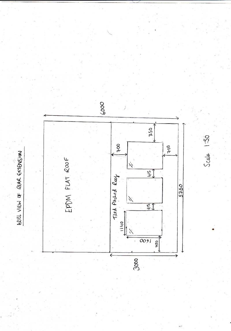

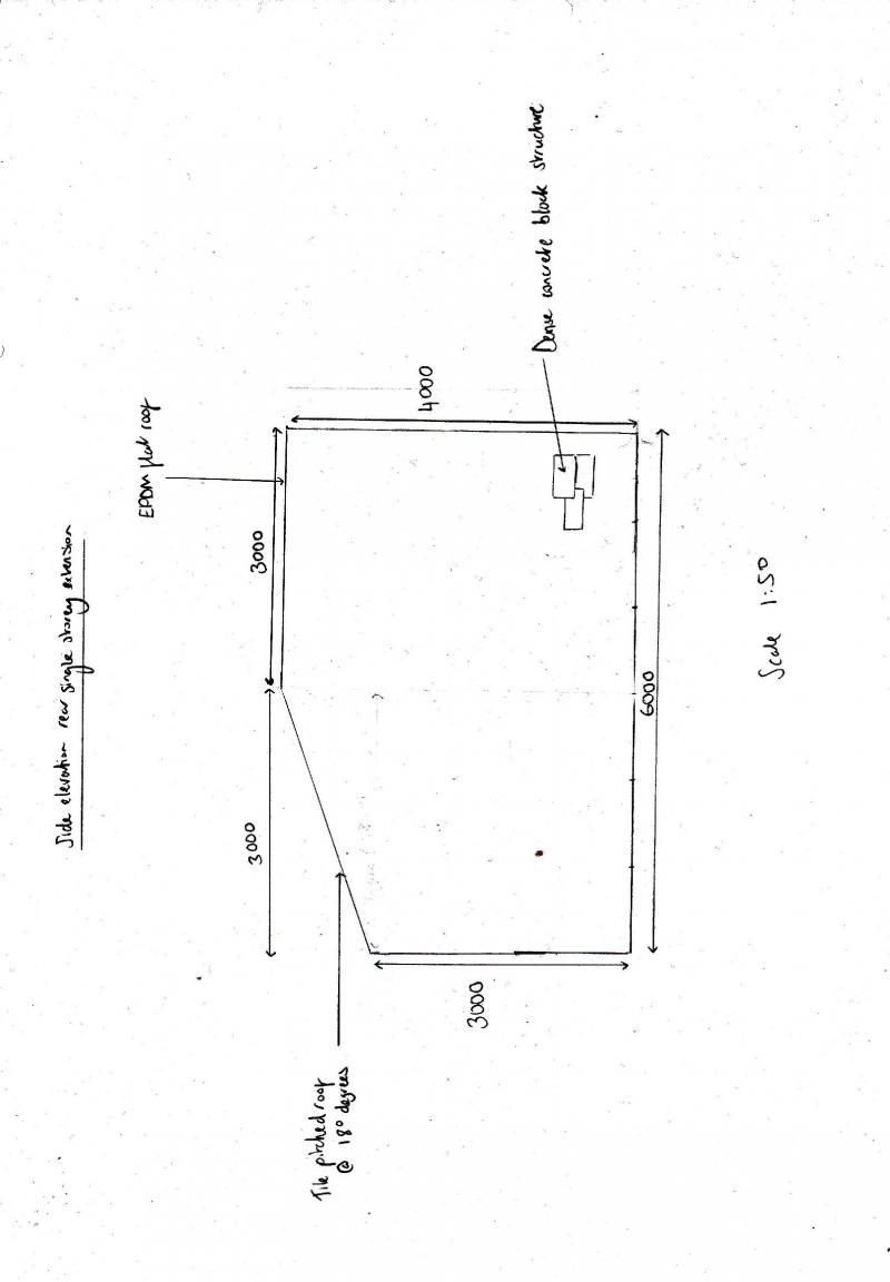

Ok so, 6 meter extension from the rear of the house. 3 meters to the eaves and 4 meters to adjoin the existing rear wall of the house.
From the existing house, a 3 meter flat roof will be installed. From that point there will be a pitch of 18 degrees down to the 3 meter eaves of the front of the extension.

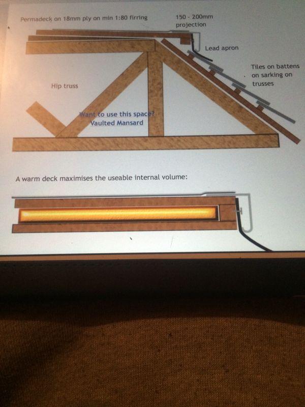

This image is what my builder wants to build
This image is more of what i'm after.
Birds eye view of the extension
Side elevation of the extension

You would get away with a single steel beam running from side to side, where you've shown a physics defying nail plate. Then you can sit your rafters and flat roof joists onto this steel. But it won't phase your SE, that's why you're employing him. It should be possible to hide the beam completely, normally there is a good wadge of insulation beneath the joists/rafters.
As above, a beam spanning full width is the optimum solution.
And no, you cannot join timber members as in your second pic.

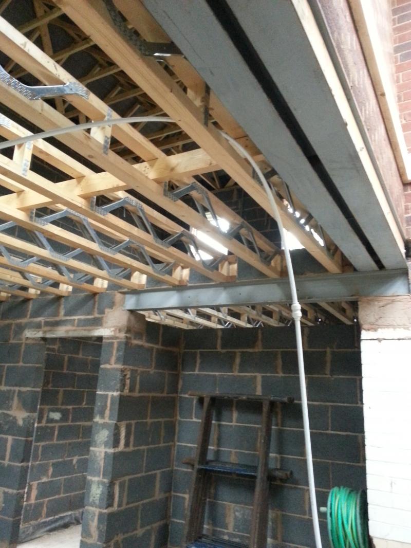

I was thinking the same thing about an RSJ just running before the pitch line to allow for more strength. But then what about where the pitch meets the eaves, seems as though this will be the 'weak point' so to speak.
Excuse my ignorance, but in the photo Noseall supplied, I can't see a steel beam at the junction of the flat roof and the start of the pitch, I assume I am looking for an RSJ or am I just being a wombat?
Possibly it is a 'flitched' beam, which consists of a long, thin steel plate sandwiched between two timber joists?
Hopefully Nose will be along in due course and satisfy our curiosity!
I think he mentioned in a previous post it was a flitch beam and if you look there is a gap between the timber.
Oh yeah, I can see the plate bolted between the timbers. the thing I can't get is how is the flitch beam held up? the far end wall has a roof slope so the beam hasn't got a wall to sit on.

Correct. And a bloody heavy arrangement too!
2 x 195mm x 47mm timber beams with steel plate between. All bolted together with (staggared) M14 bolts.
The beam is supported off the wall at t'uther end and is on a timber prop (railway sleeper) and another steel beam shown in the image. I have all my beam webs drilled so that I can bolt timber into them as you can see in the images.
If you look at the image in my first post you will see a patio opening with a steel beam across. Directly above and at right angles to it is another steel beam. There is a timber prop supporting the flitch junction off said beam.
All the beams are filled with timber and are bolted to the web. Makes cladding the beam simpler.
Gotcha Noseall..............jeez, that's lots of supports supporting the supports!....the beam over the patiodoors supports the beam sitting above it which supports the flitch plate beam!!!
I know! Scratched my head a bit on that job. steel beams everywhere and all had critical height position relevance. (see below).
