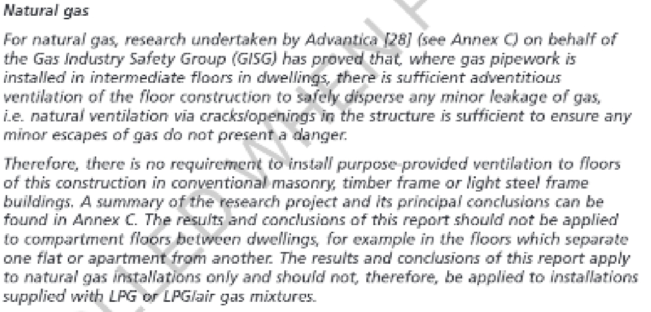

Routing 28mm Gas Pipe Through 7 Inch Joists

To be fair I’ve had dealings with a lot of qualified Gas guys that seem dead set on just reading a paragraph of an approved document and quoting that as it suits their judgement. Rather than read the document as a whole and actually coming up with the correct answer.
+1 for no ventilation needed in this situation.
Interestingly (perhaps), a false ceiling is a different matter.
We've just done one where Gastite was use instead of Tracpipe in a false ceiling and that was deemed to need ventilation after reading the standards.
But seeing as Bernie likes a bit of research:
This is from the standards we have to work from.
Still quite strict with regards to tracpipe as a pipe in pipe - no cuts / damage throughout its length.
Would deffo advise pictures being taken to prove condition / integrity at point of install
Just in case the ventilation void police get their claws out.
