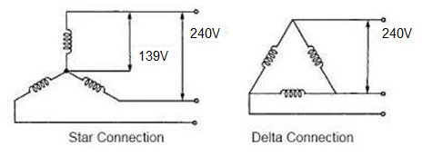

Because the fundamental issue which has been concerning me is the supply. Yes, if you connect it star then the voltage across each winding is indeed 230V not 400V. But see my question above - what is the phase to phase voltage of the 3-phase supply used for the motor?

or make it 240V delta which makes it easy to use DOL to a 415V 3Ph supply or on a 1Ph input converter.
If a supply is described as 240V delta does that not mean a single-phase voltage of 139V?

main-qimg-27907edf45eaee589b4490a8c251b74f-c
NO, because a 3P supply is not STAR or DELTA, it is "just" THREE PHASE. It just has three line conductors providing sine wave voltages that are 120˚ apart - and may or may not have a neutral (some 3P systems are only 3 wires and no neutral). We'll ignore all those details as they aren't relevant - just concentrate on the 3 line connections.
Star and Delta have no meaning on the supply side - where they have meaning is in the connections for things like motors, transformers, and generators. But yes, if a supply is 240V 3P AND is a 4 wire supply with a neutral, then the neutral-phase voltage will be around 140V.

That is down to you not understanding that a motor winding is made for a specific voltage - and it's the arrangement of connections of those windings that gives the required supply voltage for the motor. All 3 phase motors (at least of the sorts were talking about here) are inherently dual voltage - the voltage each winding is designed for (delta), and 1.7 times that (star).
Taking your diagram above. If the windings are each designed for 230V, then the star connected motor on the left will run just fine on a 415V 3P supply. If you try and connect it to the same supply connected in delta as on the right, then you'll be applying 415V to a winding designed for 230V - cue magnetic saturation, excessive currents, and if the motor doesn't have some suitable overload protection then it'll soon be an ex-motor, gone to meet it's maker, with burned out windings (if it hasn't set the place on fire first :eek:)
But, since the windings are 230V, you CAN use the delta connection on the right to run it from a 230V 3P supply - as commonly found from low power 1P -> 3P inverters/variable speed drives.
If the windings were each designed for 415V, then it would only run properly on a 415V 3P supply if connected in delta as on the right - 415V across each winding. If you tried to run it in star, then each winding will have only 240V across it - there's be much lower magnetic flux, much less torque, will run slower for a given load, and probably counter-intuitively run hotter :unsure:
But where this is useful is in starting large (especially high-inertia) loads. If you connect the motor in star initially and apply power, it will start turning with reduced torque and most importantly with significantly lower current draw. When it's already turning, disconnect the supply, quickly reconnect the windings in delta, and re-connect the supply - it'll then run up to full speed. This is "star delta starting" and is often used on large loads to reduce initial current and/or mechanical stress. There are automatic and manual devices for doing this (I had to scrap a perfectly good manual one clearing out dad's garage) that don't involve fiddling with the wiring :mrgreen:
It's not suitable for all types of loads as it relies on the load not presenting full torque during startup. So great for things like fans and centrifugal pumps, high inertia loads like rolling mills (that can be unloaded for starting). What it can't help with is things like positive displacement pumps which reach full torque more or less in the first revolution (or less) unless hydraulically unloaded.

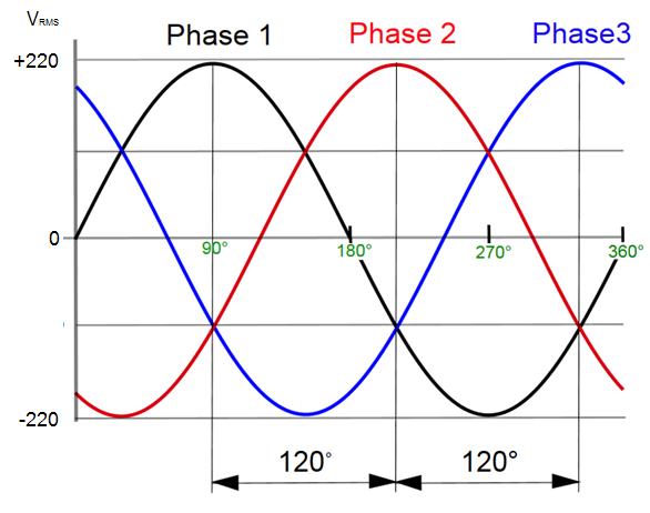

I am not missing a fundamental concept - you are still missing what my fundamental question was about.
If you have a 230V 3-phase supply then you have 3 phases, 120° apart, each with a phase to neutral voltage of 133V. My question was, always was, and still is, where in the world is there a distribution network supplying 230V 3-phase to its customers?

No I'm not. I understand exactly what you are getting at - but there does NOT need to be such a supply ANYWHERE for there to be made motors which can run on it. As I said, a "415V 3P" motor may have 415V windings in delta - or it may have 240V windings in star. If the only requirement a motor manufacturer has is to make a "415V 3P motor" then the choice between those option will be down to whatever priorities the designer puts on the various parameters. However ...
Yes

As I described previously, I have worked on a system where single phase loads get 220V on 2 wires, and three phase loads get 220V 3 phase on 3 wires.
You did.
This is 220V 3-phase - what do you connect between to get 220V single-phase?
In some ways, it's a simpler system than a 4 wire one (one less conductor to start with) though it does require double pole breakers. And since the AC conversion was done specifically to allow "off the shelf" equipment to be used (the ship owner was based in the USA), I find it hard to imagine that what was installed didn't in some way reflect a practice which was current at the time in the USA.
A 3-phase supply, 230V phase-to-phase, was not something I had ever known used in the USA, hence my question "Where in the world do they have 230V 3-phase supplies?".
After a little bit of searching I came across this thread which seem to suggest that the system was actually fairly common in Europe at one point, and still exists in some places.
In the page linked to in one post on that thread it seems clear that the USA did in fact have a 240V 3 wire 3 phase system. And somewhere down near the bottom it says : "Other special cases: There are also some special wiring used in some places. Another much rarer scheme is 230V between phases and no neutralin the supply (also called 230V delta). Houses are then fed two phase wires, neither of which is necessarily anywhere near earth potential. This is used in at least in Norway in some locations. Also in some places in Belgium three phase 220 across the phases (= 127 phase to earth/neutral, 230V Y output on transformer) is used on older domestic dwellings (new installations are 400/230V 3 phase, neutral, earth). For this reason all Belgian fuseboards (whether actual fuses orcircuit breakers) protect both current carrying wires irrespective of supply type."
Was common... still exists in some places... much rarer scheme... some places in older houses in Belgium....
