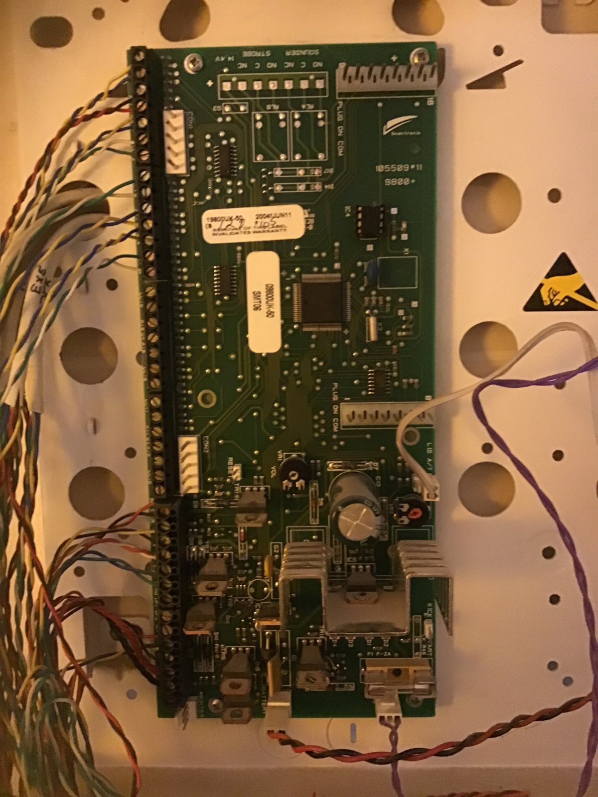

Could be faulty panel ?
Can you put panel in engineering mode and post photo of alarm pcb showing the zone wiring if possible
When I left the house with keypad showing SR the alarm went off when I opened the front door so it’s now in E mode I have sourced a replacement board for 40.00 so might go for that they said it’s tested and just need to put NVM chip in the board once I replace the board will it be easy to programme or would it be ok to ask for advice once fitted thanks

Have you got a door contact on zone 1.
C- could be a short on a cable but not 100%.
Your could link out zone 1 by putting a wire link in place of the two cables for the alarm pair and also link out the tamper pair as well and then try to set the system.
With regards to the replacement panel you can get a new control panel and keypad for less than £100.
If you need to put NVM in then do not use replacement as still could have fault
Hi yes I have a door contact in zone 1 I have just replaced this as I think they gave up and stopped working they have a red wire black wire and the blue and yellow are twisted together and connected as well to door contact so could I disconnect door sensor and connect wires or link out what ones but confused thanks
In the control panel remove red and black pair and replace with wire link
Remove blue and yellow pair and replace with wire link
Now see if alarm will reset and fault light disappears.
You will need to replace control panel lid to test

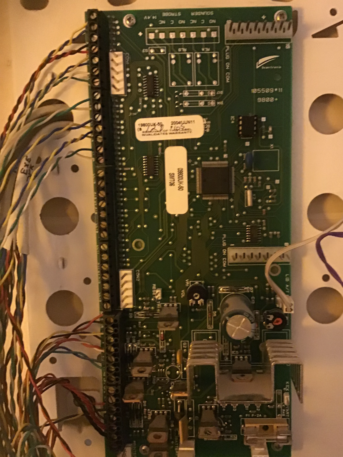

Do you know what pair they are as got a few red/black and blue/yellow wires what would they be marked as on board thanks
Starting at the top left hand side CCT1 will be zone 1 pair and A/T 1 will be tamper pair
Remove these two pairs and link out.
If this does not work then control panel could possible be faulty.
You can replace the existing control panel and 're use your old devices.

Ok I have found the pair but AT1 shares another wire in the terminal another yellow so in the top one I have cct1 this has the yellow and blue then AT1 has the red and black but also a yellow wire and the one underneath that has a blue
Remove top yellow and blue and put wire link in
Remove red and black,leave yellow in and put wire link between yellow and terminal where black was
Hi I have done this when I powered back up there was no sounder as was in E mode I have pressed 99 to come out of e mode but it won’t and same fault is still there on control panel me thinks that engineer was maybe right
Do you possibly know where I could get a new control panel from complete with NVM chip thanks
