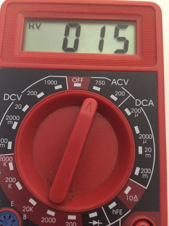

Here is a pic. It's the same reading on both chimes. When the button is pressed down, the reading drops to 0 and then back up to 15 when button is released.

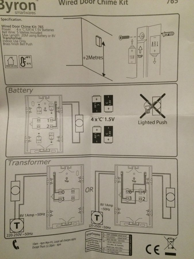

I've bought a byron 765 from Argos attached is the instruction. How can I wire this one up? Given up on the other !
The and.

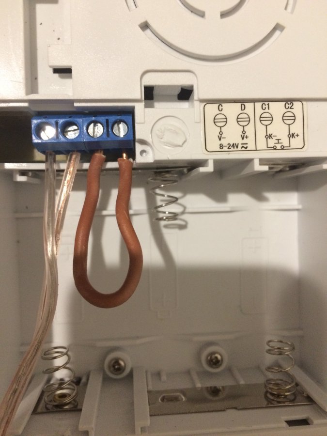

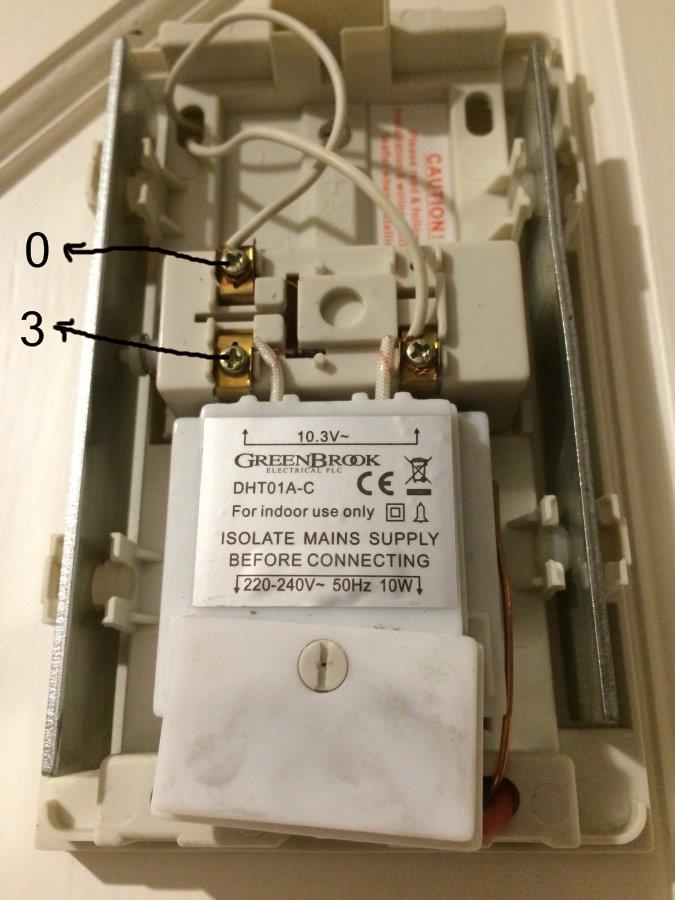

I've tried 0 and 3 initially so that activates the original ding and half dings the new one. This is without a button push. And the ding stays on the original and doesn't dong until it's disconnected.

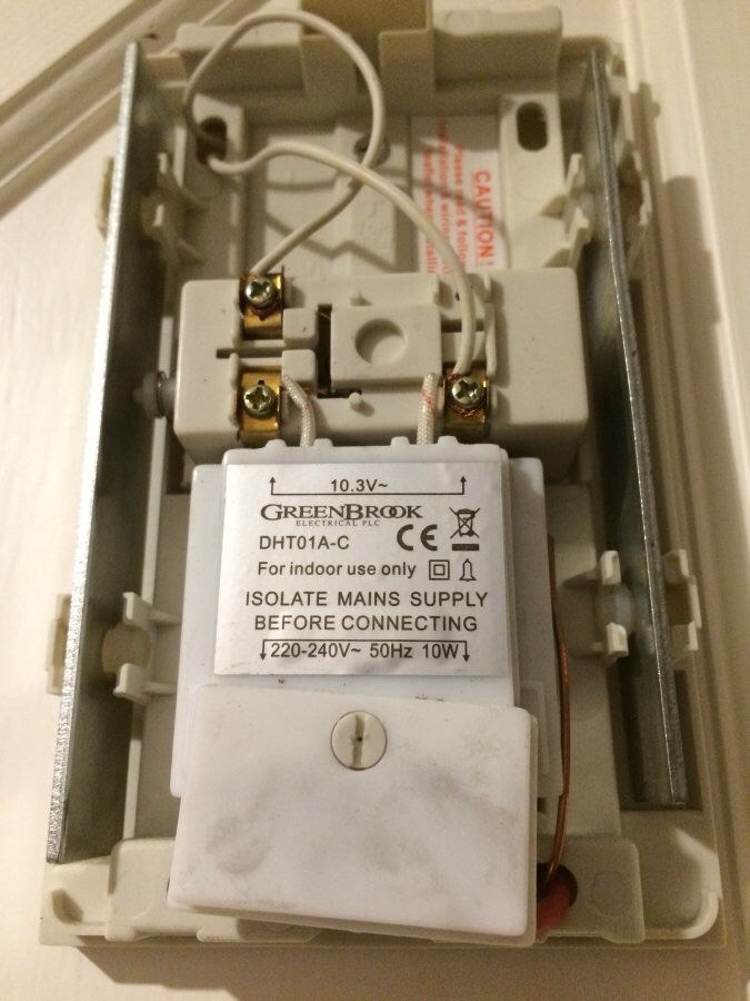

Here's the original
So it's connected to the same terminals as the White wires are which are connected to the door bell button.
