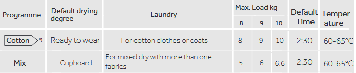

What I am not sure about is
I can understand Dry level, but if one looks at the first two on the list
the main difference is the max load, but time is the same, and temperature is the same, so in real terms what does the knob do? I can see with wool it is cooler
but of the 14 options, there are just two heat settings, the max load changes, and the default time, but once clothes are washed, they need to dry, one can't really sort out washed clothes into cotton, synthetics, and wool, as to go into the washer they have been sorted by colour, so they will go into the dryer also by colour. And looking as
it is the same temperature as Mix, so why has a program for Baby Care? As to maximum load, I have never weighed my wet clothes, we have IKEA units with boxes in them to match the colour of the wash, and when full we wash the contents of the box, the only items which have any special attention is women's under ware which may have wires in them, they are bagged first.
