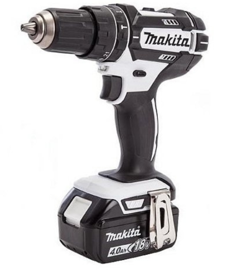

Secondly, should my Makita drill/driver have handled this situation? It's still under warranty and I could return if this is an issue.
It shouldn't and it isn't an issue. You bought the wrong tool for that particular task - a bit like trying to use a Vauxhall Astra and a trailer to do that job that you really need a 7.5 tonne truck for. There is nothing wrong with the drill/driver you purchased, but drill/drivers aren't designed for industrial-size fastenings. My DHP481 will do it, but then it's the most powerful 18 volt drill Makita make and even then it is slow and gets hot when tightening multiples on coach screws.

I have one of these:
and when I was screwing in (eventually try speed 2 on full torque), it didn't manage to screw in a coach bolt (75mm) into a rawl plug. I got it 3 quarters of the way home but it wouldn't go any further. I suspect my impact driver would have done it if I had it to hand...
Question: is this drill/driver designed for such a purpose? Should it have managed this?
Maximum torque is at lowest speed
