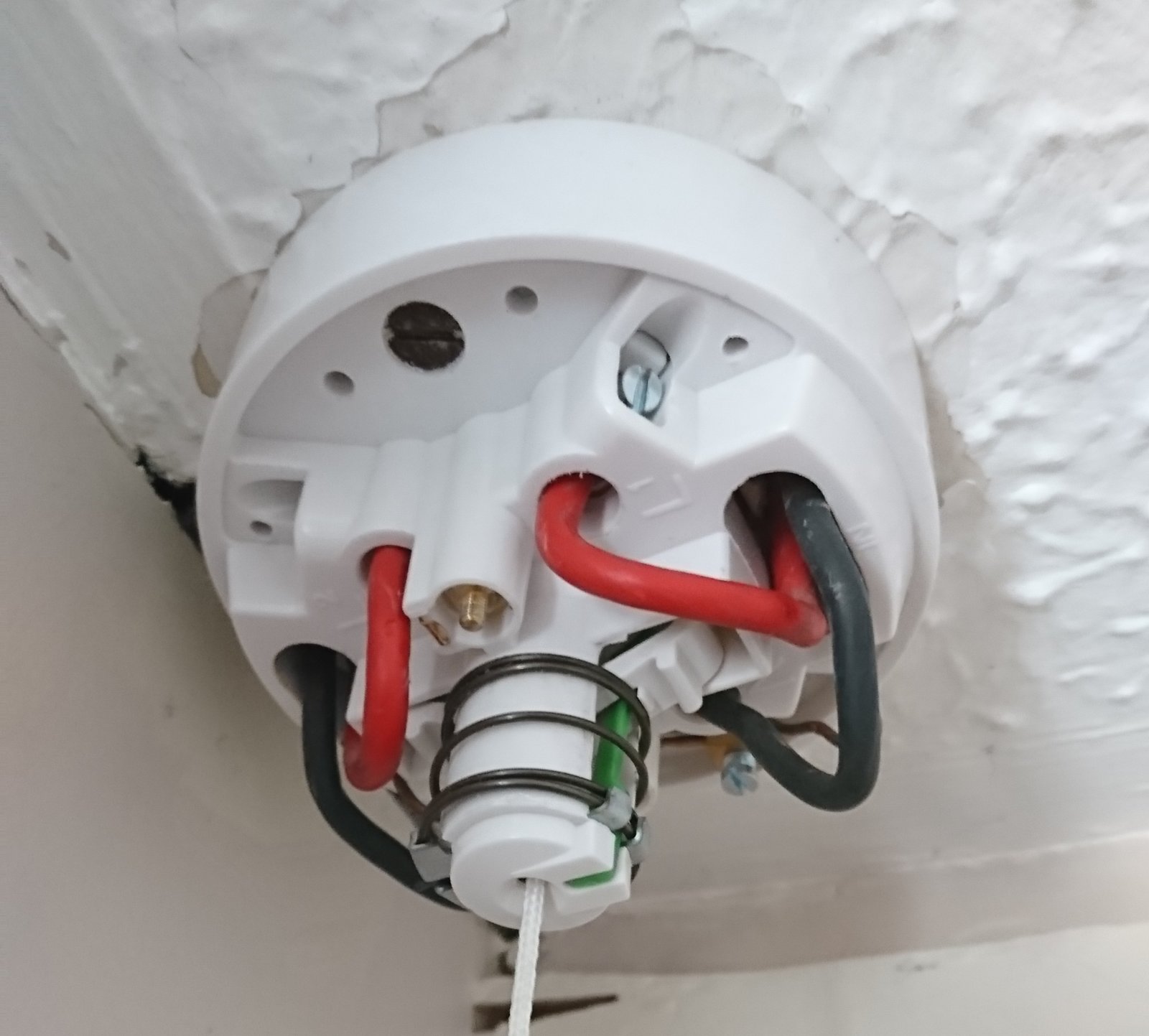

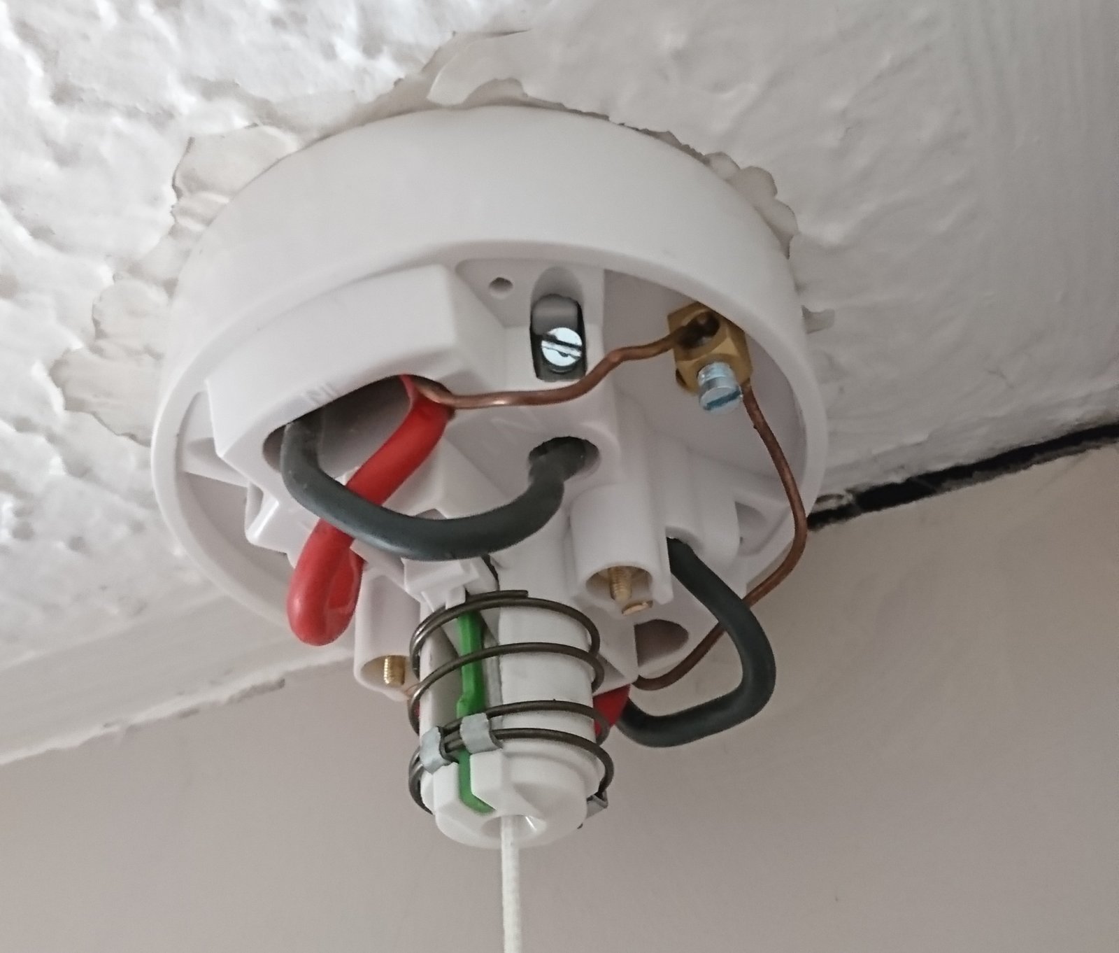

The Crabtree Shower Switch
Not sure if these pics will shine any light

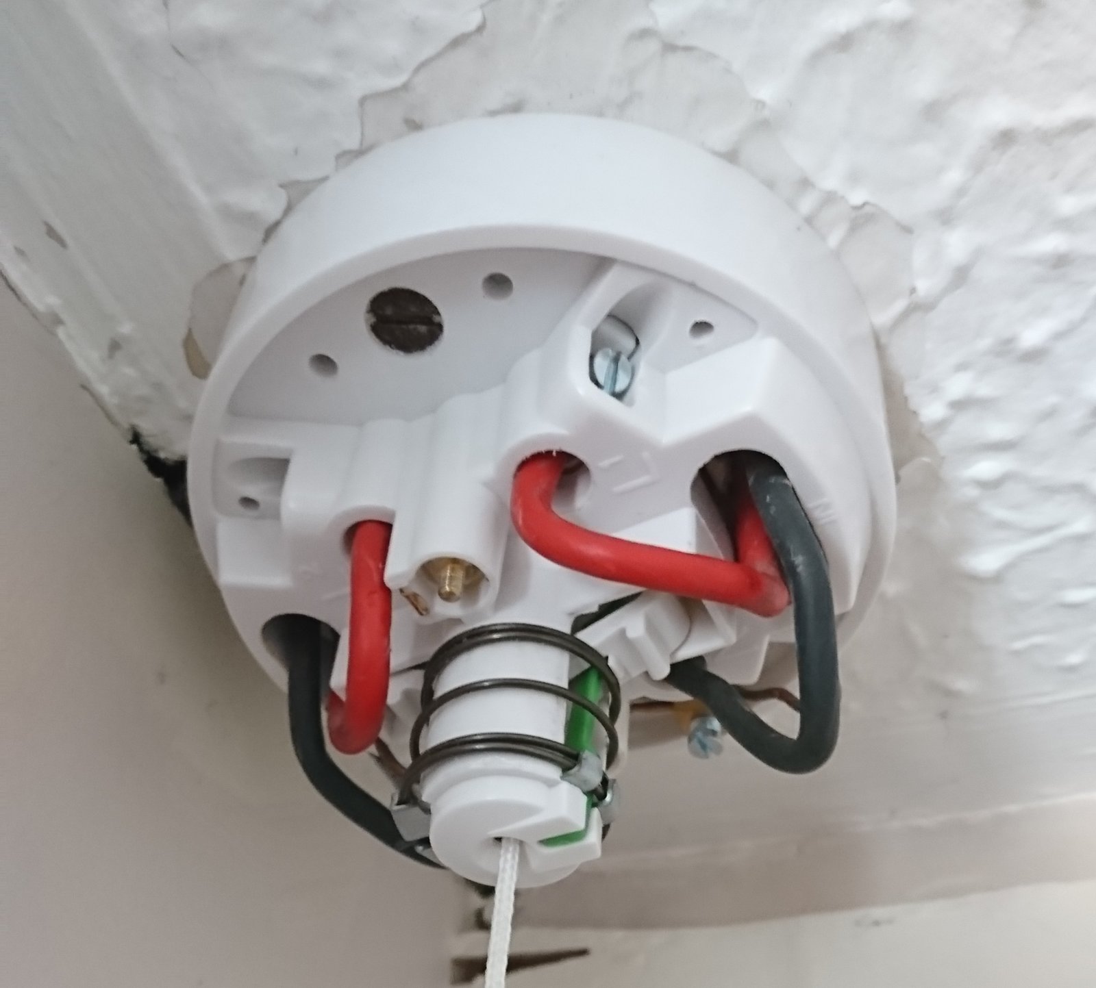

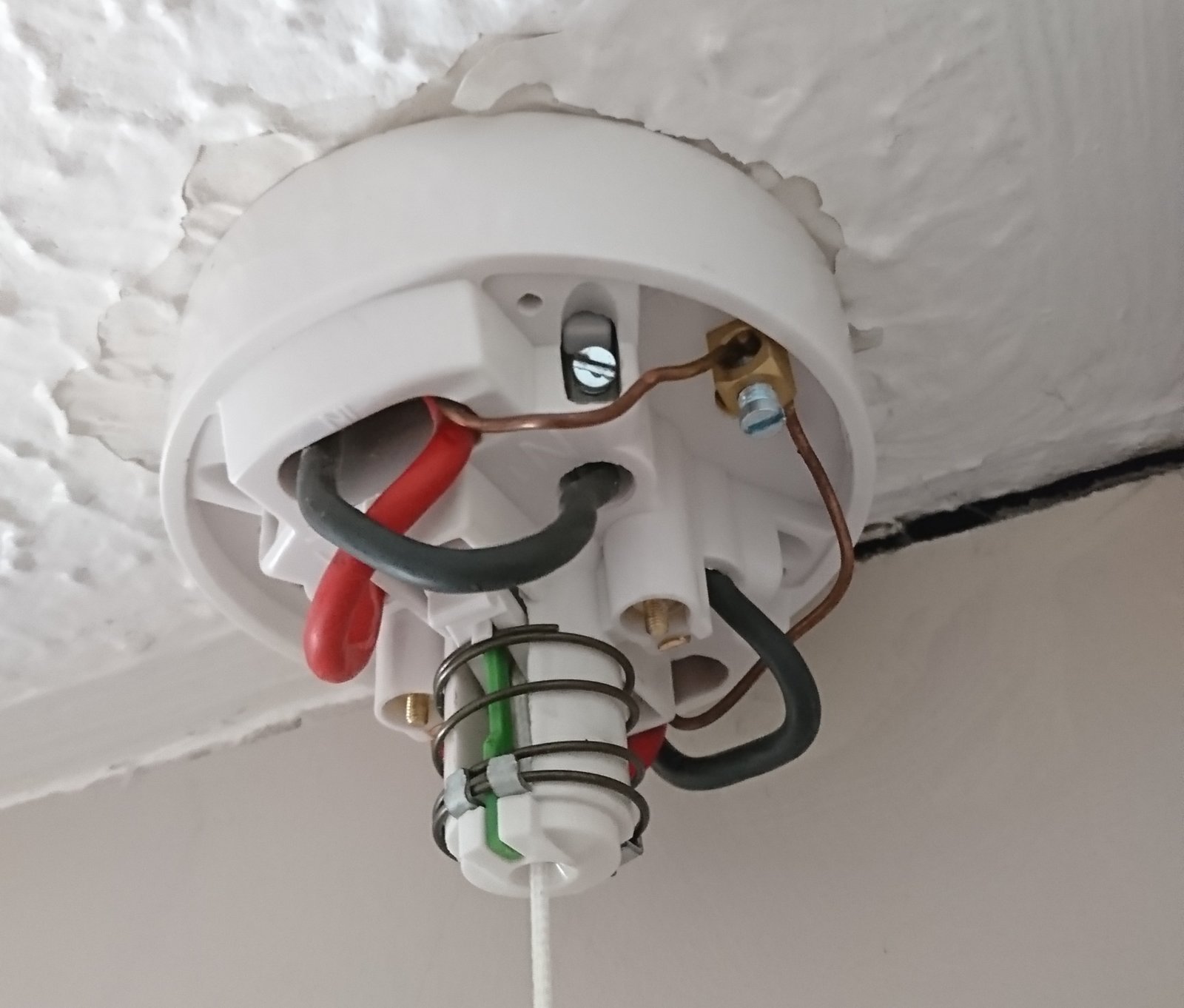

Just been up and the cabling to me looks sound. Checked it all the way from shower to isolator to supply cable. No kinks, breaks, scorch marks. I'm at a loss. Maybe it is tje fuse box. Maybe the cable from shower to isolator needs replacing. Looks like i need the electrician to return
Just had a thought. I checked the cable by looking at it, I'm definitely no expert as you all know.
The shower used to trip a lot, could this have damaged the cable in a way I could not see?
The only positive to come from this is the cabling is easily accessible to replace if necessary.
