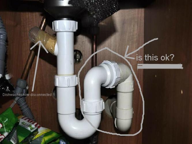

Hi
hope you can help. I have a bad drain smell coming through the plug hole from the kitchen sink. It happens after the water from the sink has been emptied. The trap is clear. I have cleaned the pipes but the smell keeps coming back. Is there an air lock causing foul smells to get through the trap. Do I need an anti syphon trap??. Please help. The pipes under the sink looks like there are too many bends!
many thanks
John

It might look a bit messy, but all those bends are required to ensure that the trap works properly - it should retain water at the bottom, which should (in theory) prevent smells from coming back out of the plug-hole.
This doesn't always work though - I had a similar issue with a similar set-up and no amount of bleach would stop the smells. It turned out that all the hoizontal pipes were almost completely blocked with fatty deposits. Presumably, the previous owners used to put a lot of their food waste/meat fats down the sink.
Have you dismantled all those screw joints and cleaned the waste pipes out properly ? Check to see if there is any fat build-up in the solvent-welded pipes too, further down the line. You might need to buy something you can put down the sink to shift that.
It might also be worth cleaning out the dishwasher adaptor and put bleach down the sink over-flow too, once everything is reassembled.

Asfor the smell from your sink i would go along with the overflow as your problem, needs cleaning.
