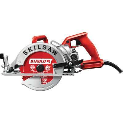

I believe the left hand blade position came about from the original Skil saw in the 1920s, oddly enough not what people in the UK often refer to as a "Skil saw" or simply a "Skilly"
If you want to be pedantic that is really a worm drive framing saw (and would be called a "worm drive saw" or s "Skil saw" in the USA where they were invented) as opposed to a conventional right hand blade directly driven blade saw (or "sidewinder" in US parlance)
There were a few left blade conventional saws in the past (Porter-Cable made them) but it was the arrival of cordless saws which seems to have introduced the type to the UK market (no idea why, though). The big plus for site work is that you can snap a chalk line and cut to it fairly accurately if you are right handed because you can see the cut line easily with the need to hang over the saw - the sort of thing which is handy if you are cutting Velux window openings in sarking boards on a roof, for example.

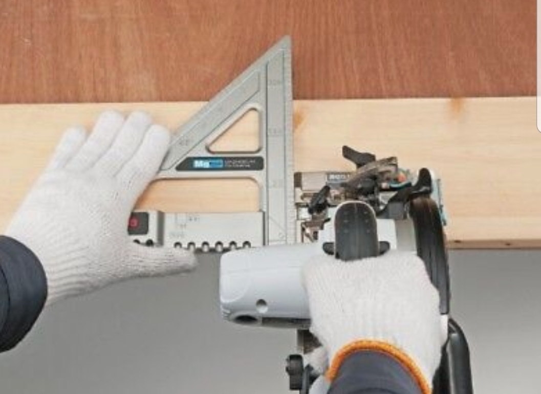

Or how about something like one of the Tajima circular saw guides such as

I don't really see the point of the Tajima at anout £55 delivered - you can get a non-metric 7in soeed square for undervs tenner, a punched alumimium metric 175mm model (e.g. Johnson or Hultafors) for £15 or so and the "King of Metric Speed Squares", the 250mm Swanson Metric Speed Square" (capitalsbecause they invented the speed square back in 1925). Frankly the 250mm square can't be carried in a tool belt pouch, whereas the 175mm and 7in versions can be
BTW, anyone notice the error in how the Tajima is being used? The way shown is fundamentally unsafe in a site environment
