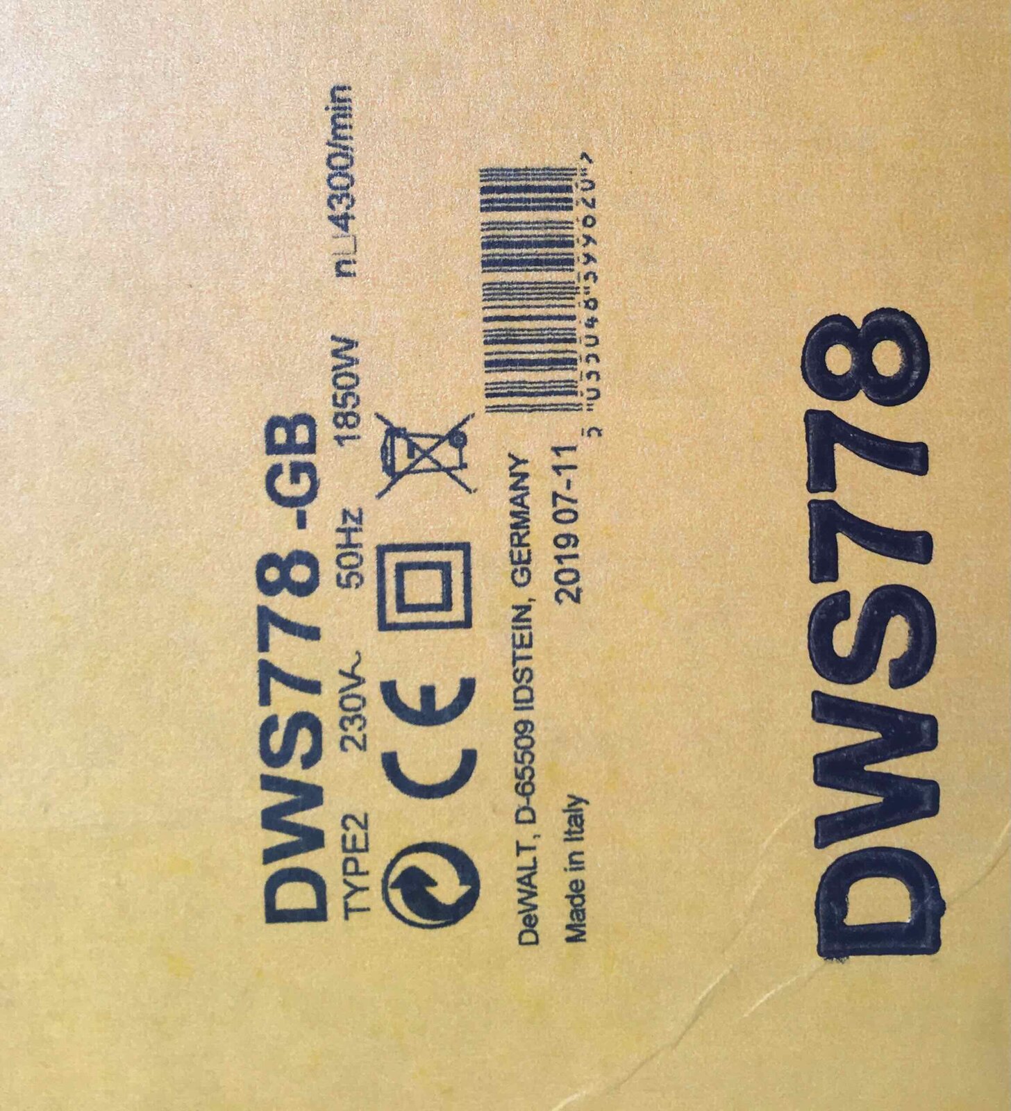

FWIW: DeWalt are owned by Black&Decker and definitely dont make their sms's in the USA - most of their power tool parts are sourced from most anywhere but mainly China, and assembled in the USA.
AFAIK DW mitre saws are designed mainly in Germany (Idstein), partly because the two main families of mitre saws are derived from the original Elu designs of the mid-1980s. Almost all the DW mitre saws I've seen in the UK in recent years were made either in Germany or Mexico. I think one of the differences with firms like DW and Mak is that they design the saws and the components and they do their own quality control as well as ensuring their designs meet safety standards, etc. I haven't seen any DW stuff made in China, but some of my Mak kit was made there (some is Japanese, znd some is eben made in the UK at Telford). Surely quality of end product is more about the standards of the manufacturer than it is about where it is made or where the components are sourced from?

my Dewalt SMS - was made in italy
No under where the parts may of come from or if just assembled in Italy
