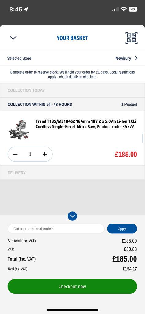

If you're looking to go cordless keep an eye on eBay as Screwfix were selling the trend ones for 185 and apparently there was alot of bulk buying so they normally pop up
Plus not a bad little saw

Thanks ETAF & gonch69.
