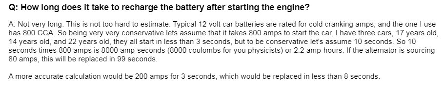

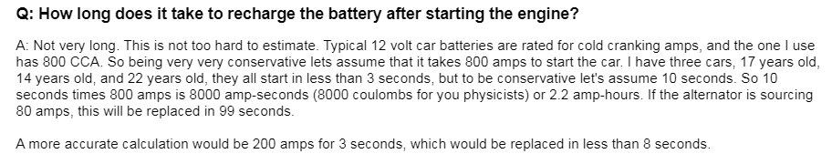

As to the link to https://www.powerstream.com/car-battery-faq.htm as you read down the questions and answers you get
Q: Should I add water to the battery before or after I charge it?
A: Add the water before you charge. The charging process will create bubbles that help mix the acid. The charging process, even with a completely out of control battery charger, will not consume much water during one charge. I should also mention that modern charging systems with accurate voltage regulations will not consume any appreciable water, and of course the sealed batteries recycle their water, so you can't replace it.
This answer is incorrect, as when a battery charges the electrolyte level increases, so topping it up before charging can result in it over flowing, as soon as you see one item you know is incorrect, you have to question the rest of the answers.
Not arguing; just interested.

Are you saying that the example in my link will take 27 (80/3) times as long as it states? 27 x 8 seconds = 216 seconds.

If the link has done the calculation at 80A and you say it might be only 3A then it will take 27 times longer.
So, how long does it take to replace the 600Amp-seconds draw?

Why 2 or 3A at 216 seconds? because the battery voltage rapidly rises to oppose the flow of current. The current flow graph declines very rapidly over a short time, unless the voltage is increased.

To replenish 600 Amp-seconds will take 600 Amp-seconds so if the alternator is only at 3A then it will be 200 seconds - not 13 miles (originally stated) nor 15 minutes.
