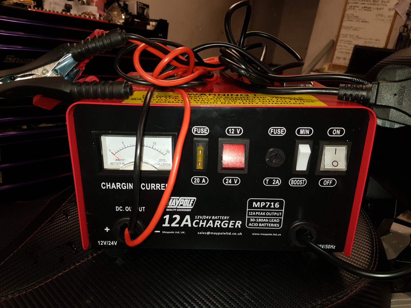

I use one of these at work, and bought one for home as well.
You can tell a lot about the state and health of a battery watching it charge with the ammeter.
Had plenty on for a full day.
