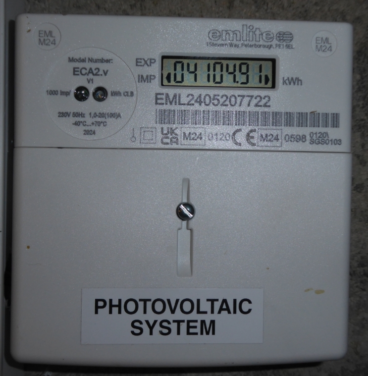

Hi,
We have solar panels, inverter and DC coupled battery. There's a "generation" meter Emlite ECA2 between the inverter and the house electrical system. The meter therefore registers everything coming out of the inverter whether that's direct solar generation or whether it's from the battery. Our meter just displays one register, as shown.
Data sheets for that model meter all either say it reads both import and export, or say it depends on configuration. I can't find anywhere that explains how to carry out that configuration. Does anyone know?
The reason I want to do this is we're going to start using off peak power to top up the battery during the Winter, and the meter as it stands won't account for that. We need to also measure power in the other direction, going to the inverter.
Ideally we'd have the version that shows import, export and net. If necessary that's what I will do. But it would be better if I could reconfigure the existing meter, to saying buying anything and reduce any chance of warranty issues from modifying the installation.

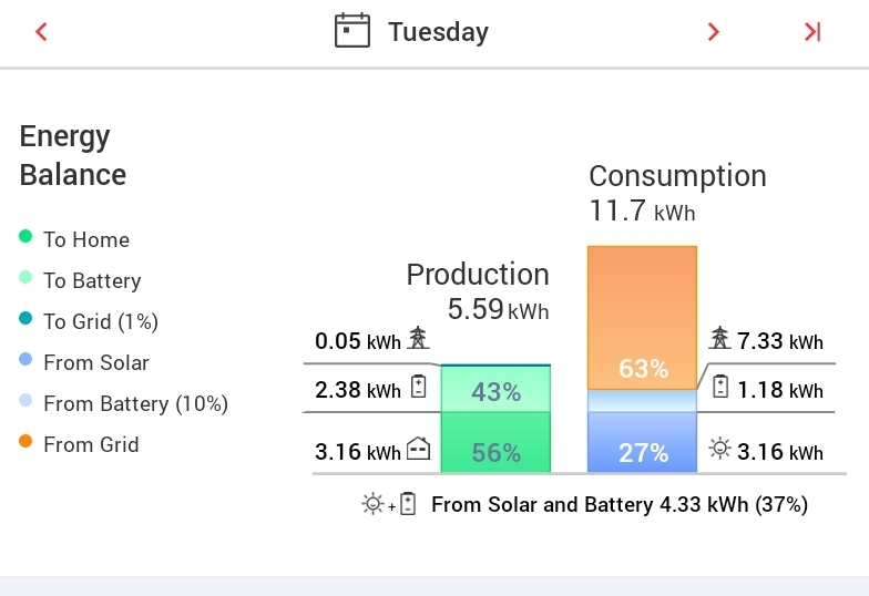

Thanks. It's Solaredge and unfortunately it gets it's figures hopelessly confused by the battery, particularly if the battery is ever charged from the grid when both the meter and Solaredge count battery discharge as if it was solar production. If I don’t do so then the meter gives a correct value for production, give or take

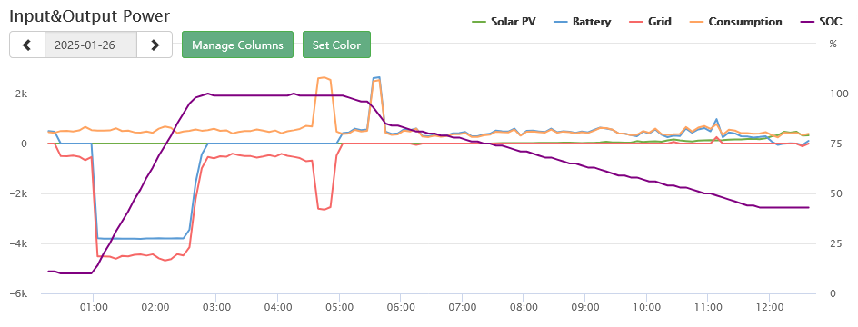

I'm not sure why it's hard to believe when I say the Solaredge app doesn't give accurate figures but here's an example. On that day we actually imported near to 19kW as I charged the battery overnight to ride out the price spike the following day.
You can see it's registered only the import that it thinks went to the house, not the energy used to charge the battery. Next day it registered 0.5kWh import which corresponds with the smart meter, but the balance, most of which came from the battery, is mostly shown as solar production.
Back to meters this is what the data sheet for our existing meter says ..
"The meter provides measurement of active (kWh) energy in both import and export directions with registers shown on the large easy to read LCD display. The display features 8×3.5mm characters and can be configured to auto cycle
any of the available registers or remain static with only a single register viewable."
Mine works as described at the end, a single register viewable. I've emailed Emlite to see if they can or will provide information on how to reconfigure it. I have a suspicion it's not user configurable, but it doesn't quite make sense for it to be factory configured either.
Fall back is that I can get an Import/Export/Net meter for around £25 and should be an easy swap.
Thanks, the answer from Emlite is that it's not possible for me to change the configuration. They've recommended replaceme to with the Import/Export/Net variant. (In fact they said that it's mandatory and the installer should have fitted that model, but I think that really refers to batteries retrofitted to systems registered for FIT, which ours isn't)
