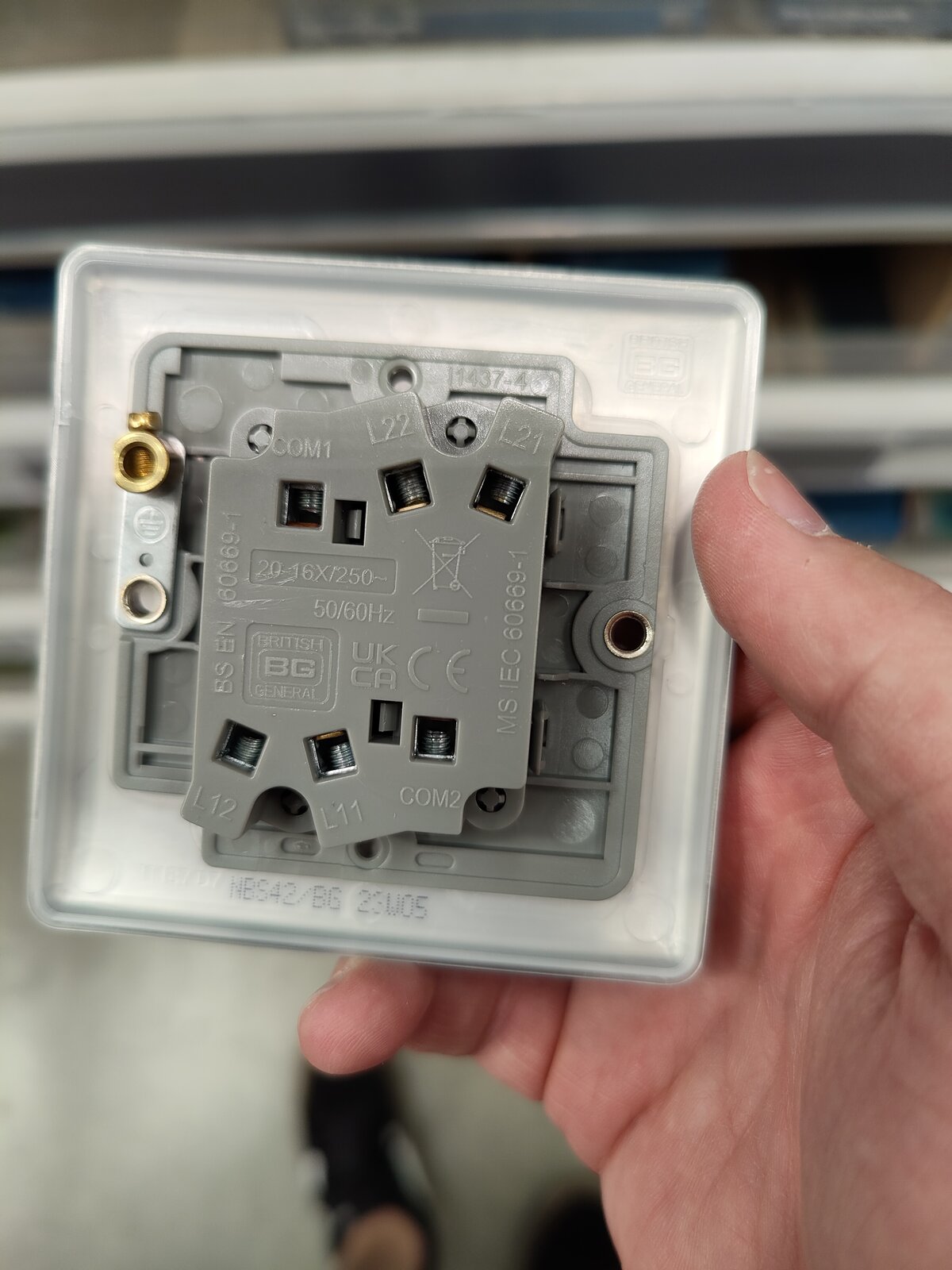

The issue I'm having is transferring the wires from the old switch into the new switch as the terminals are marked up differently.

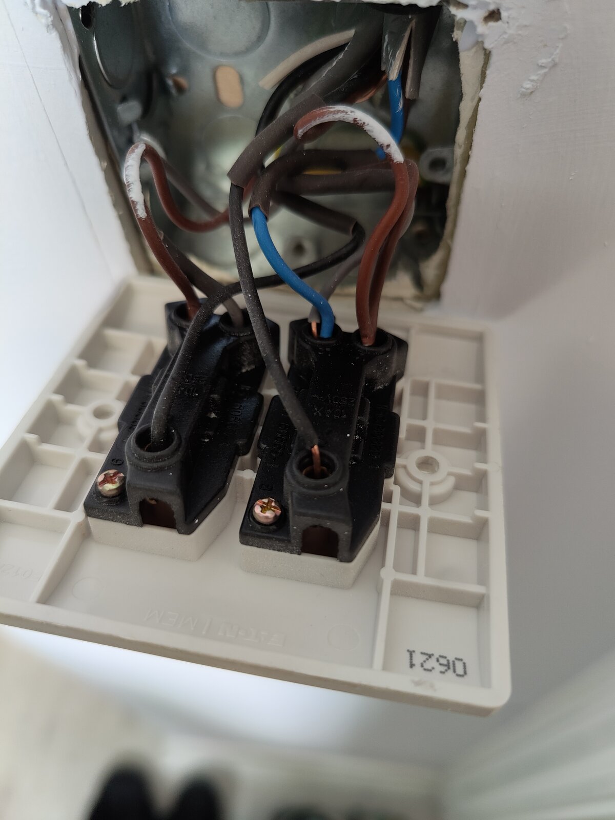

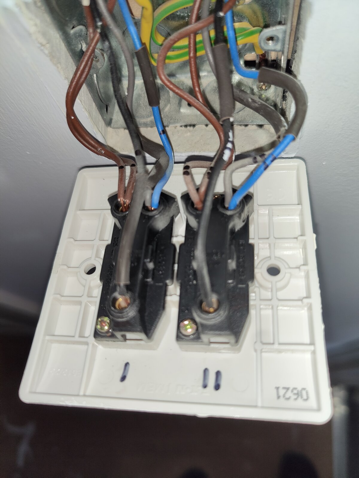

Old switch: com X2 - black wires with black sleeve
L1-l2. Then another L1 L2
The new switch is com 1, com 2, l11, l12 ,l21, l22
I assumed l11 and l12 was old L1 and L2
And l21 and l22 was other old L1 L2
But this setup keeps tripping the RCD
What configuration do I need so that the new switch wires up and works like the old?

Old Front door double switch∆∆
Old Top floor double switch
New switch setup to replace both

I understand that thanks, but there is no L1 and L2 terminals on the new switch. The terminals are, l11,l12 then l21 and l22

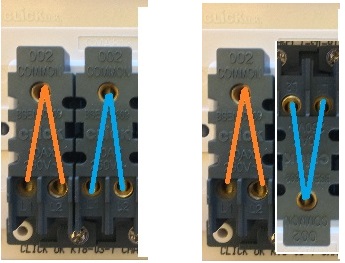

Well, if you understand the two triangles then what difference does it make what markings are used?
They have made it easier for you by marking one switch 1 and the other 2 with the appropriate COM, 1 and 2.
COM1
L11
L12
COM2
L21
L22
When you say it trips THE RCD, are all the lights covered by one RCD or are the three lights on different circuits and two RCDs trip?
I think the only thing that would cause an RCD to trip is - if the lights are on different circuits - and you have mixed up some wires.
Either the COM wires in the picture which look the same - or
some of the wire couples but that would be more difficult.

This resolved it thanks, the com 1 and com 2 explanation made sense. I labeled the wires up marker pen to identify which was from switch 1 and switch 2
