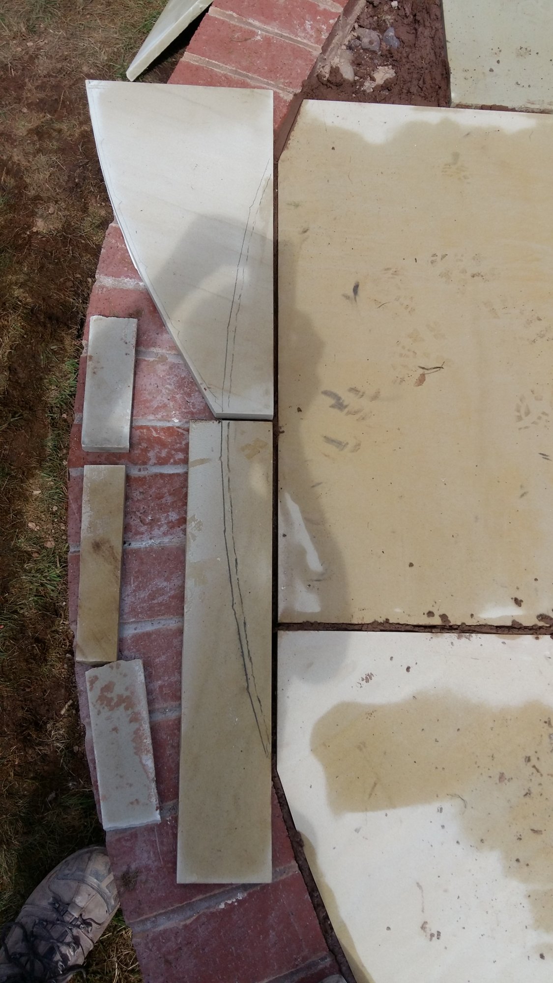

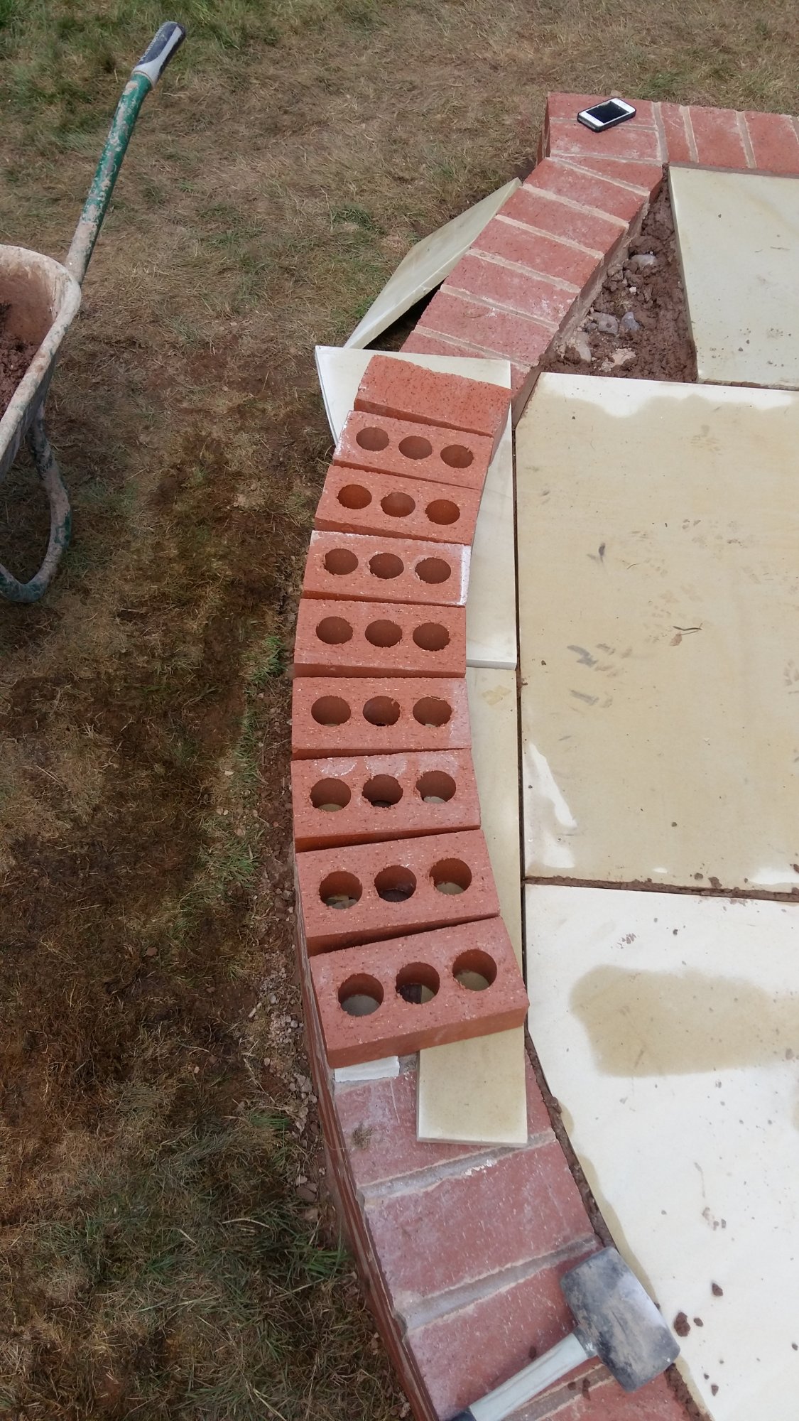

Have you ever had to lay a curved wall?
Out of all the trades I do, bricklaying is the one I'd say takes the longest to learn and is the most difficult to do well. Your patronising attitude smacks of extreme naivety and ignorance. Bricklaying and patios are not all about straight lines.
Lovely work, you should be proud. I'm an enthusiastic amateur, I've built a few garden walls, but I know my limits and will stick to straight lines until someone invents curved string.

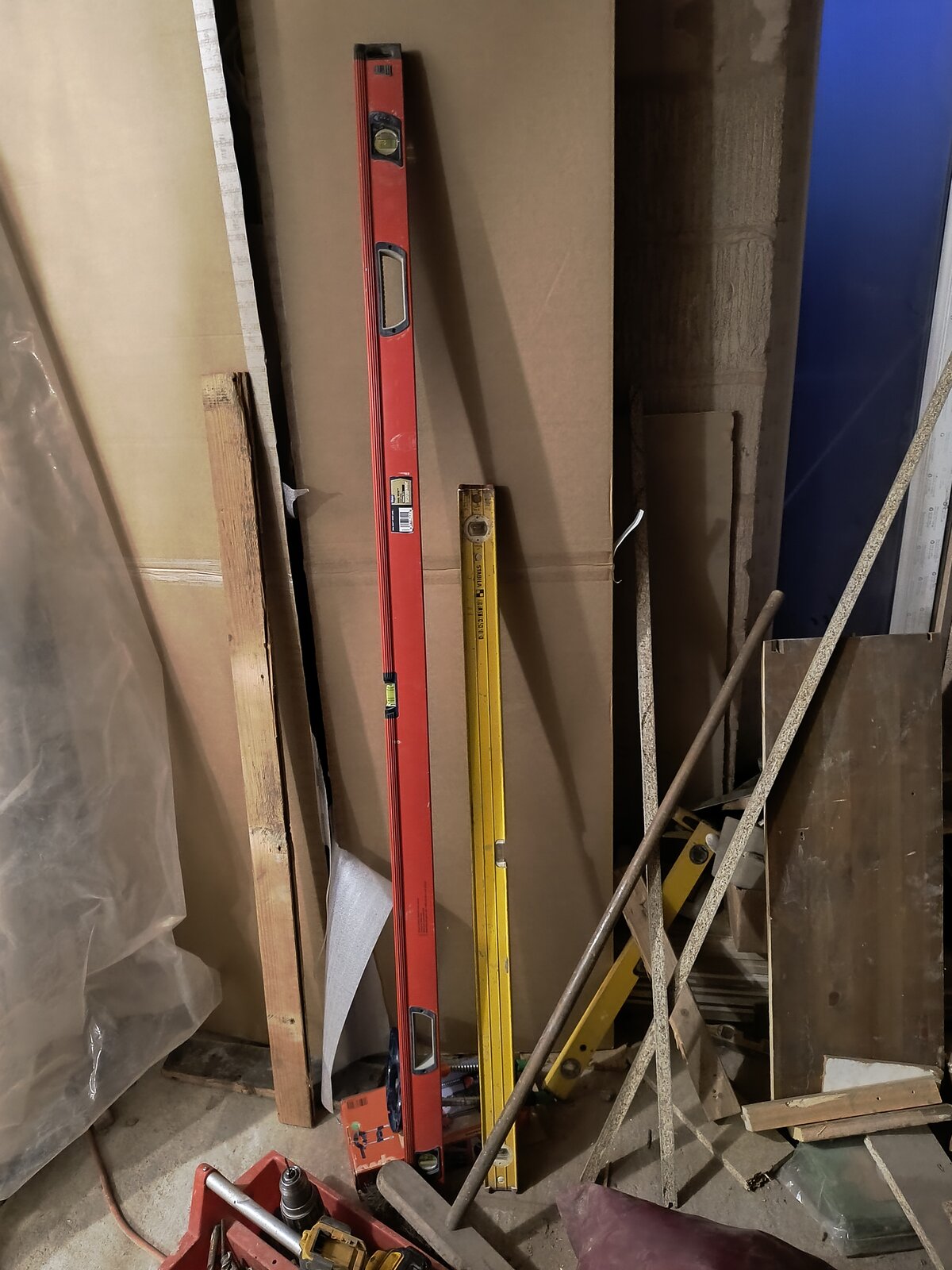

My big level for internal levelling/plumbing of beams, frames, setting out etc is a Fatmax XL1800mm. It's bloody heavy but oddly, much easier to handle than the previous light Stabila and does not get easily knocked or blown over or slide about. Bubbles are very easy to see from all directions. Only downside is the bubble water has faded to clear after a relatively short period of time (less than 10 years) and it's not been in the sun much.
If I was buying new levels now for internal setting out, I'd get one's with illuminated bubbles.
