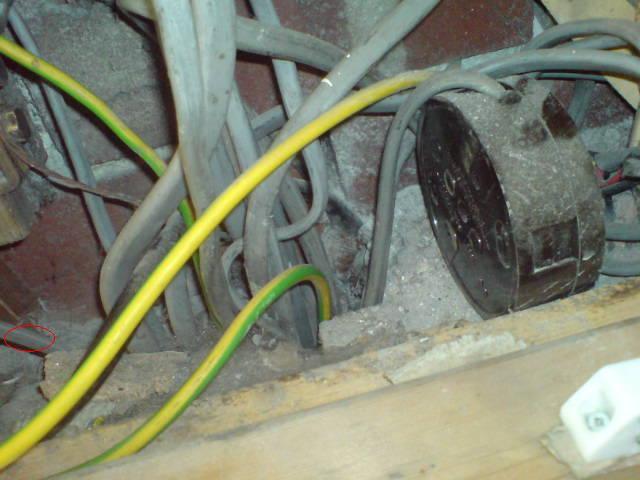

In the spirit of the World Cup, please place an "X" where you think the TN-S supply comes in in this picture:
RF: No, sorry!
Gregor. No, not grey. But it's tricky to distinguish colour because everything is covered in years of mortar dust...
I reckon it is that bit of unshielded mucky wire bottom left going from some sort of block down to the bottom of the screen!
