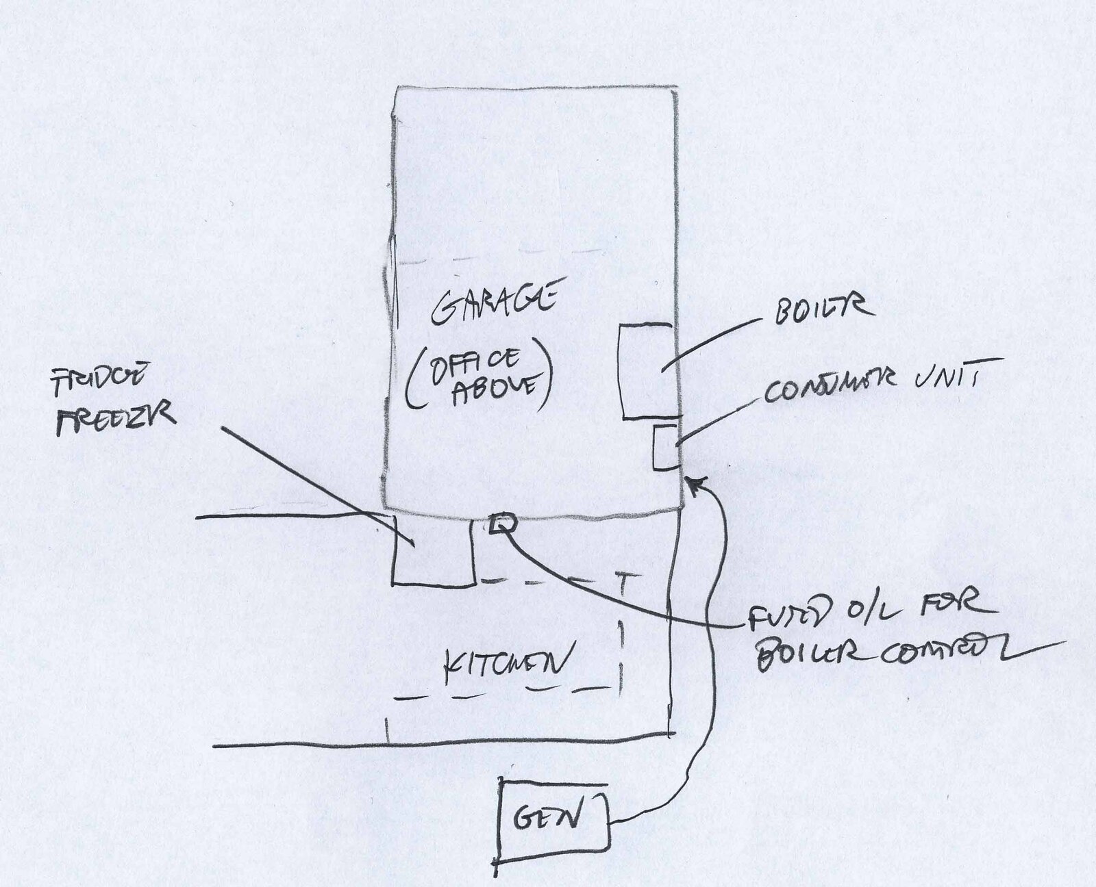

The generator is a suitcase/inverter type and is floating neutral as this type usually are. It is normally used to temporarily run power tools and the like, and these tend to be double insulated anyway. It has an earthing point on it if needed, for connection to say, a local ground spike I could install, but it's not something I've had to consider to date - and to be honest, my thinking hadn't got past the price of the switch. I'd like to be able to get things powered without having to run extension cables through open doors/windows too.
Below gives you an idea of the layout where our garage is built into the house, and the three items I'd most like to get on the generator effectively face onto the garage which is handy.
1. Fridge freezer (normal 13A plug/socket)
2. My home office which is the bedroom above the garage, so the UPS up there can charge back up from the generator (UPS is relatively small so the re-charge load isn't that bad)
3. Boiler (unfortunately not on it's own dedicated feed - it is a fused spur off one of the rings in the kitchen, leading to the controller a few feet away)
If earthing is an issue in this sort of configuration, putting a small consumer unit in the garage on the end of the generator input, and having a couple of extra generator-only sockets in my office and kitchen for 1&2 above would certainly be straight forward to do, and maintain complete separation earth wise.
If I wanted to include the boiler, I guess it would need its own dedicated feed putting in, and a plastic cased 3 pole changeover 20A switch to allow L/N/E to be switched to the generator supply. Only problem there is I'm not clear without checking what the boiler and pipework earth setup is - and whether there could still be a path back to the DNO earth somewhere.
I guess my question is what is the normal way of properly wiring a generator in when you're not out in the sticks with a TT earth anyway (which the generator could also be connected to). I wouldn't have thought this requirement is particularly unusual.

My main point is fitting a stand by generator is not a simple follow a set of instructions, one has to do a risk assessment, and decide what is needed for that installation.
The easy method is a small consumer unit with the essential services which is plugged into to a supply from the main consumer unit, and to switch over you unplug from main consumer unit and plug into generator instead.
