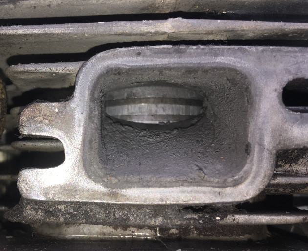

Here we go.
The inlet side is smooth but exhaust side has some marks.
Using my finger through the port it doesnt feel rough etc

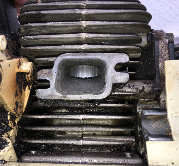

I also noticed that the exhaust side didnt have any kind of gasket between cylinder & exhaust,maybe this also helps you
At an initial glance that piston seems to be badly scored.
There should be a compressible gasket between the cylinder and exhaust.
Pattern pistons and cylinders are available for a good price.
John
There was no gasket betweenctlinder & exhaust.

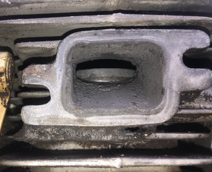

Photos of top of piston as requested

So do you advise a piston with rings ?
If so I need to get things ordered so so I just order the following items.
Piston with rings.
2 crank oil seals.
What do I use for a gasket sealer when I split the case.
Can I use Instant Gasket ?
Please advise on the above so I can order items.
Thanks.
The barrel is likely to be in the same state as the piston, so maybe budget for both?
The crank seals are best replaced with bearings.....feel for any play first. Oil seal failure will be evident by oil on the outside.
Use paper gaskets for the crankcase ( if you split it), same for the barrel base, plus an exhaust gasket too.
To shift the piston from the con rod, heat it up hot with a hot air gun and the gudgeon pin will slide clean out.
Don’t lose the circlips into the crankcase!
John
