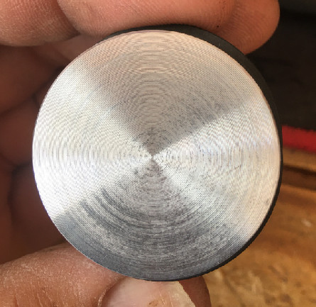

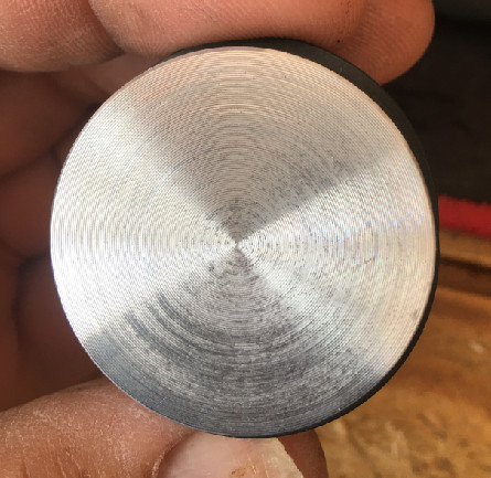

well it definitely needs piston and rings, will the cylinder clean up of alloy transfer or require new as well.
Any reason why you've stripped it so far?
I think it will be ok with some emery paper.
What do you advise with regards selant for the cap when i put it back together
Don’t use any abrasive paper at all.....the cylinder is plated and it will end in tears.
Use a universal silicone sealant to reassemble, the original would have been orange in colour.
New piston and barrel required.

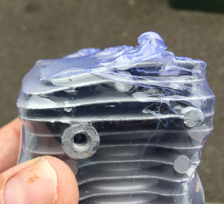

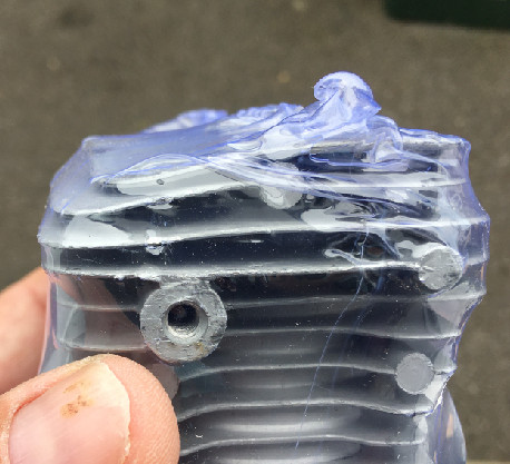

Parts have arrived BUT

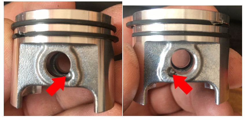

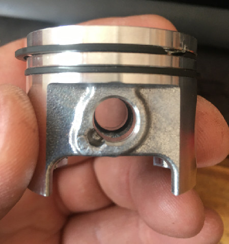

The top 2 fins etc have bent in transit,it doesnt seem to me that its a problem but what do you think ?

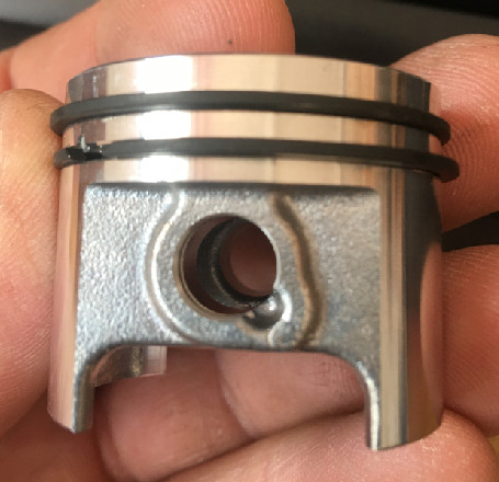

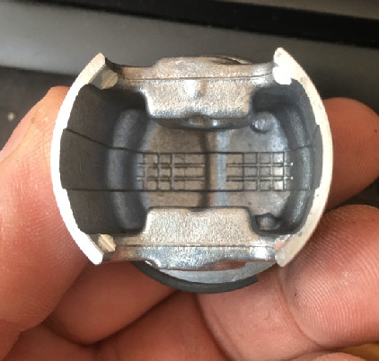

Also ive been reading that the piston should have a mark on it for which it faces say exhaust side but the piston received has no markings so what should i do in respect of which way round should i fit to con rod.

You could bend those fins straight but it’s not a good start!
Compare the piston with the old one in respect to the ring pegs and therefore orientation .....the ring ends mustn’t click in the exhaust or transfer ports.

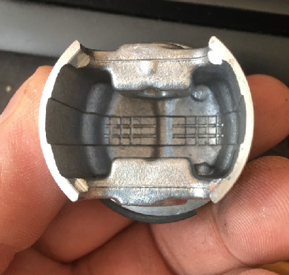

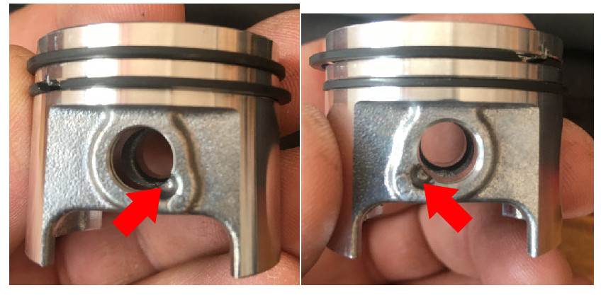

Ring pegs ?
Ive fitted the rings to the piston & aligned them with the little pegs in the groove.

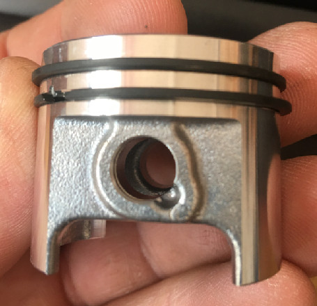

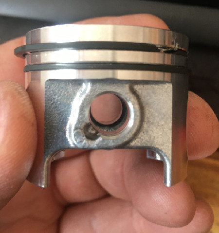

Ive heated up the old connecting pin & removed it, I then fitted the new pin, I did notice when you go to put those wire clips either side of the pin they face either forward or backward, As shown in attached photo
So i fitted this piston to the con rod the same way.
Using 2 stroke oil i put some inside the bore & also on the rings then popped the piston into the cylinder.
I can turn the crank & the piston moves up & down freely.
Does this sound correct ?
Awaiting sealant to arrive so i can fit the sump on correctly.
Yes, those pegs prevent the rings rotating in their grooves......if they did the ends would catch in the ports and break.
4 stroke engines don’t have these.
Everything else seems just fine.
