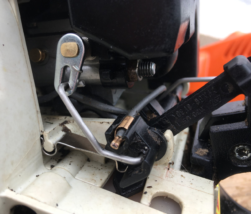

Hi,
Saw all back together & started after a pull or two but when i moved the lever it wouldnt switch off.
Looking at the supplied photo can you see what ive done wrong.
The copper terminal with the wire needs to earth out on the bright throttle rod to turn it off.
It may just need pushing out of the clamp a little.
John
I had the spring wire piece the wrong side of the plastic choke rod.
Now when I operate it the two touch & engines dies.
