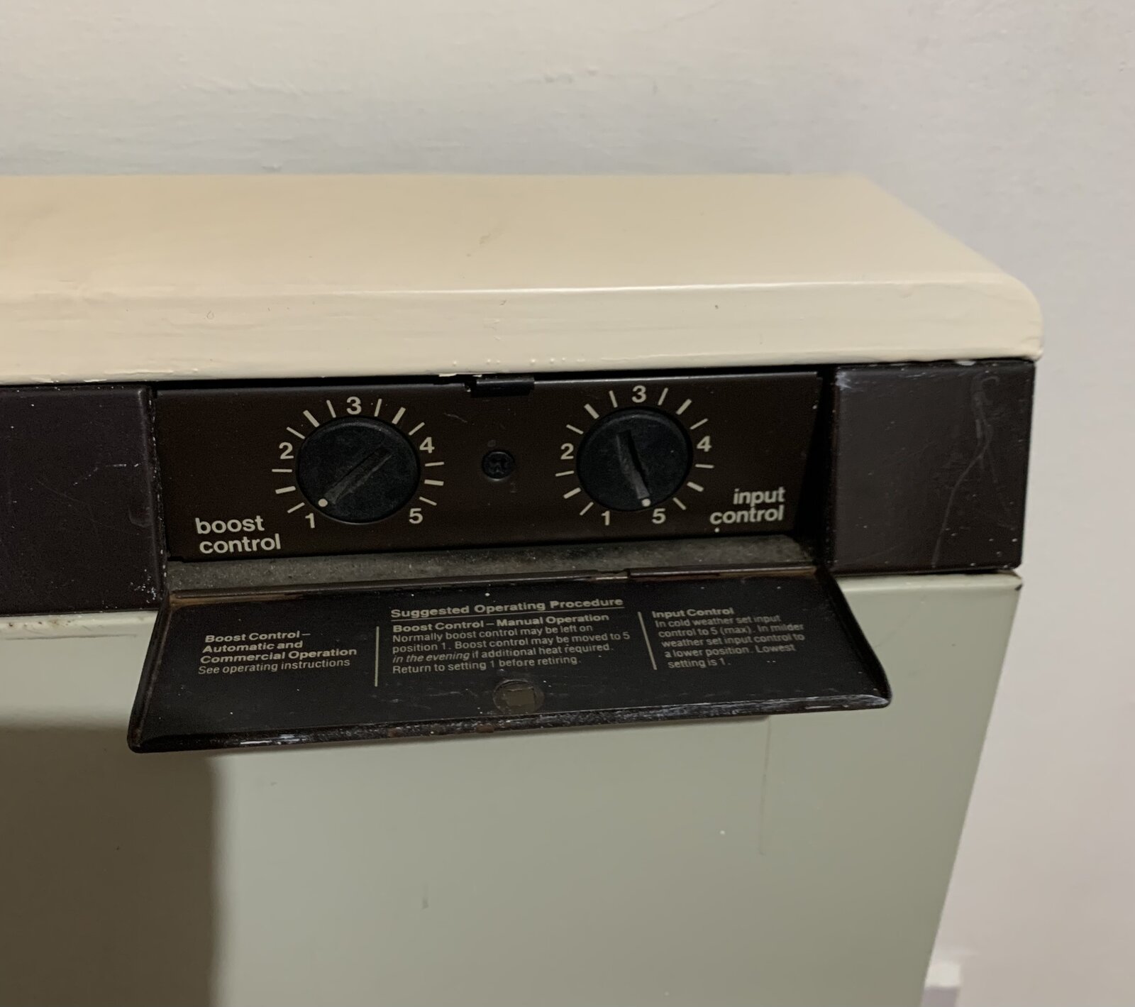

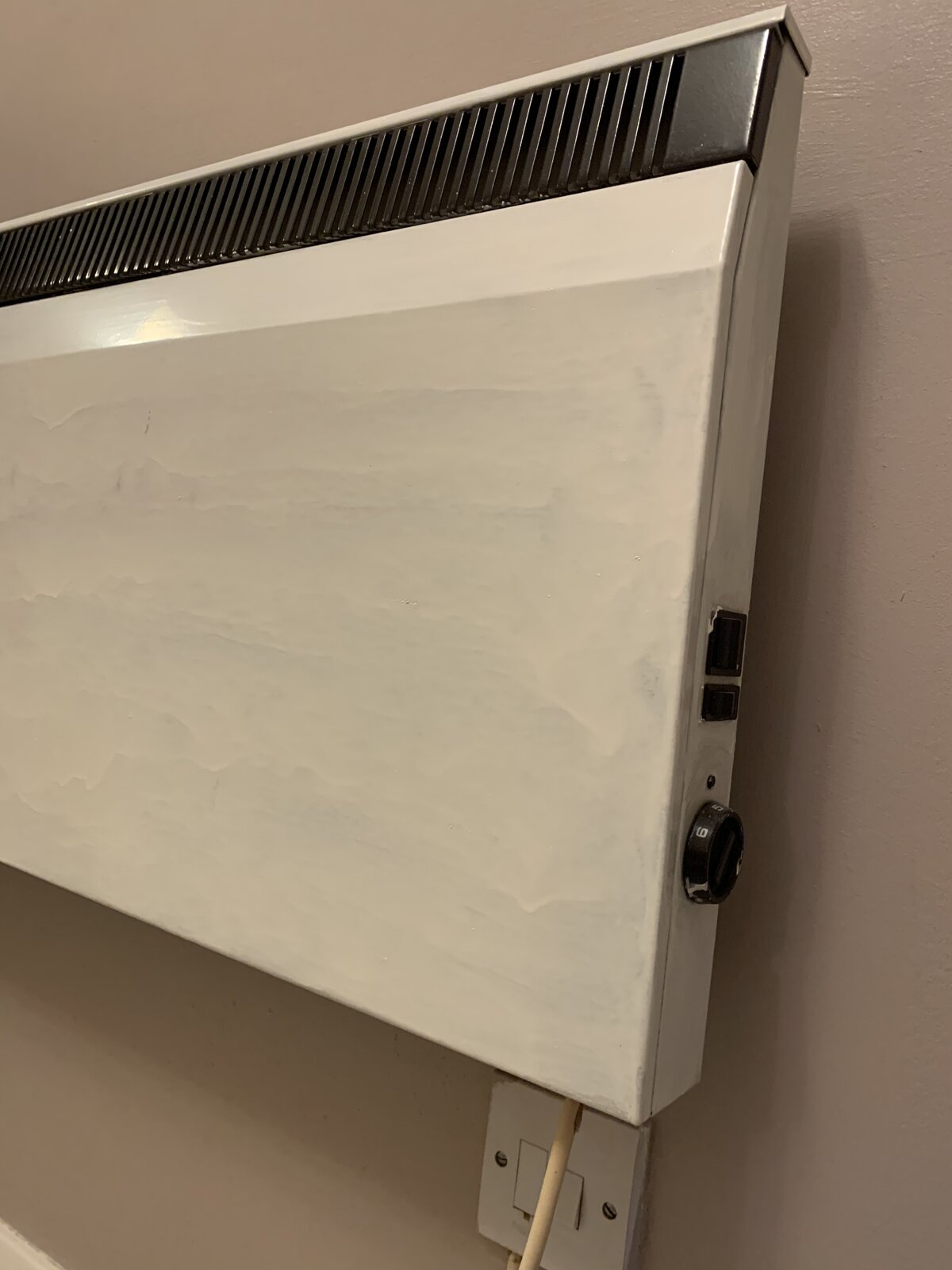

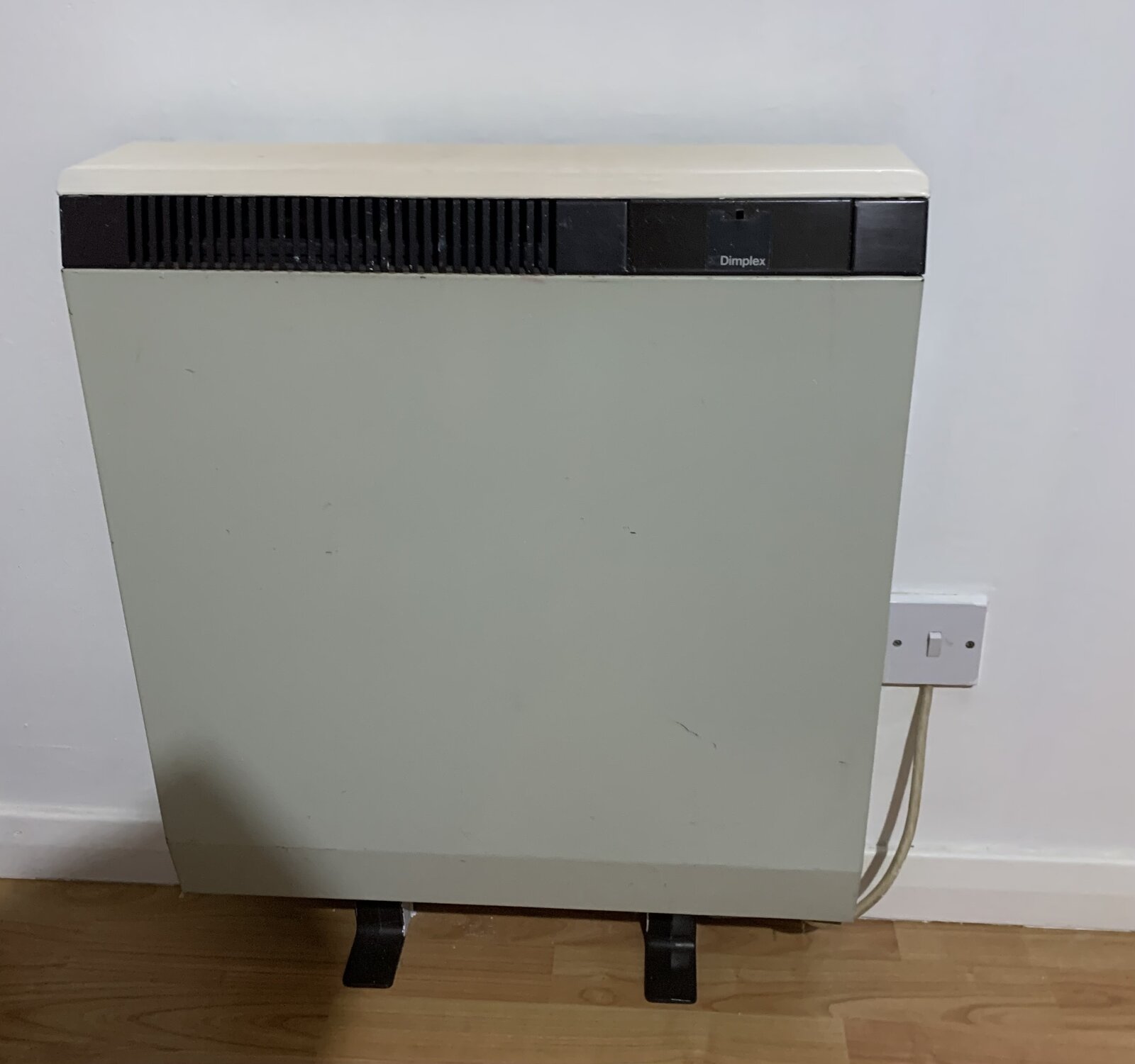

My Economy 7 tariff currently has off-peak hours from 1am to 8am. However the switch connected to my storage heater is currently set to turn on between 12am and 7am. How can I make adjustment to the timer, if there is one (no idea where please someone advise) to suit my Economy 7 tariff, off-peak hours timeframe
Dimplex XTC see photos. Don’t think there is a timer, I couldn’t find it. Anyone know how the timeframe being set? Please advise.

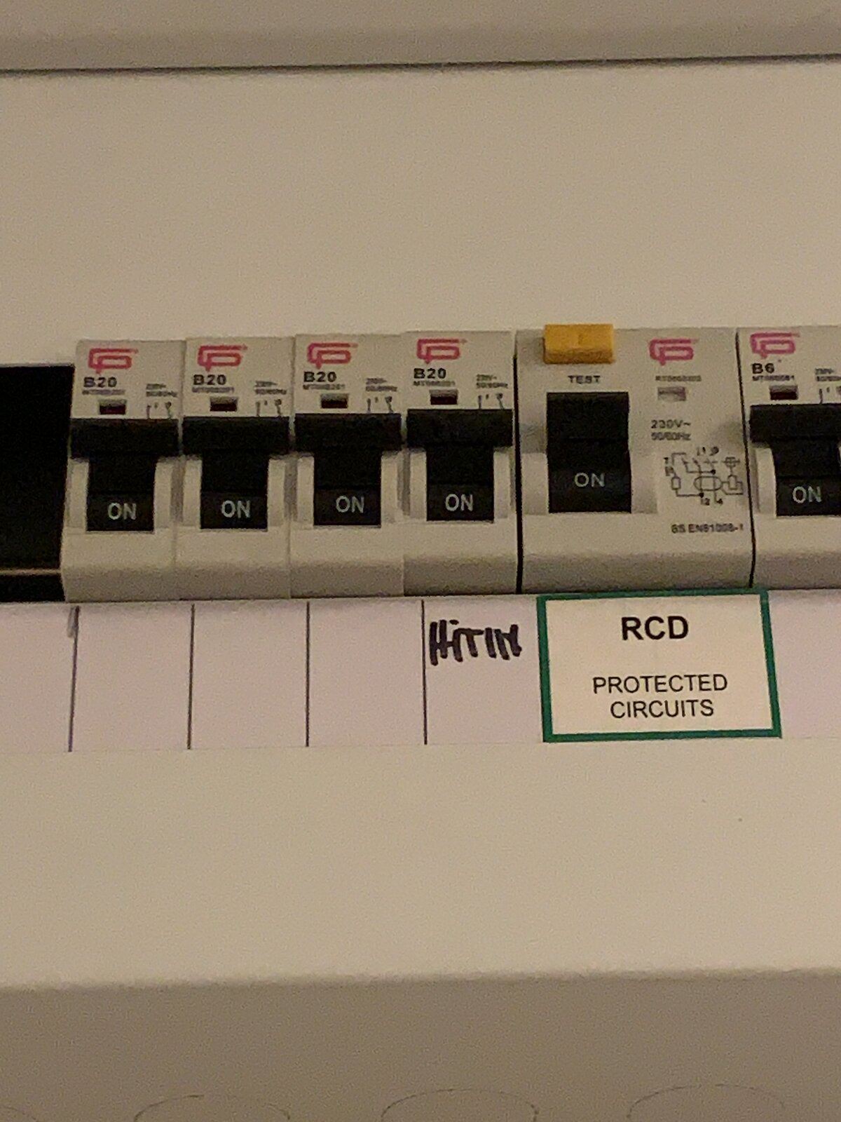

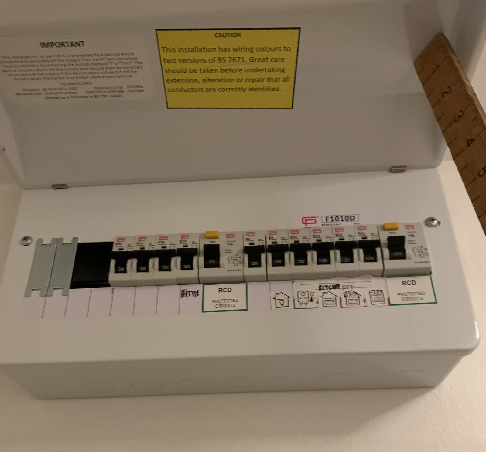

There must be a bit more. Is there another fuseboard? Show me the meter and anything connected to it.
The photo of the consumers unit is too blurry to decipher, and most of the breakers do not have description labels, so hard to comment on that.
See closer photo of the left side CU, those 4 MCBs are connected to my heaters, 3 out of 4 are storage heaters and the other one is a very old simplex wall panel heater (not a storage heater, see photo) which can be turned on/off anytime. Storage heaters only turn on between 12am to 7am. Not sure if there’s timer somewhere, Any idea ?

I have looked at all the pictures, but non show "the switch connected to my storage heater is currently set to turn on between 12am and 7am." @Taylortwocities has had a guess as to what may be used, but we have not seen if this guess is correct.

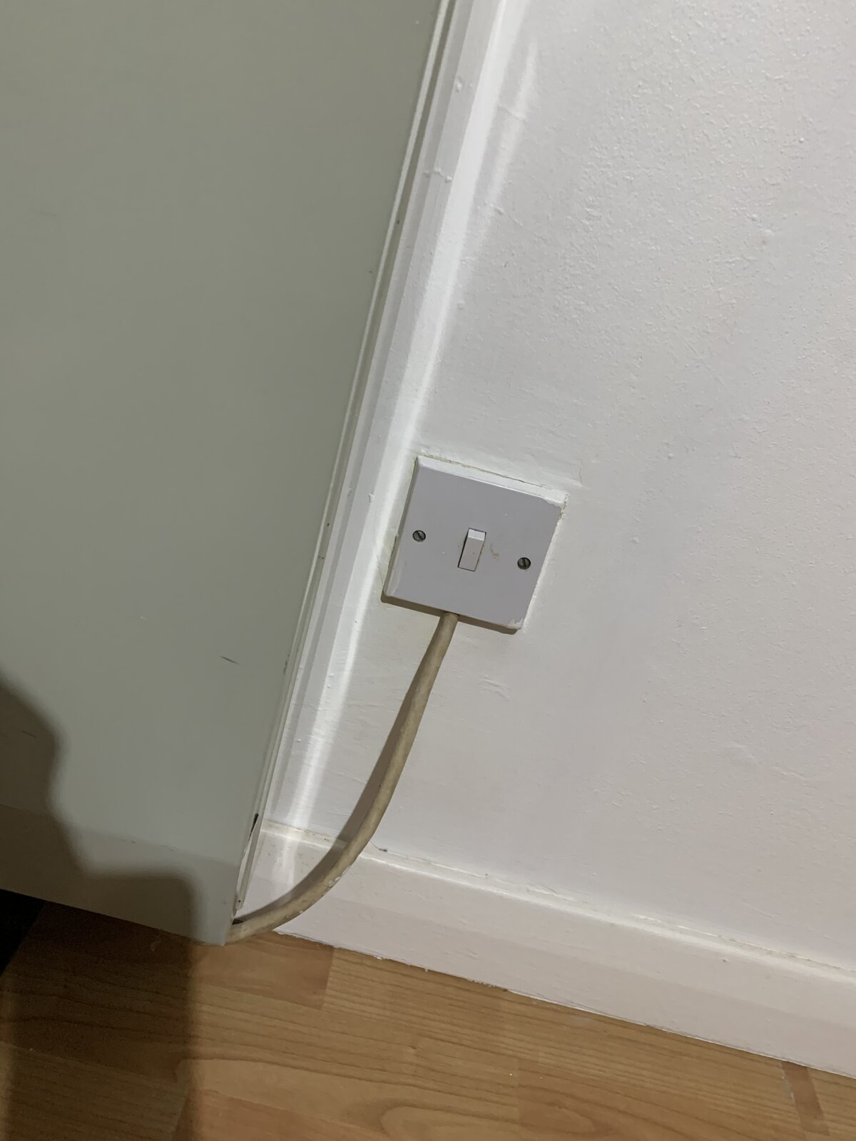

It's a switch which can be switched on or off - no settings.
How do you know something turns on at 12 if the power doesn't turn on until 1?
Because last year i replaced one of my storage heater with a wall panel heater, and replaced it switch with a 1 gang 13amp wall socket, I can only use that new 1 gang socket between 12am and 7am, cause it won’t work outside of the 7 hours window

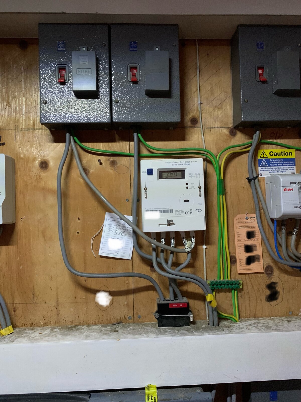

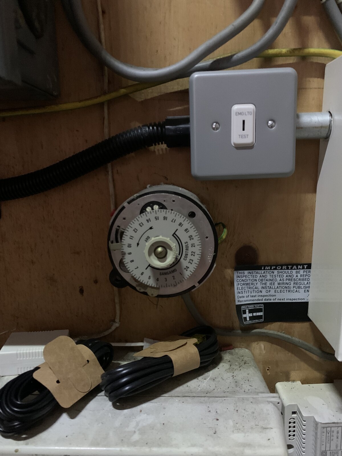

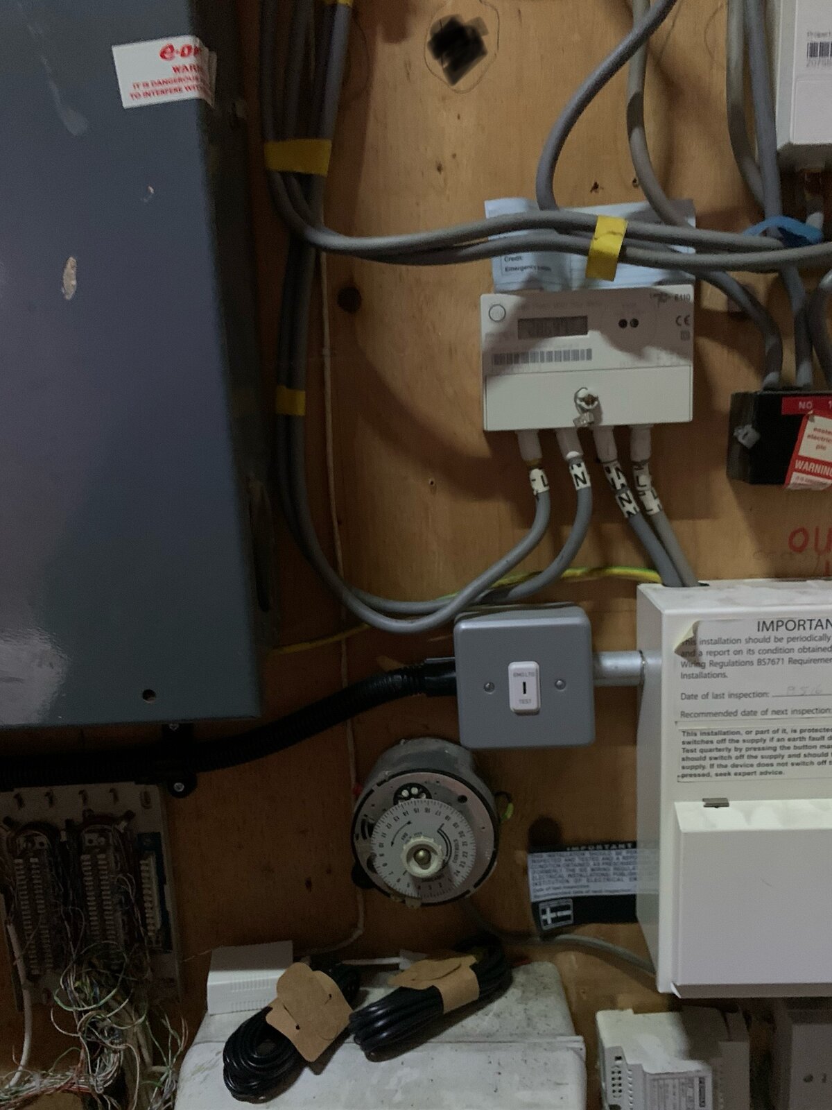

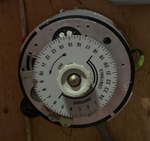

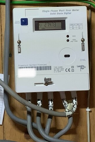

See attached, I have taken more photos from my meter room, found something looks like a timer but no sure if it is for my flat. I tried to see if there any cables from my meter connected to the ‘timer’, but found none.
Please advise.

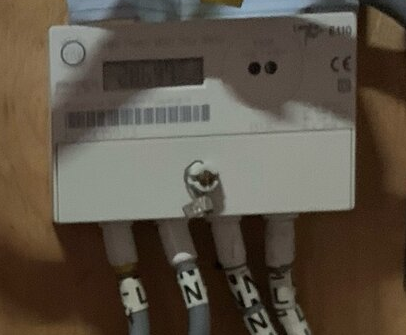

This meter 1729153209251.png with 5 cables, switching done in the meter, this meter 1729153315002.png no switching in the meter, this 1729153415825.png is a 7 day timer, but seems unlikely to have anything to do with storage radiators. When I look at the smart meter app, it has two options, kWh or £, it is clear comparing the two, most of my electric is off peak.
Since we don't know which meter is yours, can't really be 100% but seems likely all done in the meter.
