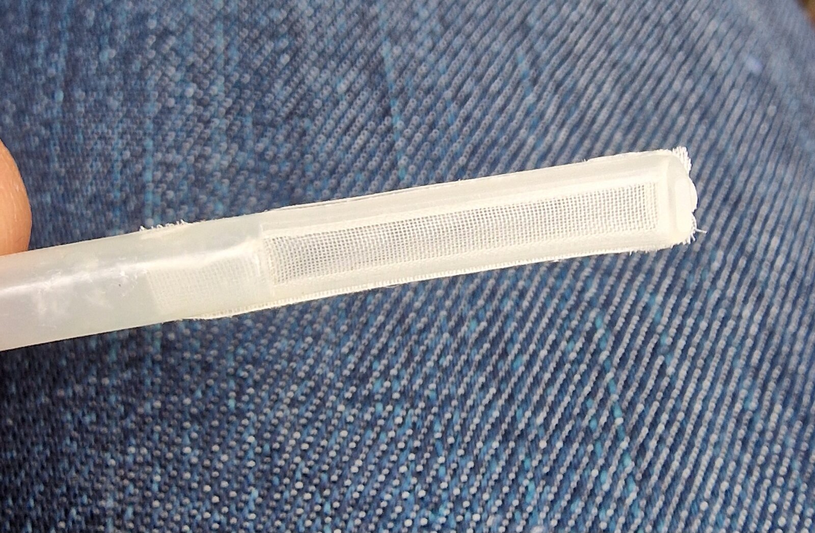

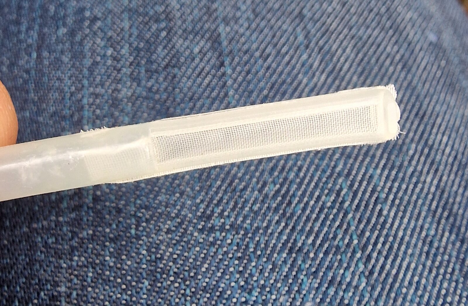

That looks to be the sort of device that sits in the fuel pipe itself - in Stiga fashion. Pull it out and see what's in there.
John :)
Looks totally clean to me but there was a tiny bit of grass on its outs when I pulled it out. Wondering if there's more at the bottom of the tank

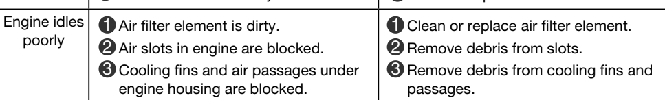

The manual has this advice but they seem clear.

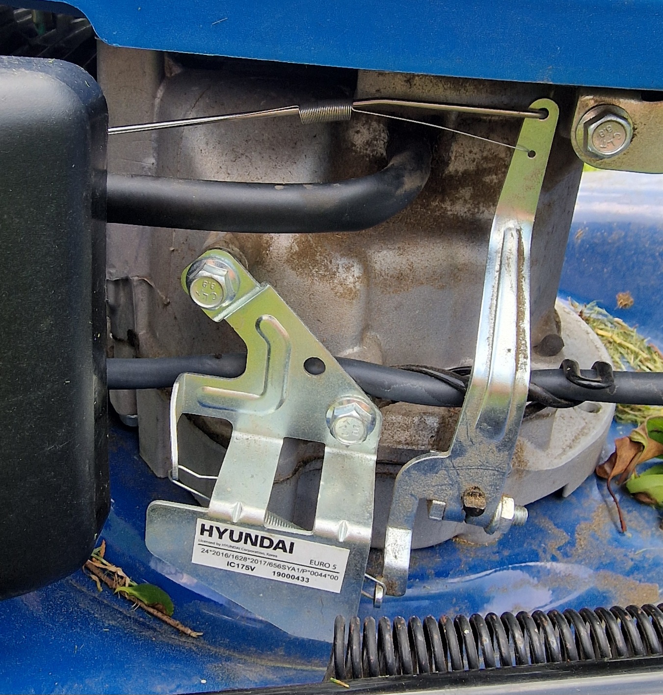

Where are the governor weights? The link , spring and the bit at the bottom are moving freely back and forth. Could the spring have lost tension?
'The bit at the bottom', probably. The weights are flung out, under centrifugal force, which then closes throttle. The surging, and the video suggests that there is an issue of sticking governor.
Is that nut at the bottom left of your photo done up tightly to prevent the mechanism from moving on the shaft?
