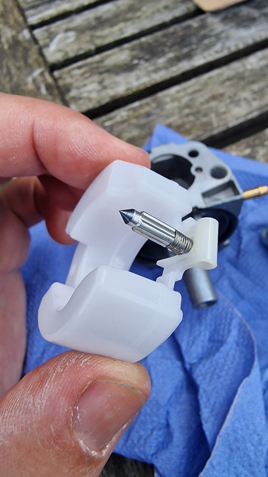

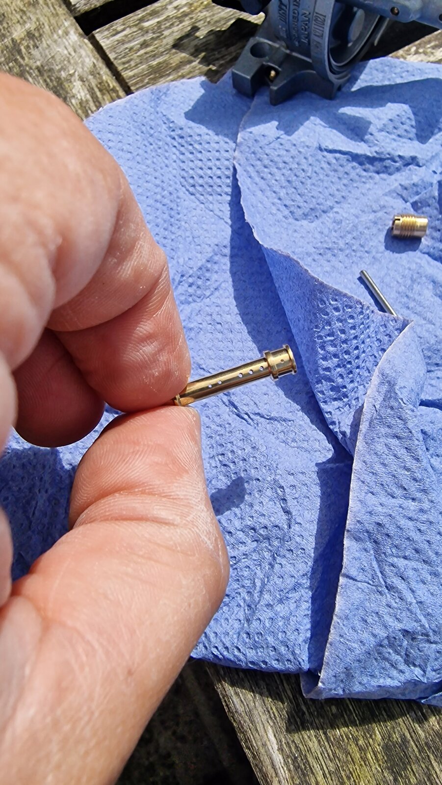

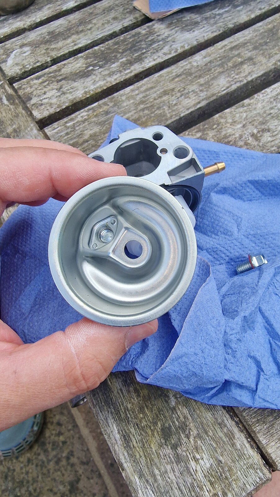

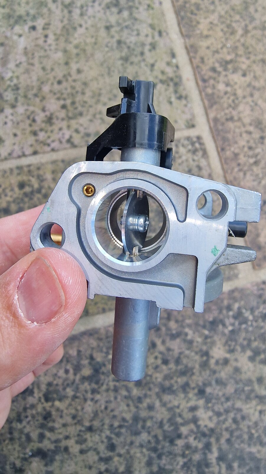

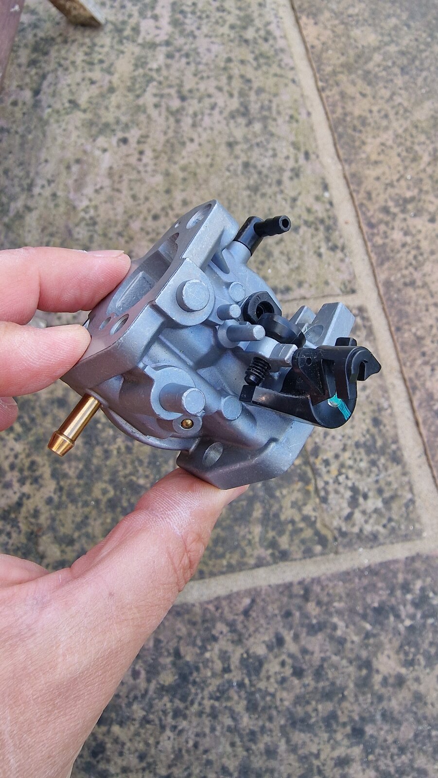

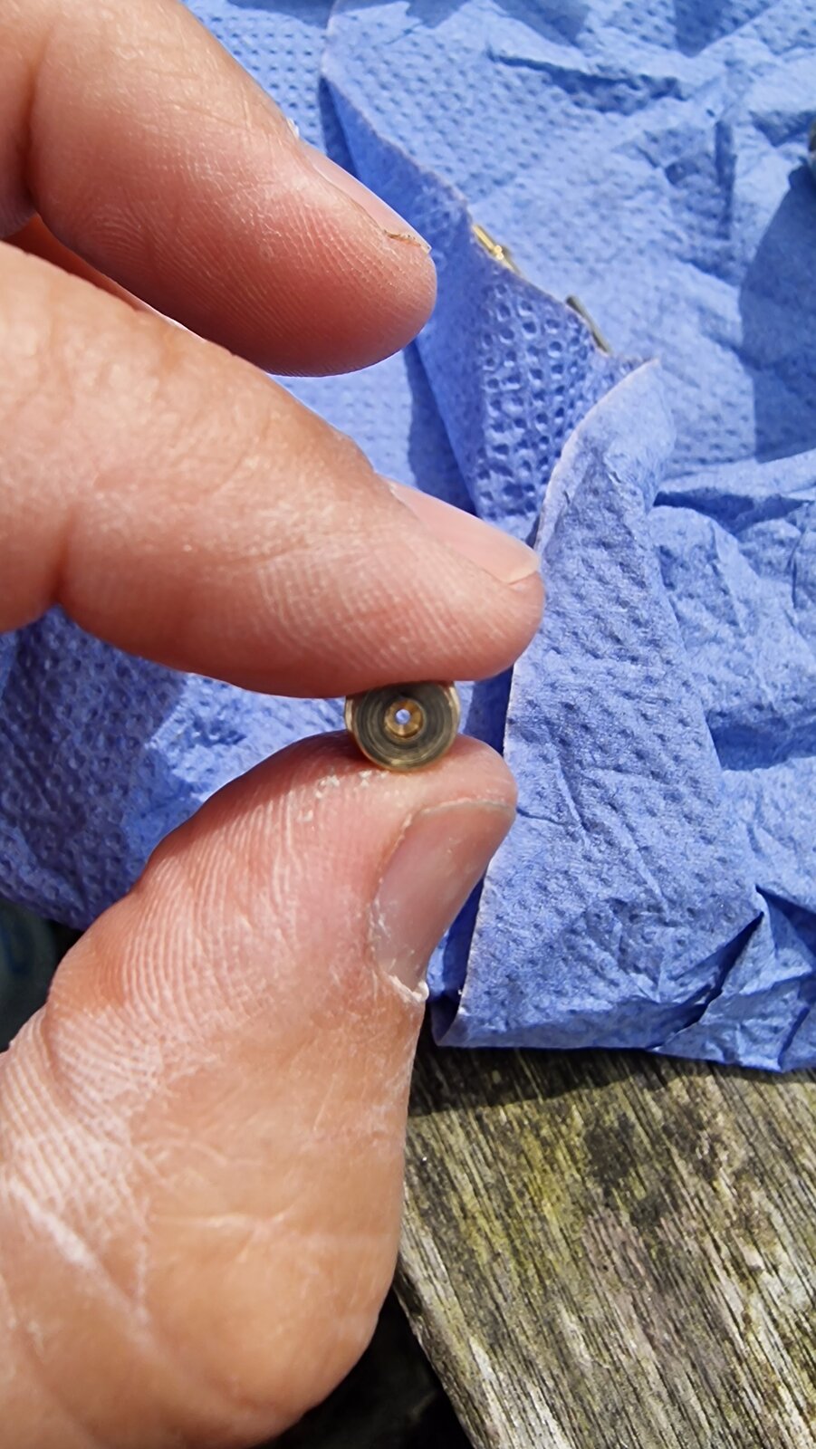

The saga continues
More parts bought and it still continues, although surges a bit faster. I've changed the fuel hose, all the gaskets (3 more between carb and engine), and new spark plug even though last was not that old.
I did your test and it still stalls with idle screw all the way out. I've attached pictures of the carb. I've already made the fuel jet hole a little larger. Any more suggestions would be great.

Possibly, I did what many online have said to do. Maybe I unknowingly fixed the issue but caused another. Before I enlarged the hole it was surging. Same as previous carb.
Still seams not enough fuel is getting into the carb as even when warm I have to prime it to restart it.
There isn't actually an idle mixture screw so can you see the black plastic rectangle below where the idle screw was? Thats the idle jet so prise it out for a clean.

Oh, I thought that is the black screw over the idle jet. I'll do as you suggest.
Once you've prised out the jet you'll see drillings that go to the outside of the carb(small separate hole alongside the main venturi) and the opposite way to a tiny hole in the carb body.
These need to be perfectly clear.
John
Still no progress and I'm about to admit defeat and buy new.
It couldn't be anything to do with combustion could it? Am I right in saying that the combustion sucks more fuel out of the tank, so maybe it's not sucking enough? Could I spray carb cleaner into the manifold (if that's what it's called. The hole from the carb into the engine).
When the engine is running, fuel is sucked from the carburettor float chamber, not the fuel tank.
The float chamber is refilled from the tank, and regulated by the needle valve which in itself is controlled by the white plastic float.
Nothing needs to be adjusted, drilled or bent.....this will come back to haunt.
When the engine surges, it is short on fuel. As the revs drop, the governor opens the throttle to compensate so the revs go up and down.
