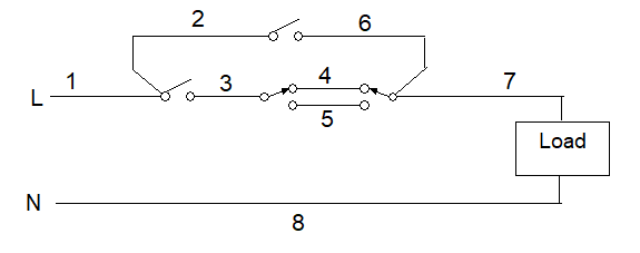

I think we're in danger of trying to categorise all horses as either "true white" or "true black" - while in reality they are rare (true white) or uncommon (true black), and most horses are various shades/patterns of other colours.
Now, if I throw in a wiring diagram :
EDIT: It's a mix of old and new colours with fixed wiring of various ages.
I assume that at least some of you will argue, black and white, no room for debate, that circuits 1, 2, 3, and 4 are all "power" circuits" and not one of them is a "control" circuit ? Personally, I would argue that all 4 of them are control circuits because they form the control system (with the timer and three stats as control elements) for the pump and boiler.
We get into a deep philosophical debate as to where the dividing line is between a functional switch and a control system - I don't believe there is a line, just a very large grey area. I believe that a light switch is a control system, albeit the simplest one possible, to one or more lights - and therefore the switched line for the light could be considered to be a "control" circuit. OK, that is rather pushing things :whistle:
In the above diagram, I am confident to call that a control system and class the internal connections as control circuits - allowing the smaller minimum wire sizes (0.5mm² vs 1mm² for lighting or 1.5mm² for power, table 52.3) and the use of alternative wire colours (table 51).
I think the problem may be in relation to the sense in which the word "circuit" is being used.
My view is that wiring which connects a power source to a load through one or more switches ('switching devices') is "a circuit" - and that the remains true whether that/those switches are manual ones, timeswitches, thermostats or anything else. The example you give is slightly complicated by the fact that there are two loads but if one forgets the pump then I would say that what you call 1, 2, 3 and 4 are all parts of one circuit (not four circuits) - which is simply a load supplied with power via four 'switching devices'.
Hence, contrary to what you suggest, I would not say that 1, 2, 3 & 4 were 'power circuits' (nor 'control circuits') - I would say that they were all parts of one circuit, which consisted of a load being supplied with power via a string of switching devices in series.
I suppose a clue is in the word - to my mind, a 'circuit' goes from L of the supply, via one or more switching devices then through the load and finally back to N of the supply.

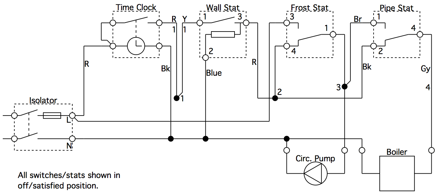

I'm accustomed to working with control panels containing many 'circuits' and each one of them is classed as 'control', the 'electricians' circuit will finish at the main isolator.
So yes an immersion heater on some sort of programming device, be it a time clock - thermostat - electronic controller - or a switch in the matrons office will be described as a control circuit. However domestically I'd probably only consider the link between the thermostat and element to be the controlled circuit and totally ignore the title.
Domestically I would only consider refering to control circuits for the more conplex arrangements, heating being the most obvious but with the amount of home automation now in use of the title is firmly expanding.
Within the rules of 'control' this fully acceptable to be installed this way and is within the rules of MI's
I'm on your side but would consider it to be '2 control circuits' max as there are only 2 devices being controlled. Realistically I'd be happy to call it one circuit with 4 controlling devices.
again I'm with you but would place the demarkation (if there is one) at the isolator or the input to the time clock.

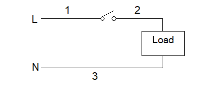

We can agree that 1 is "Line/Live" and that 3 is "Neutral". One can (and we do) call 2 a "Switched Line/Live" but, beyond that, I see no purpose on thinking of it as being different from any other part of the circuit. When things become more complicated ...
... I wonder which of the numbered items you would like to call "control <whatevers>", even if we could think of a suitable word? By analogy with the simple suggestion, I suspect that you would like to call everything other than 1 and 8 as "control <whatevers>" - is that the case and, if so what purpose does that serve.

I think you're trying to over analyse John. As said earlier strictly speaking the immersion circuit a power circuit which contains a control device or two, now if if the clock and thermostat operated a contactor (a fairly regular format in a controls environment) there would be no difficulty in distinguishing between control and power, especially if they have their own feed and OCD, but in the absense of the contactor the lines are very blurred. In domestics I would tend to not describe this as a control circuit even though it still contains 2 (or 3 if you count the isolater) control devices.
In your circuit above I'd describe all of the 'live' wiring as the control and as there's naff all left I'd include the load too.

In John's example, conductors 3-7 are definitely part of the control system. 2 is a bit more of a grey area. But if there were an isolator to the left of 1&8 then I'd include them too.

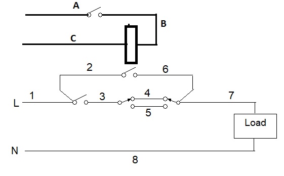

All those circuits are power circuits. They carry power.
The power in those circuits is CONTROLLED by the settings of the various switches.
If the switch between 2 and 6 was a set of contacts on a relay then
circuits A B and C would be control circuits.
Simple rule, Any part of the system that is or by switching can be connected to the load is a power circuit,

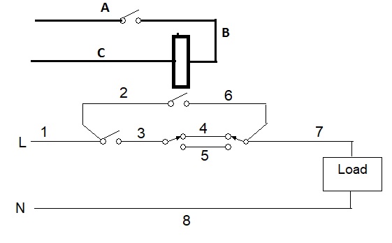

upload_2019-8-11_2-32-52-png.169258
If the load was replaced by a CONTRACTOR and it powered the load then I could agree.
But even then it would still come under the jurisdiction of the controls engineer.
