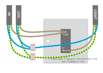

I've always looped at the ceiling but was recently replacing a switch where the loop was done at the switch. In this configuration, is the cable in L1 known as the "Switch Live" and should it therefore have a brown/blue sleeve to denote this like we do when looping at the ceiling?
This is the actual question.
Jupiter, when you loop at the rose the blue conductor in the cable linking the rose to the switch is not acting as a neutral conductor and The brown sleeve shows this. When you loop at the switch, as in flameport’s picture, all the blue conductors are neutrals so sleeving is unnecessary.

It’s the OP here again :)
Thanks for all the responses. Can’t claim to have understood everything but here’s my summary.
When looping at switch, the brown wire in L1 is the switched live and since it is brown, it doesn’t require (regs) any additional identification.
That said, some may want to use their personal identification method for their own convenience. Yellow was being suggested and in the same vain brown over sleeving can be used as I suggested? May not be very clear as it’s brown on brown but clearly the oversleeving would be much smaller. Blue over sleeving cannot be used as it suggests that this is neutral.
As suggested by these “personal” methods, there is a risk of incorrect identification and hence, should always test the wires if working on a unknown system.
Any major omissions with the above?
