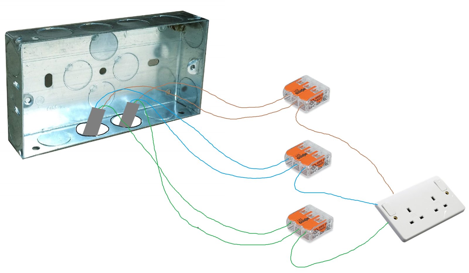

Looking at that lot, I think I need a deeper back box.
Those Wago 221 series are really tiny(slimmer than terminal blocks). I'd hazard a guess they were invented for going in back boxes, because the older 222 series are a bit clunky.
Show us a picture of what depth and wire slack you've got to play with?
Many thanks once more.
The following may not make sense, but I'll give it a go.
The MK socket that I originally tried to fit had terminal screws which were angled slightly inwards towards the front of the plate, and given the shortness of the cables this made it tricky to find the angle to get sufficient purchase on the screws in order to fix the wires. The neutral in particular simply wouldn't stay fixed in the terminal. The cheaper sockets that I've bought recently to replace other converters have terminal screws which are parallel with the socket plate, and even given the shortness of the wires, they are much easier to access with the screwdrivers that I possess.
If I still can't secure all the wires properly after trying a different socket, I'll look at the terminal block solution that you and others recommend and I'll also post pictures.
