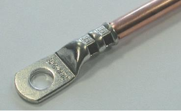

Are you aware of any types of solid copper conductors which DNOs crimp?
Ones they have to bolt to terminals -
You will note the difference from the earlier picture.
https://www.powerandcables.com/copper-cable-lugs-for-special-applications/
Scroll down.
Interesting. I also note ...
A hexagonal indent crimping is being recommended – again it has to be observed that both cable lugs and crimping tools come from the same manufacturer. ... Cable lugs for solid conductors can be recognized by their smaller tube diameter and the marking “E”. For example: KL 10 50 E.
... so, if I read that correctly, a 'special' type of crimp, and a 'special' crimping process, for solid conductors?
Kind Regards, John
Yes, E type - electrolytic tin plated copper - whatever benefit that produces, and, more importantly importantly I would think, crimps that 'fit' the conductor.

That link seems to be indicating the desirability of 'indent' crimping (rather than simple 'squashing'), and I wonder if that is practical with the small solid conductors 'we' normally deal with? (they say that the smallest crimp for solid conductors is 'usually' 6mm²).
