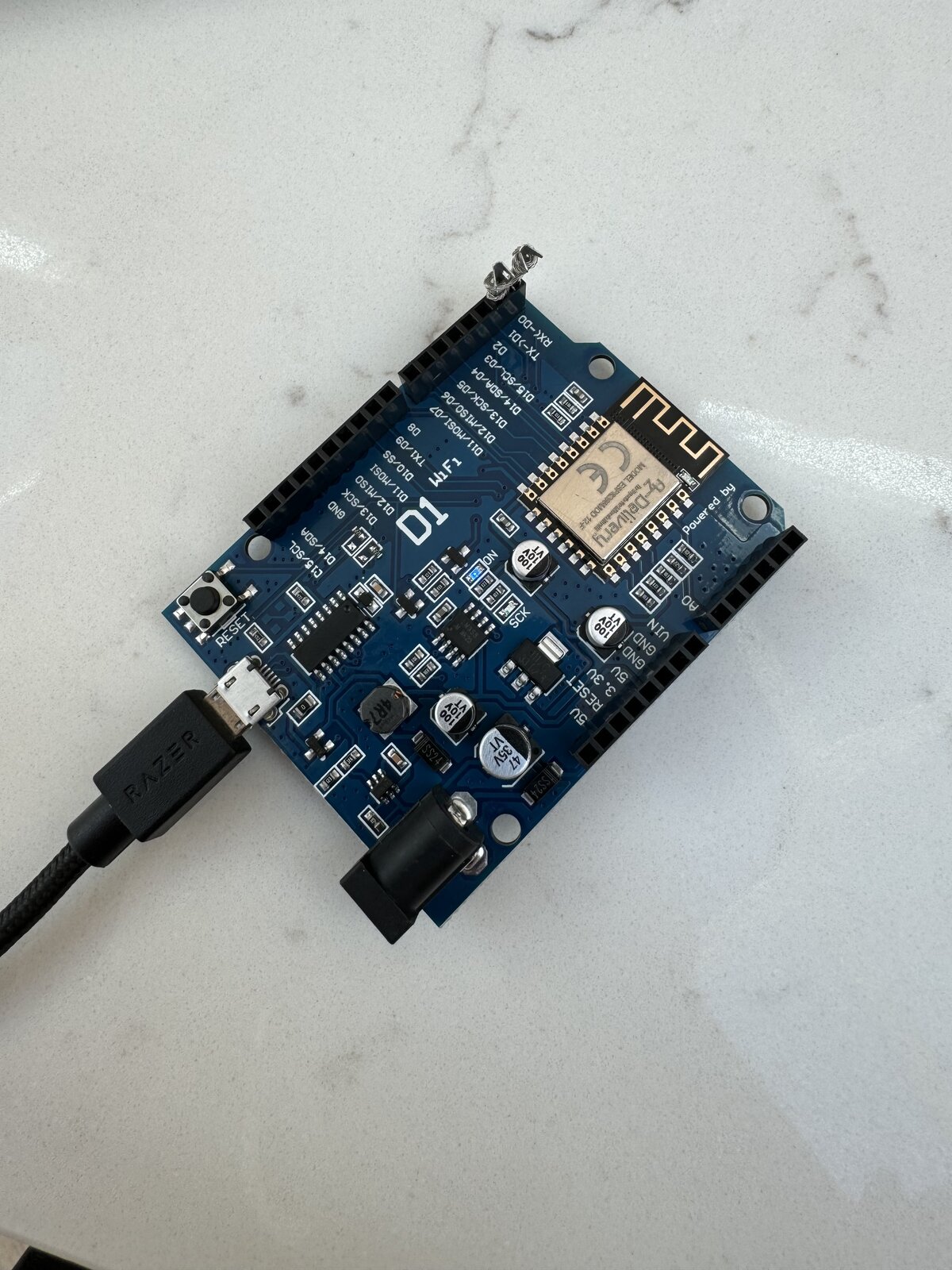

Had another play around with my ESP8266 modules earlier and had them talking to each other and also a RPi through PuTTY with and without the level convertor with no problems at all.
Still puzzled, I came across a post online that basically said:
"The problem with the Rx pin on D1 Mini is that it is connected to the USB/UART converter chip.
So you would hope it is high impedance and can easily be driven - but you are really seeing the impedance of the USB chip output pin.
A real WEMOS D1 mini has a 500 ohm resistor in series so you can overdrive that output, but many of the clones omit this series resistor, making the Rx pin unusable."
So success after some more testing...
I separated the RX and TX lines to see if it was one or the other that was causing the issue on the ESP modules.
I set up the panel so that so that the ESP module was sending data to the panel and the Pi was receiving from the panel and everything worked!
When I send data to the panel from the Pi and try to receive data from the panel through the ESP module nothing is detected.

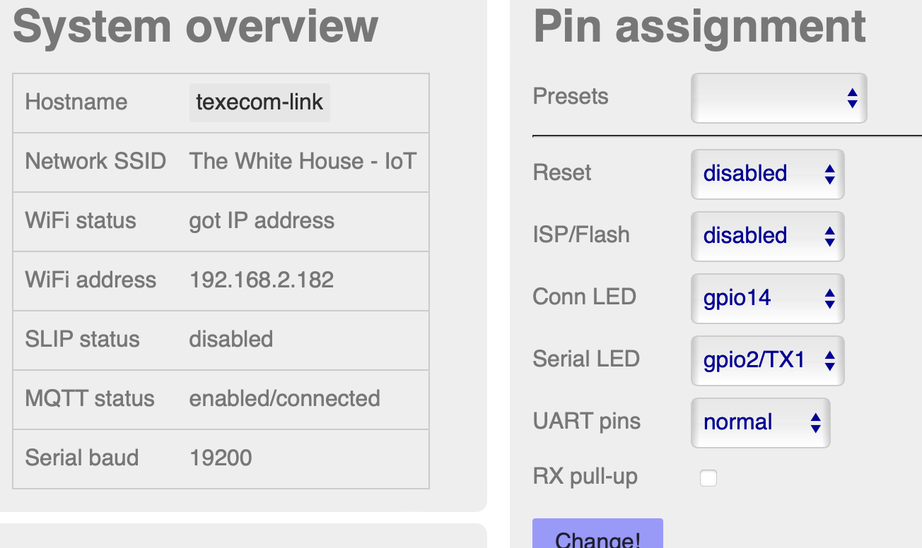

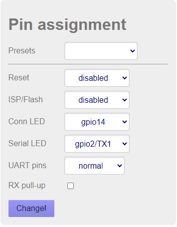

Fortunately, in ESP-Link you can swap the TXD & RXD pins to GPIO 13 & 15 (written on the back of the PCB) and as soon as I did this and set the baud rates up everything worked perfectly and actually quicker than the Pi!!!
I have fully tested this using Wintex & Crestron and it works - in fact you can leave the COM3 setting on Crestron all the time and it works on both. Wintex when connected and then defaults back to Crestron :giggle:
I suspect you can do the same in ESP Home?
There are a couple of caveats:
1 - The level convertor must still be used because the D1 3.3v TX voltage level is simply not high enough for the panel to read properly. The D1 RX from the panel is OK but you may as well use both channels in the level convertor as a failsafe.
2 - When GPIO15 is pulled high (by being connected to the panel) the D1 will not boot and therefore must be unplugged briefly at power on. This will not really be an issue because it will run off the panel and be powered all the time so should never need to reboot but it could be an annoyance. There is probably a work around for this.

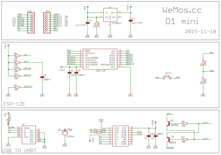

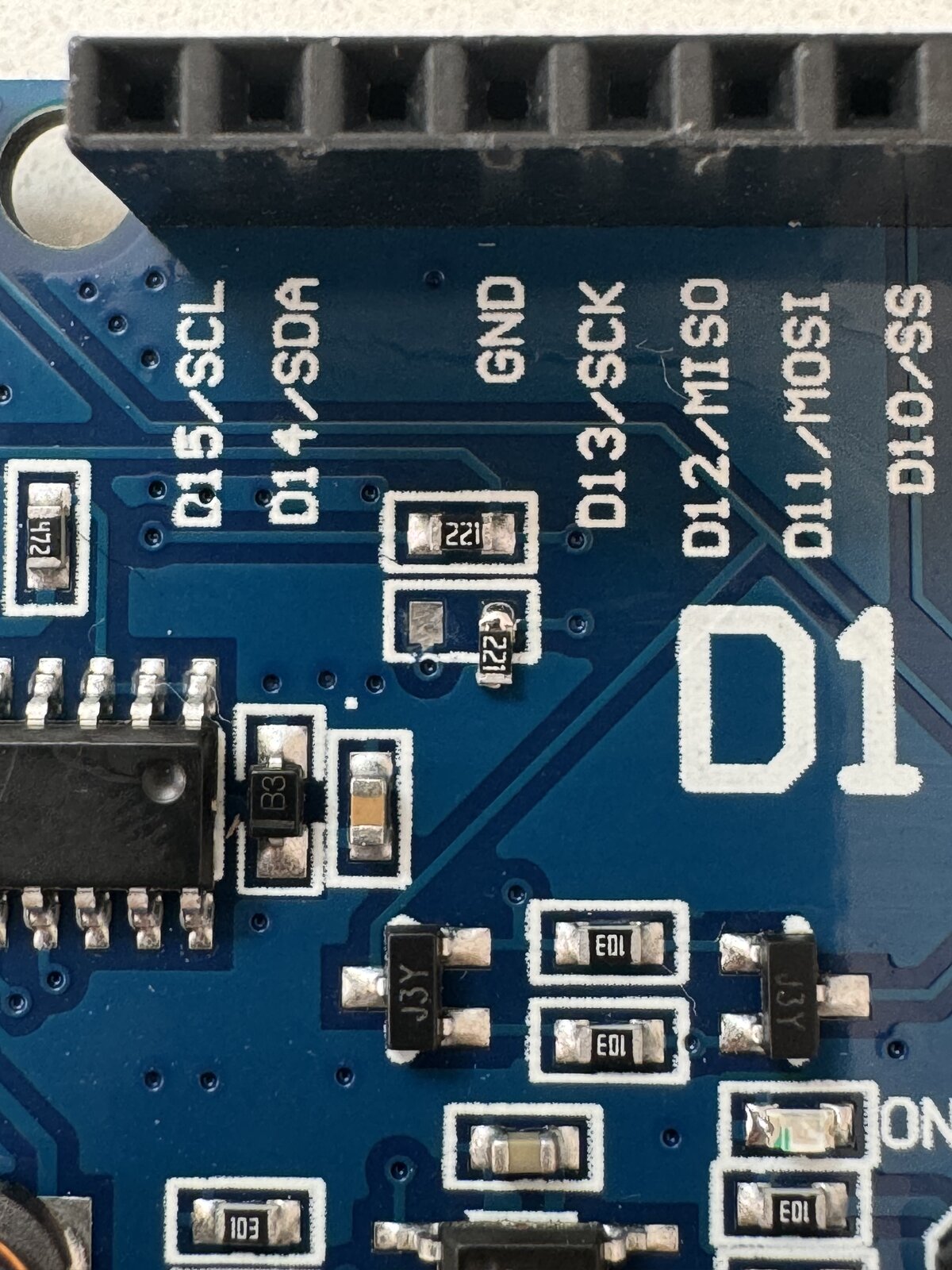

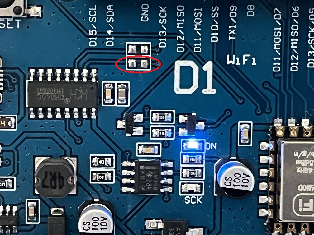

After looking at the circuit diagram, I have found a way to make the normal RX pin useable and it involves removing a resistor. Basically this disconnects the USB chip from the RX input and means that the ESP8266 on the D1 works!
BUT you need to make sure you have written the software to the ESP8266 first otherwise you can no longer write to it unless you replace the resistor!!!

And then unplug it and remove the resistor:
This is the circuit diagram:
and this is the position on the board of the 470 ohm resistors, you only need to remove the RX one circled but I removed both.
Once you have done this, connect up to the panel via the level convertor the same as you did for the RPi with 3.3v to the LV and 5v to the HV and providing your panel COM3 is still set to Crestron you can telnet through PuTTy to the IP on port 23 and enter Crestron commands or you can connect using Wintex, again to the IP on port 23 and play all day.

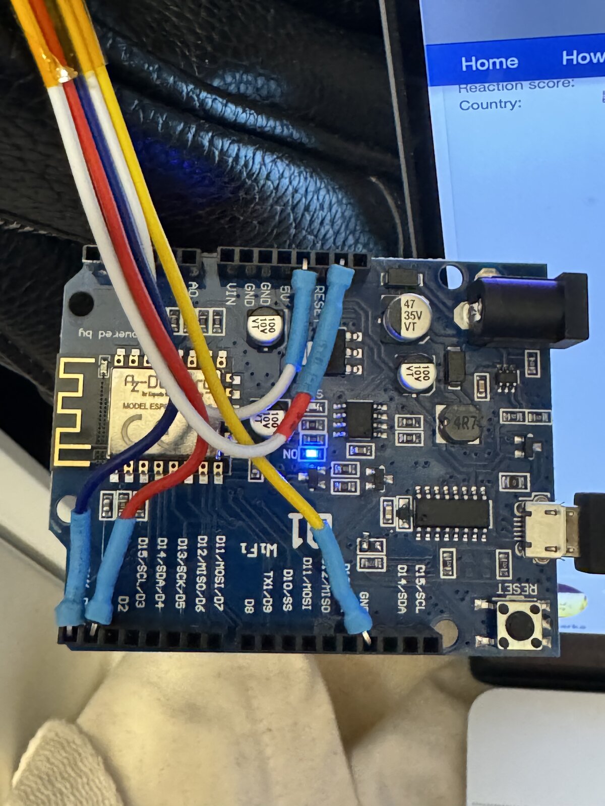

so ive flashed ESPlink, setup as you've done and it connects to my wifi, removed the resistor (well left it half attached). Connected via 12v everything boots but I can't send any commands. Checked wintex Is set as port 23 and the esp link IP
Can you send a photo of how you've connected it to your ESP please?

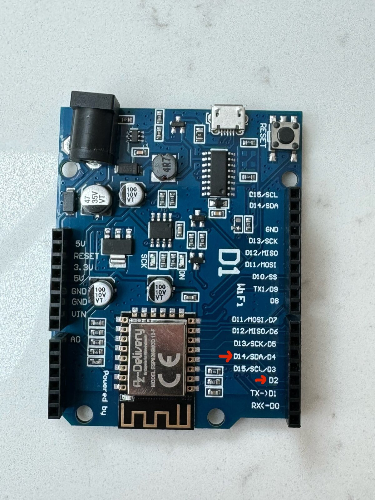

To confirm, your using GPIO D2 and GPIO14 as your pins as marked?

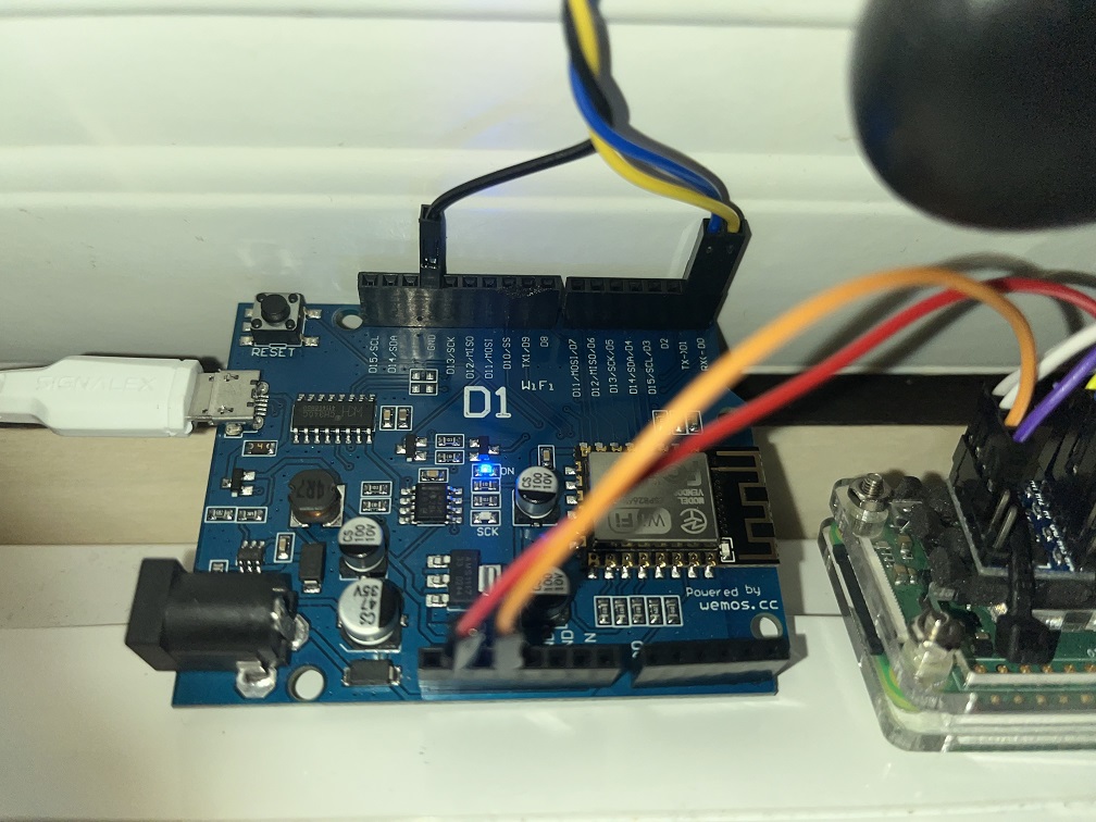

Your wiring all looks OK but you need to move the blue and red TX/RX leads to D0 & D1 as per this picture and it should work:
You'll see I am powering my board over USB at the moment and I have left my LLC cable tied to my Pi but it is running totally from the D1.
I see that your board has 220 ohm resistors where mine has 470ohm but they were probably cheaper at the time!

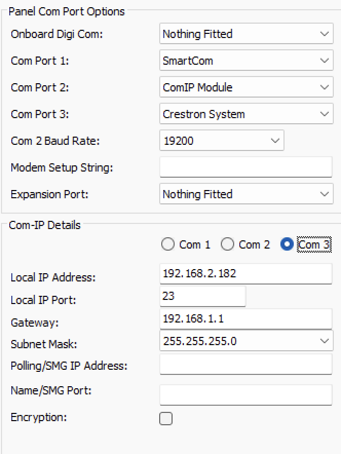

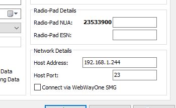

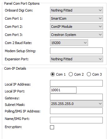

I would also remove the Com-IP details you have put in Wintex because it serves no purpose and may conflict:
This is the important part to put the IP and port info:
hmmm done exactly as you have, still doesn't connect.
Ive also completely redone fresh with a new LLC and all new terminals. No commands being sent.
I thought first if I move the 5v around to lower down as I (thought) the 5v on the top side was for input and your LLC is powered via the Pi / something else. but still nothing.
Should I remove both resistors to see if thats it? (Also conscious you reference a d1 mini wiring diagram but this is a D1 R2)
Where did you get your ESP, as mine was from Amazon so a cheaper clone, lost for ideas :( (tried switching TX/RX too)
You could remove the other resistor and try - it should not matter but it would isolate the TX line from the USB chip as well.
Try swapping the RX and TX leads because it is easy to mix them up!

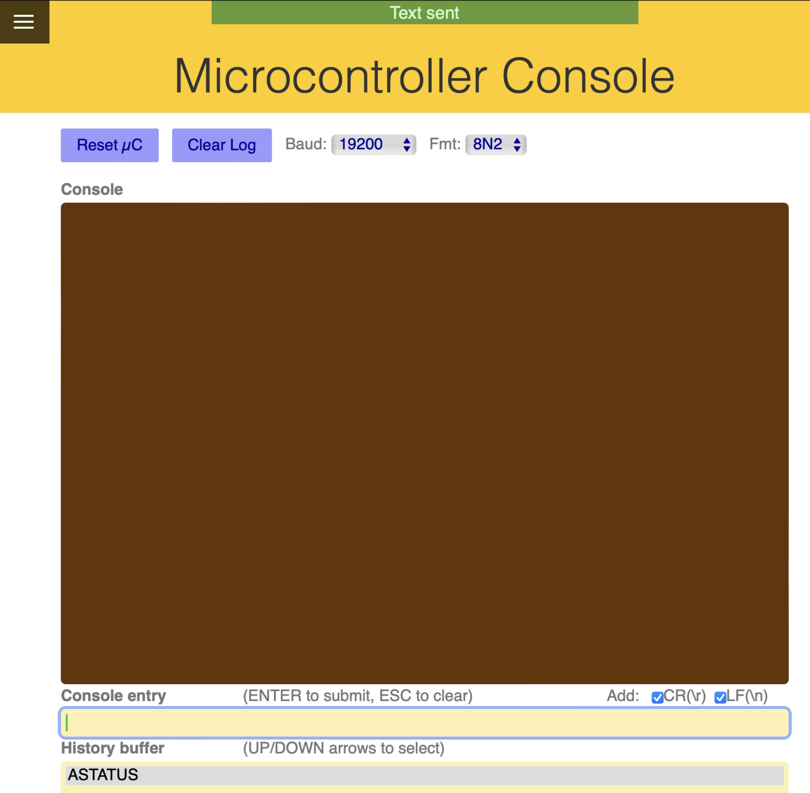

LEDs wise, I have the ON led also list and occasionally a flashing SCK led, the ESP itself flashes whenever I try to send a command so looks good.

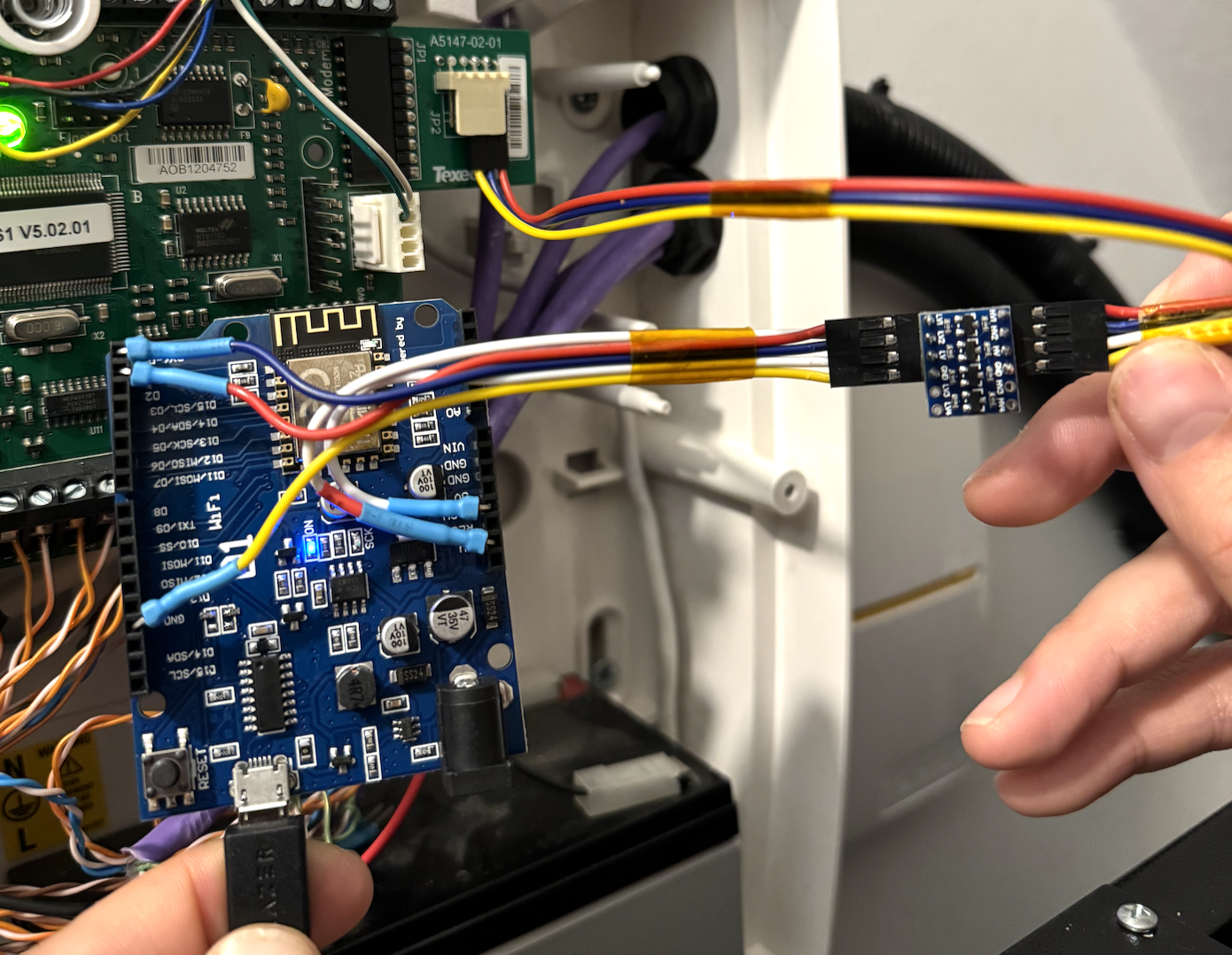

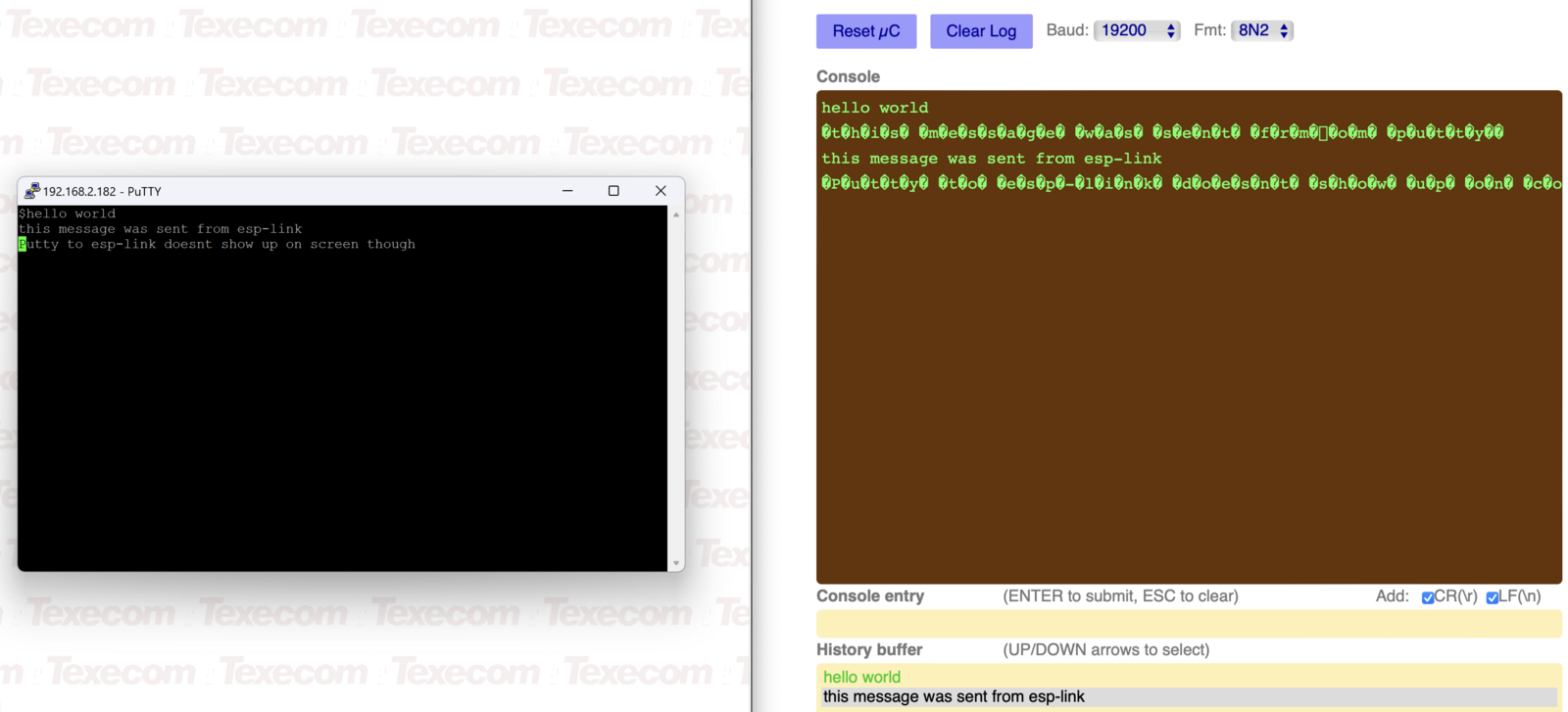

If I connect both the TX and RX pins together and connect via putty I can see the commands being sent and received (see screenshot). Though strange symbols show up if I send via putty (and view in esp-link you can see the text characters between the symbols)
I guess this suggests then the texecom panel is playing up? Ive checked everything and all looks good :(
I wonder if ive fried anything from playing around :(
MAJOR EDIT!

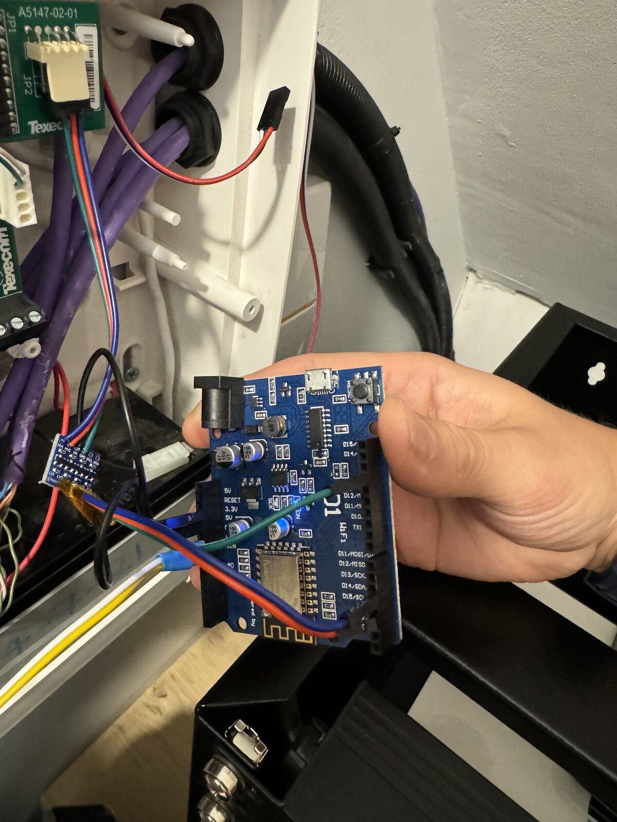

its the LLC, no matter how many different 4channel LLCs I use they don't work, the second I use a different 8 channel one everything works!!!
It is unlikely you have damaged the panel unless you have connected more than 5v directly to the TX/RX pins.
The reason there is the strange spacing is probably because of the parity/spacing settings but don't worry about that atm, so let me get this right, just using putty, with the TX & RX connected, if you type something it is echoed back on screen yes? and if you disconnect TX & RX this does not happen yes?
If so then the wiring and software seems to be working...

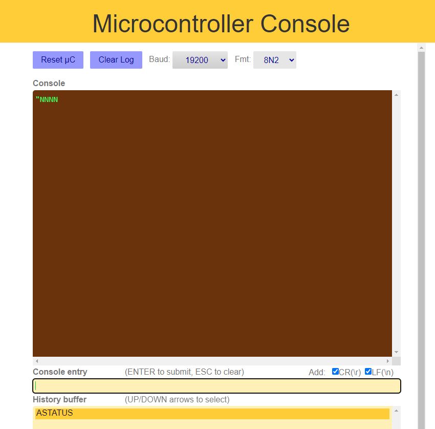

From this picture, you have the TX and RX round the wrong way at the panel, the red and blue wire need to be swapped around - I have just double checked mine.

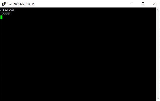

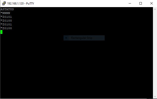

Once you have swapped the TX/RX pins telnet in to putty IP & port 23 and type ASTATUS and you should get this response:
You can also try changing to 8N1 on the ESP microcontroller screen to see if it helps?
In fact you don't have to type any commands at all, as long as Crestron is setup on COM3, as soon as an event is triggered, the panel will push a response to putty:
